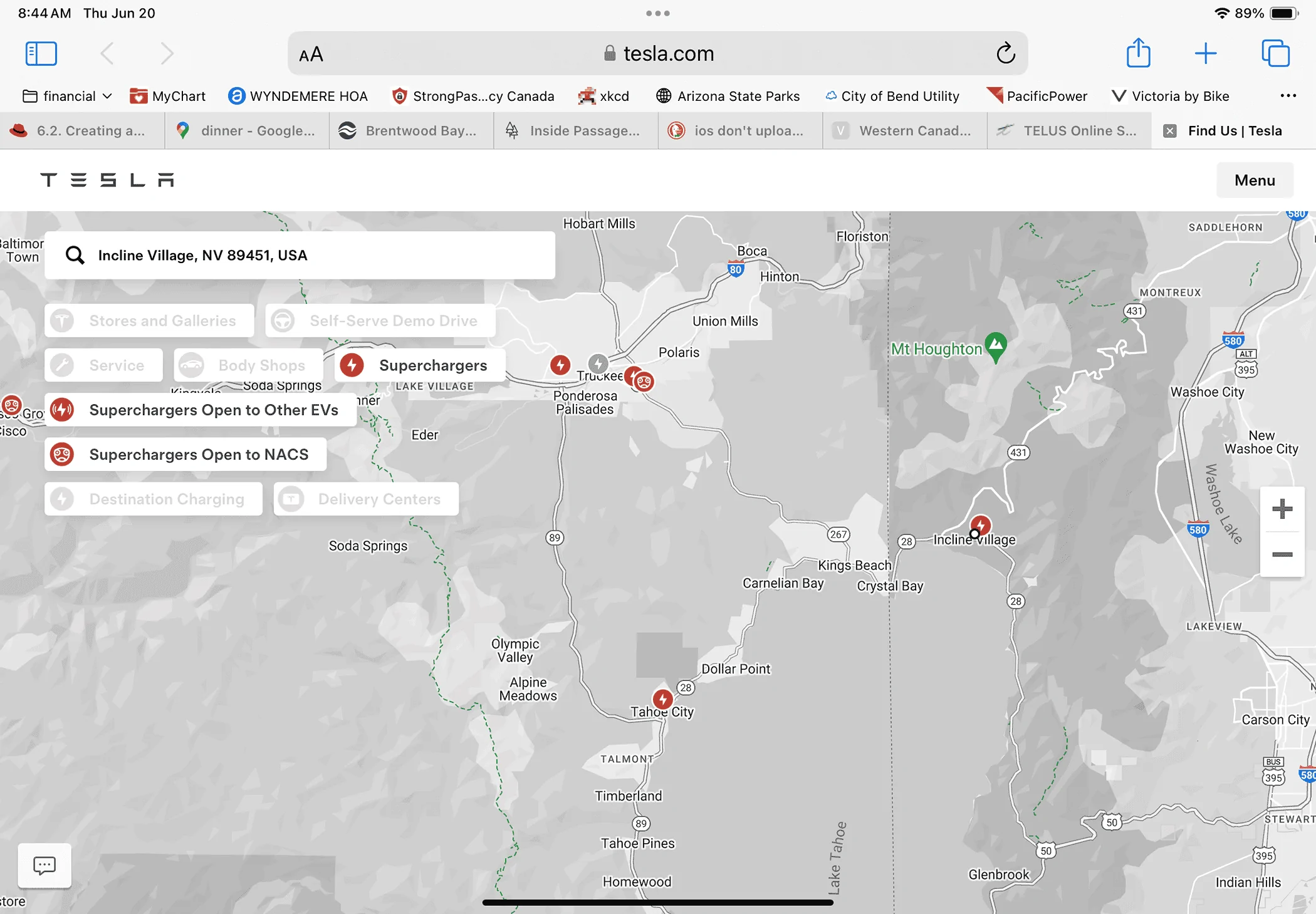

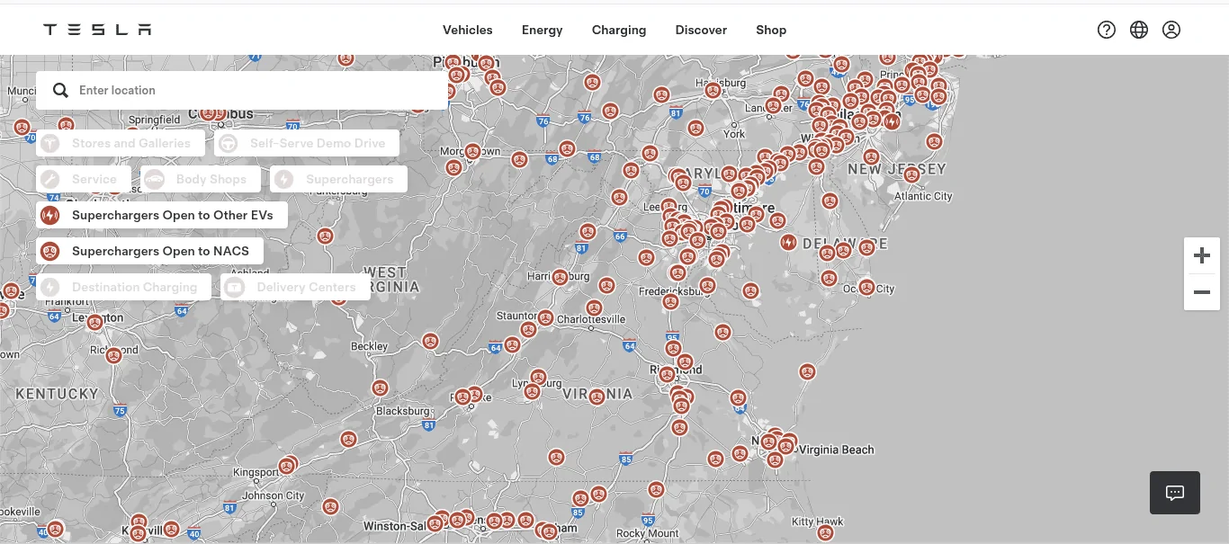

https://Tesla.com/findus
Deselect all options except for Chargers open to NACS and chargers open to other EVs. This will give you adapter compatible chargers as well as magic dock locations.

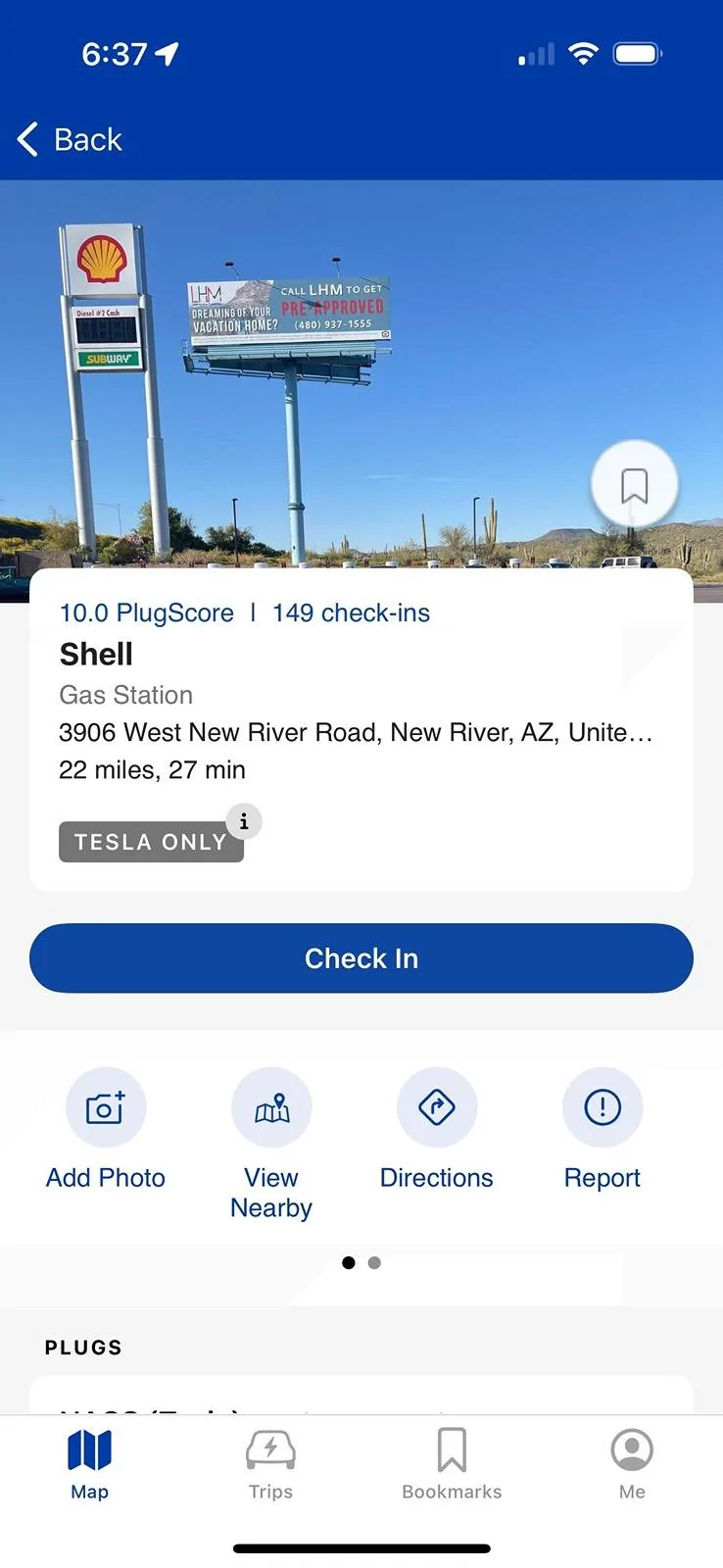

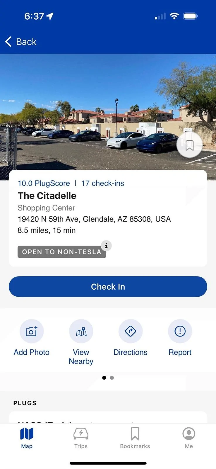

There are four versions of Superchargers (plus then we have destination and L1 chargers). We can use V3/V4, but not the earlier ones. Unfortunately PlugShare won't filter out the old ones, you have to look at each one directly to see if it's Tesla-only. The car nav and Rivian app filter them perfectly for me however.
