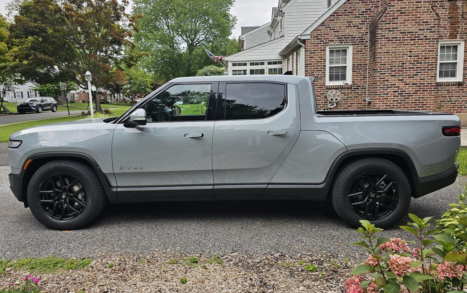

Edited to add driving impressions (below photo).
My local shop completed the tire work on my R1T today. The only very minor glitch was that the shop said that the factory lug nuts would not fit the Type 52 wheels, so they used the ones supplied by TR with the wheels. The sole practical implication is that since I have a factory spare, I need to keep a set of OEM lug nuts in the car, and of course the 22mm deep socket that fits the MSW lug nuts.
I probably should have had the shop mount the Generals on the stock Rivian rims, since those tires will be on the truck 75% of the time, but the MSW wheels are not unattractive.
Rivian R1T R1S New MSW Type 52 Wheels in Gloss Black 20240718_170819
Yesterday was the first time I had a chance to drive any significant distance on the HTS-60's, a mix of a few highway miles combined with several on suburban roads. The new tires are significantly quieter than the Scorpions, something that is very welcome. I had the R1T in Sport mode and firm; even so my impression was that the Generals gave a more comfortable ride.
I did not have a chance to do too much backroad driving, but the little that I did seems to indicate that handling and road feel are not as good as with the Pirellis. Given the more plush ride, which likely means that the Generals have more complaint sidewalls, the loss of handling capability is unsurprising. Let me add that I did not feel that the Generals handled poorly, only that IMO, they were less crisp than the Pirellis.
