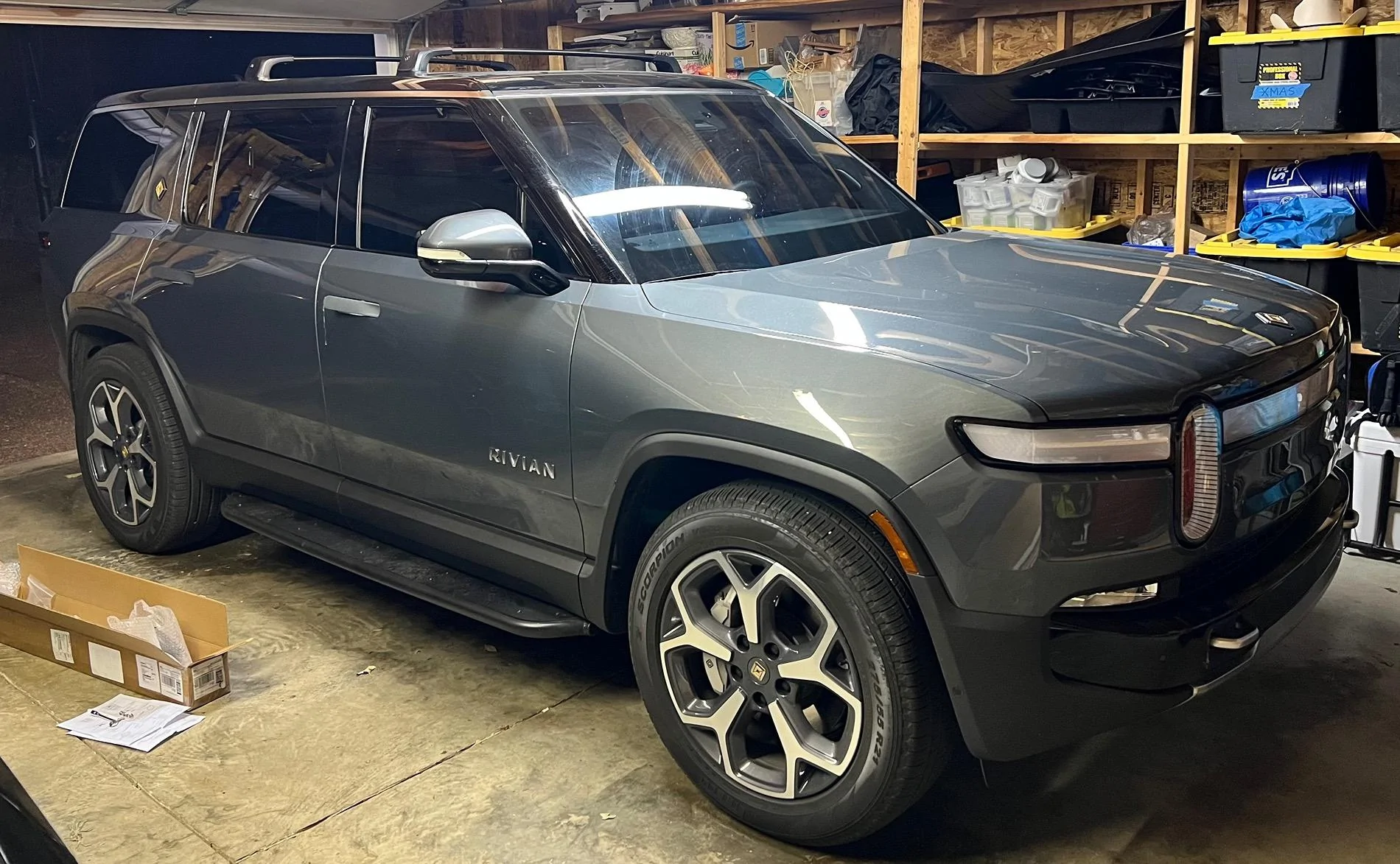

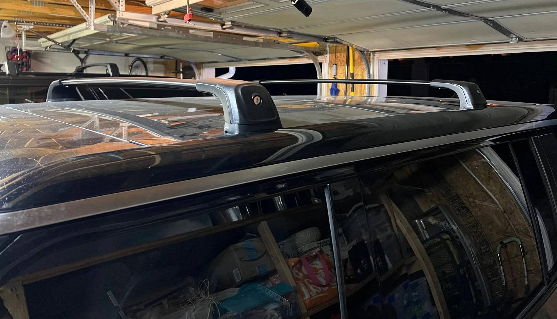

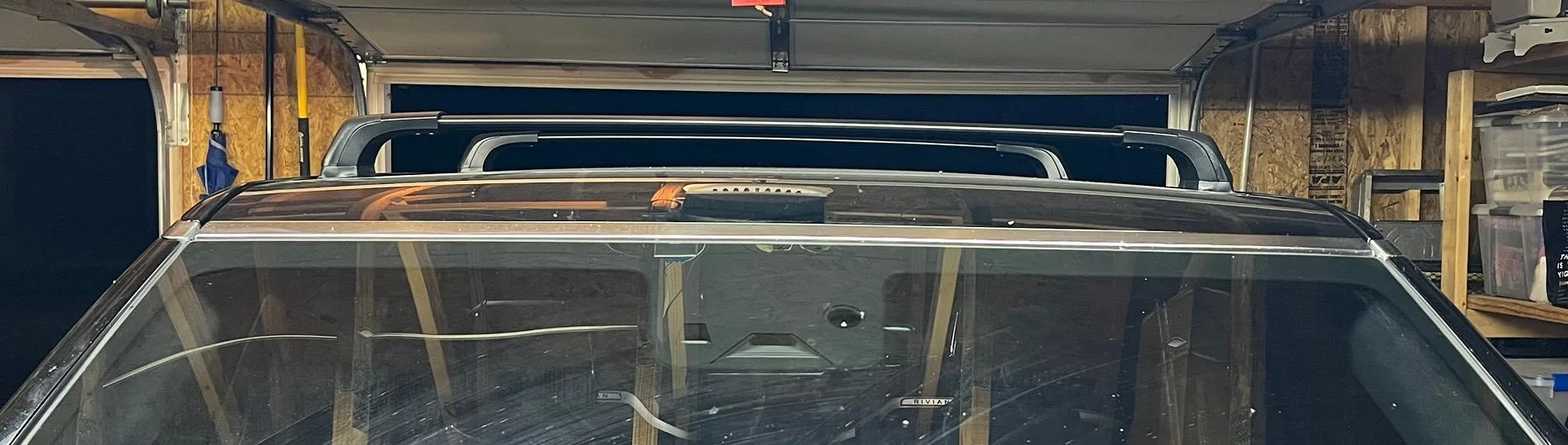

Just finished install. Took my time and was about 30-45 minutes total. Other than the keyholes on the ends I like the look. Might have to paint those black.
Haven’t driven yet so no report on wind noise. No gaps in the bars so hoping it’s minimal.
Pics for reference

Very nice. Do you think they will fit on the rearmost slot as well?

No freeway driving yet but got her up to 60 MPH this AM with NO whistling :clap:

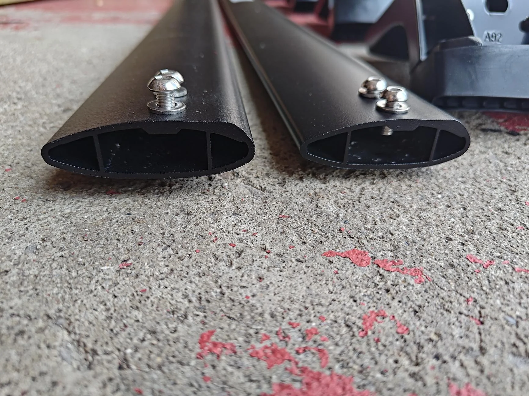

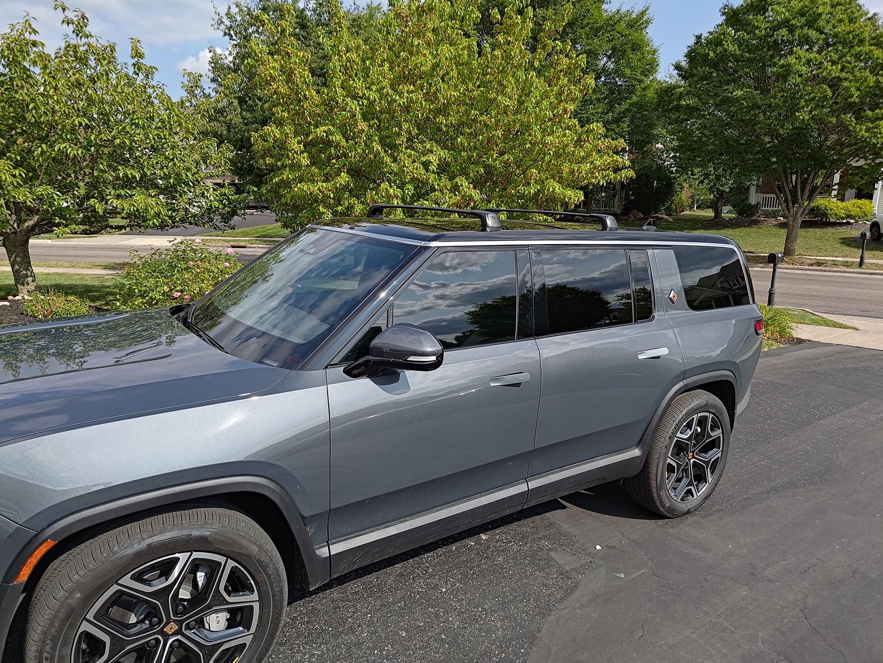

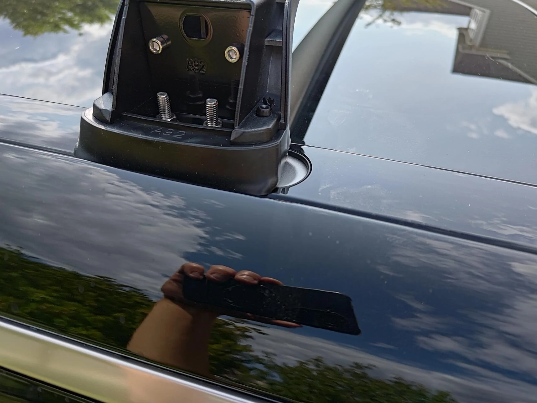

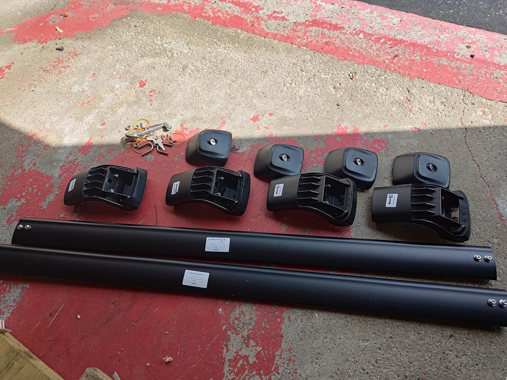

My Install Experience:
I proceeded with reckless abandonment and did not take my time. It took 39 minutes from unboxing to final locking.
Couple things to mention;
  1. There is zero branding on the instructions or the mounts themselves. I have no doubt the EVbase and the alternate Amazon ones that @Riv E In installed are the same exact product.
  2. There is an airplane wing shape/direction to install these and the post mounts will match the bars accordingly.
  3. The front mount and rear mount horizontal bars are different lengths. The rear bar is way too short to fit in the front roof mount points and the front bar is way too long to use in the very rear mount points. The front bar *might* fit the middle but it wasn't looking good for the angle of the ubolts. So if you want 3 of these, you'll need to get a second set and use the rear crossbar for the rearmost mount point.
  4. Cool feature, you can't leave the keys in the locks when in the unlocked position. This presumably would prevent you from driving away with the bars unlocked. Kinda cool.
Going to go test the wind noise right now. My reference are the Whispbars that I run on my Model S with 3D printing inserts to cover up the inside gap. Otherwise known as "the most expensive roof crossbars ever".
Rivian R1T R1S New Black Crossbars from Rivian P_20240821_160454
Rivian R1T R1S New Black Crossbars from Rivian P_20240821_160503
Rivian R1T R1S New Black Crossbars from Rivian P_20240821_163924
Rivian R1T R1S New Black Crossbars from Rivian P_20240821_164100
