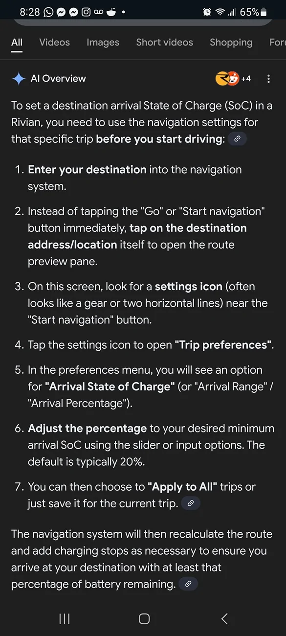

Navigation gives you the option to set desired state of arrival charge in the trip settings both in the app, and in vehicle when setting a destination. You can adjust it to either be a one time arrival SOC, or a default that will always aim to get you to a charger within that desired level.

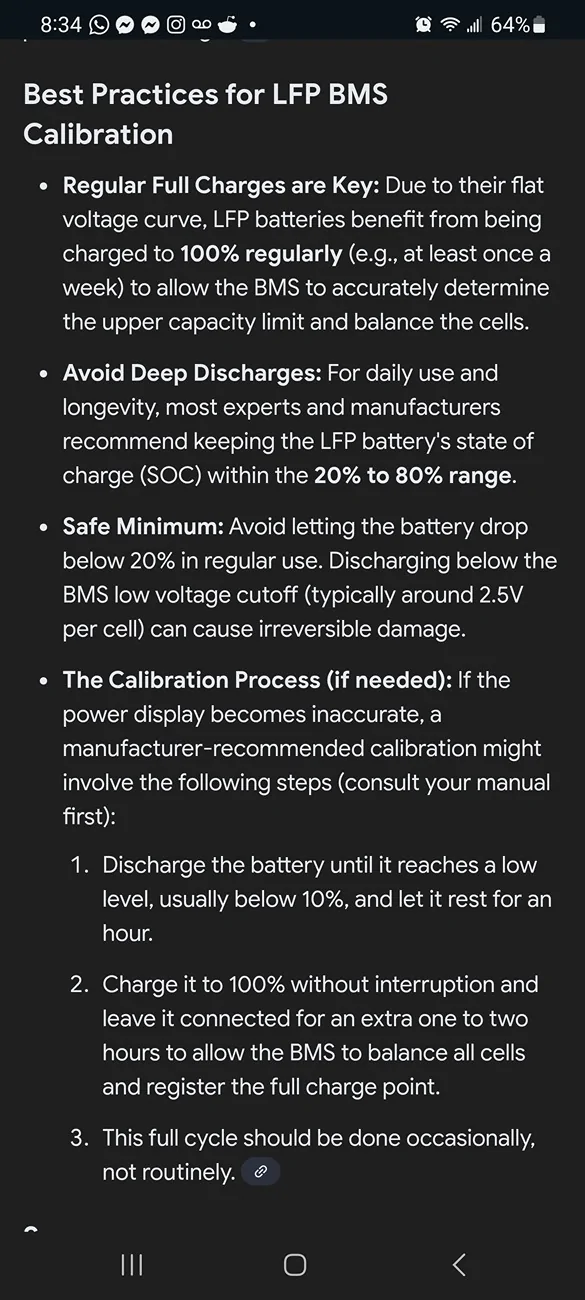

But, as stated above, LFP has a very minimal voltage difference from empty to full, so it's difficult for most BMS systems to fully calibrate to those minute changes and differentiate say 50% from 40% capacity, hence the need to fully charge it periodically. I'm going to rely on gemini to summarize this up again, but it makes sense to me
As I said in my original post (but didn't repeat in my later reply to Dark FX), the nav lets you set the desired SOC at the destination, but that doesn't affect the target SOC at the chargers along the way, as I just verified again. (I set an arrival SOC of 50% just for testing, and the nav had the vehicle arriving at that, but arriving at an intermediate charger with just 15%.)

This is where I fucked up in my comment. You're both correct, it only affects the arrival soc, not each charging stop along the way.
As you point out a workaround would be to enter each one manually as a destination, or add charging stops along more lengthy stints between to further add a buffer.
