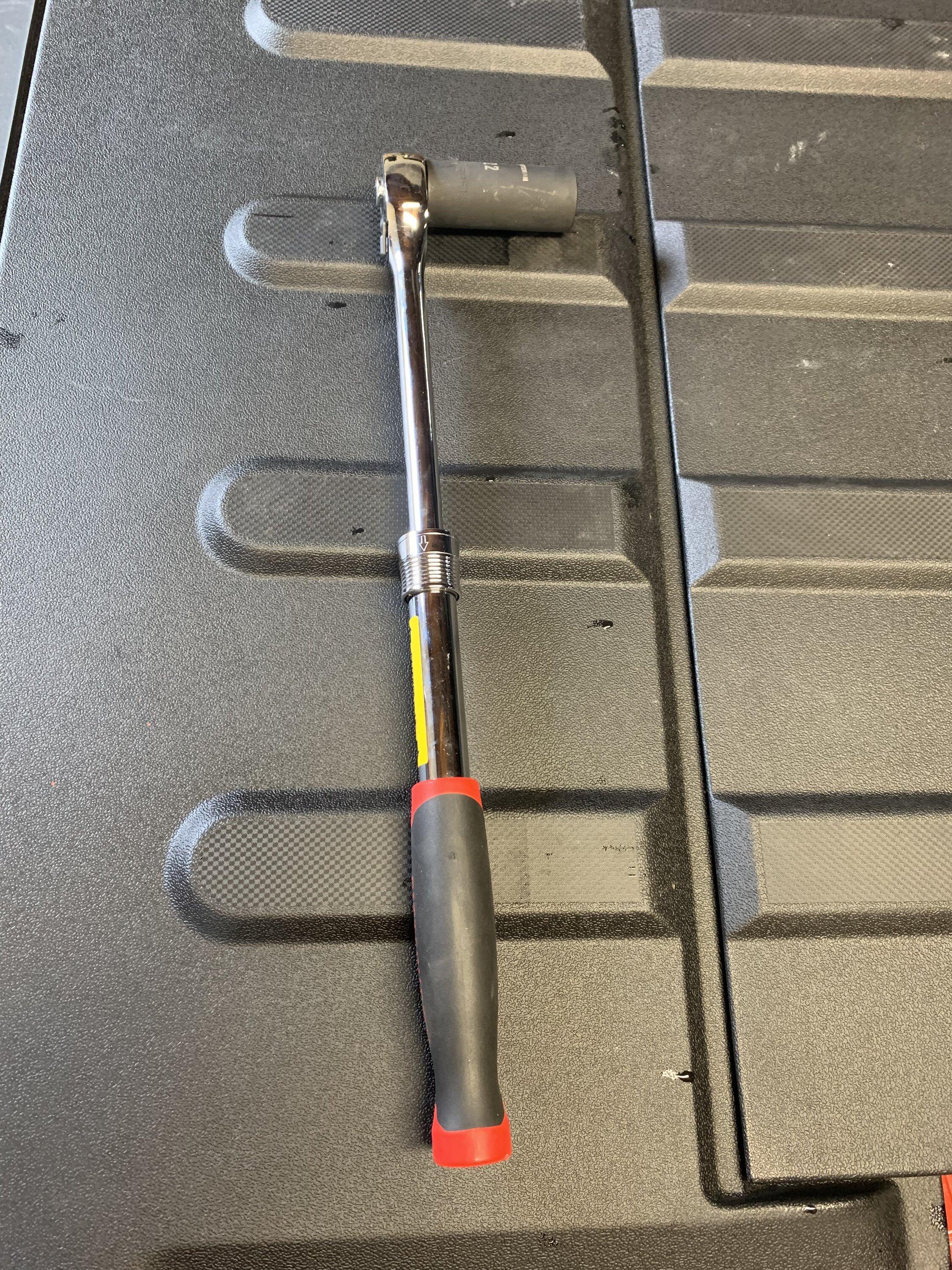

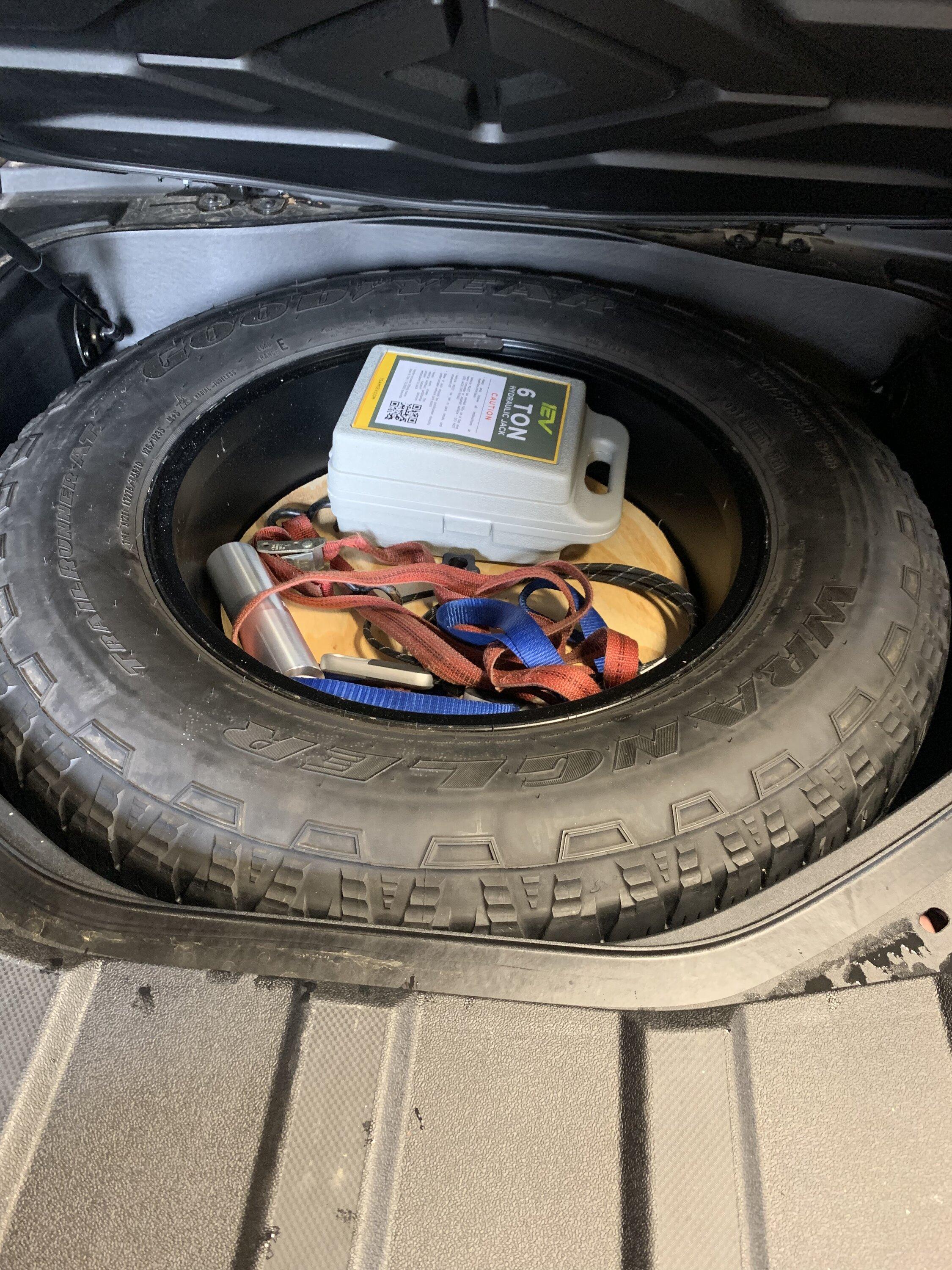

Update: Received my EV Sportline bottle Jack and puck today. I was relieved that the Jack and its case fit inside the spare tire, with just enough room to close the lid.
I also bought a cheap extendable 1/2” drive ratchet from Harbor Freight (~$20) and a Craftsman 22mm deep impact socket from Ace Hardware. I keep them in a small toolbox that I keep in the frunk.
Inside the spare is a good place to store the gear guard cable and some misc straps & bungees. A lot more stuff could be stored inside & outside of the spare.
