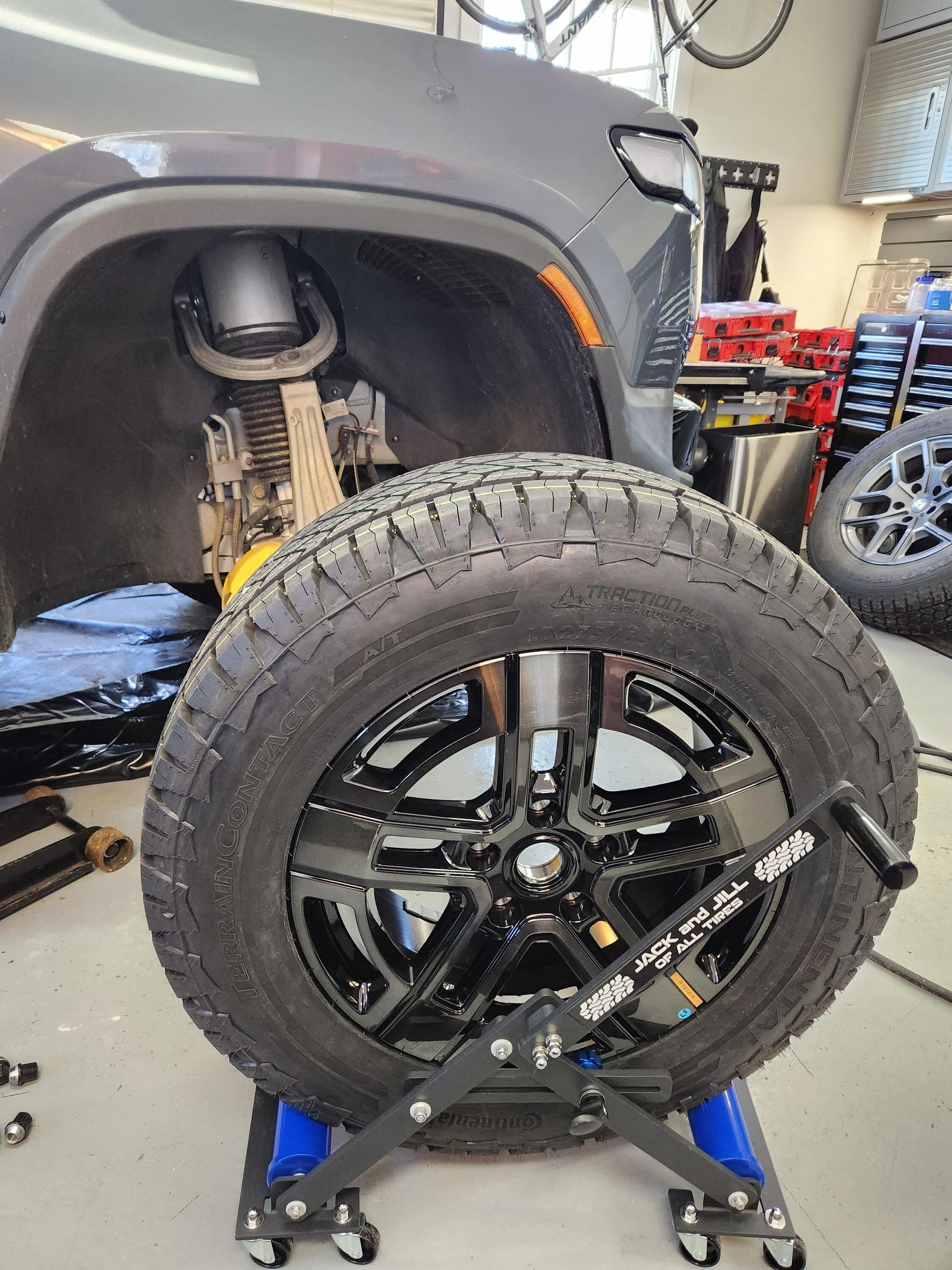

I personally think LT tires are the way to go with this truck. Unless you're into drag racing and need an H rated tire..... Opens up the range of possiblities to chose a tire that suits your needs. Here is my choice for summer shoes for the R1T. Conti Terrain Contact A/T. It's a more road centric A/T tire, is known to be quieter with decent tread life. Can handle some light off roading. The final thing I like about this choice is while it is a more civilized A/T tire, the outer tread block on the sidewall opens up to trick the mind into looking like they are more aggressive.
What you like in a certain purpose category?
And BTW, this Jack and Jill of all tires is a bomb if you don't want to throw truck on lift and hoist these monstrosities off the ground. And if you have a rickety back from racing incident like me. Makes life waay easier.

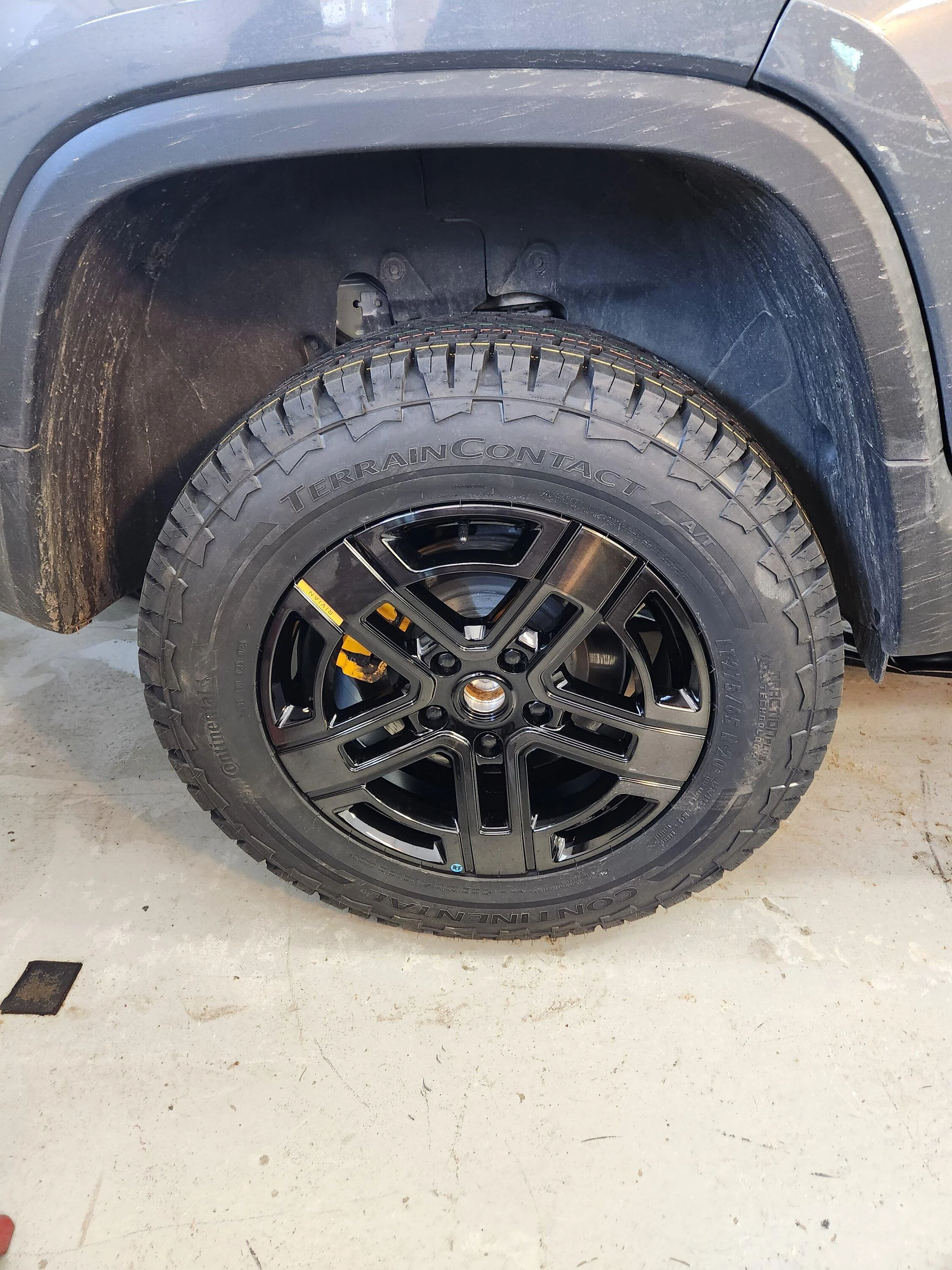

Looks like TerrainContact is 60.6 lbs compared to OEM of 48 lbs. Do you think this will have a significant negative impact on the range? I'm looking for LT tires. Considering Nitto Ridge Grappler, Nitto Recon Grappler or Toyo AT3.
I doubt it, just 48 lbs difference all around. I'd bet some $$ whatever difference there might be is imperceptible. But I couldn't really say to be honest....wouldn't bet my life on it.

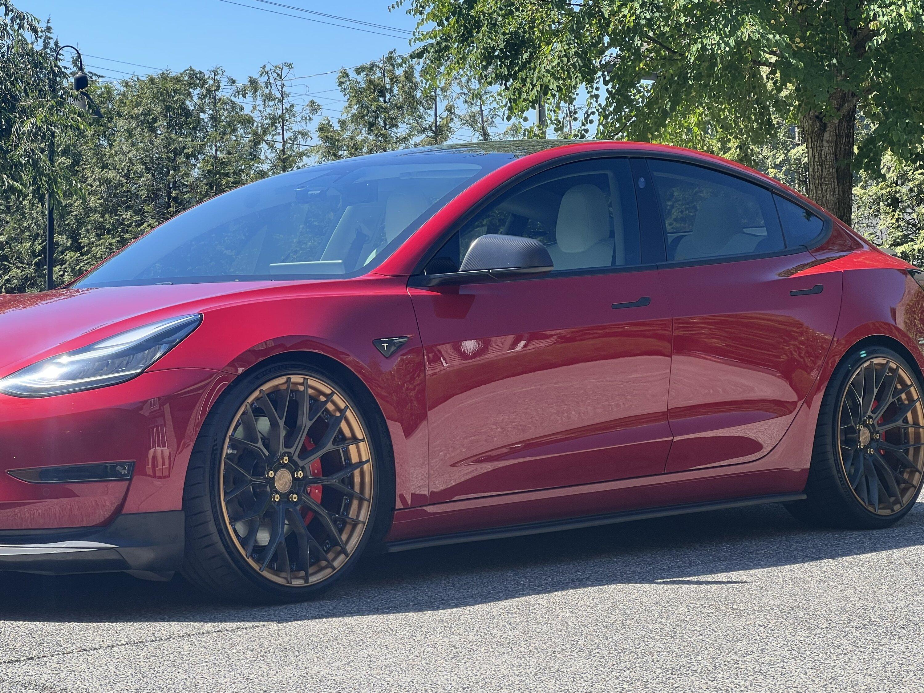

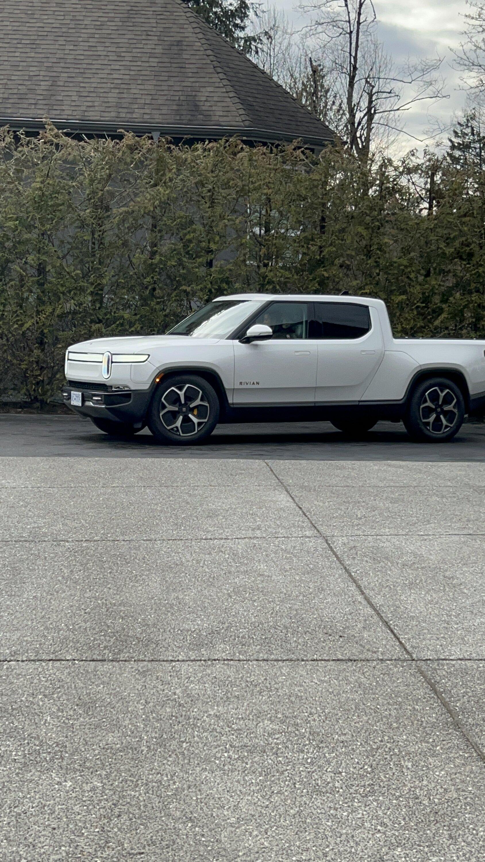

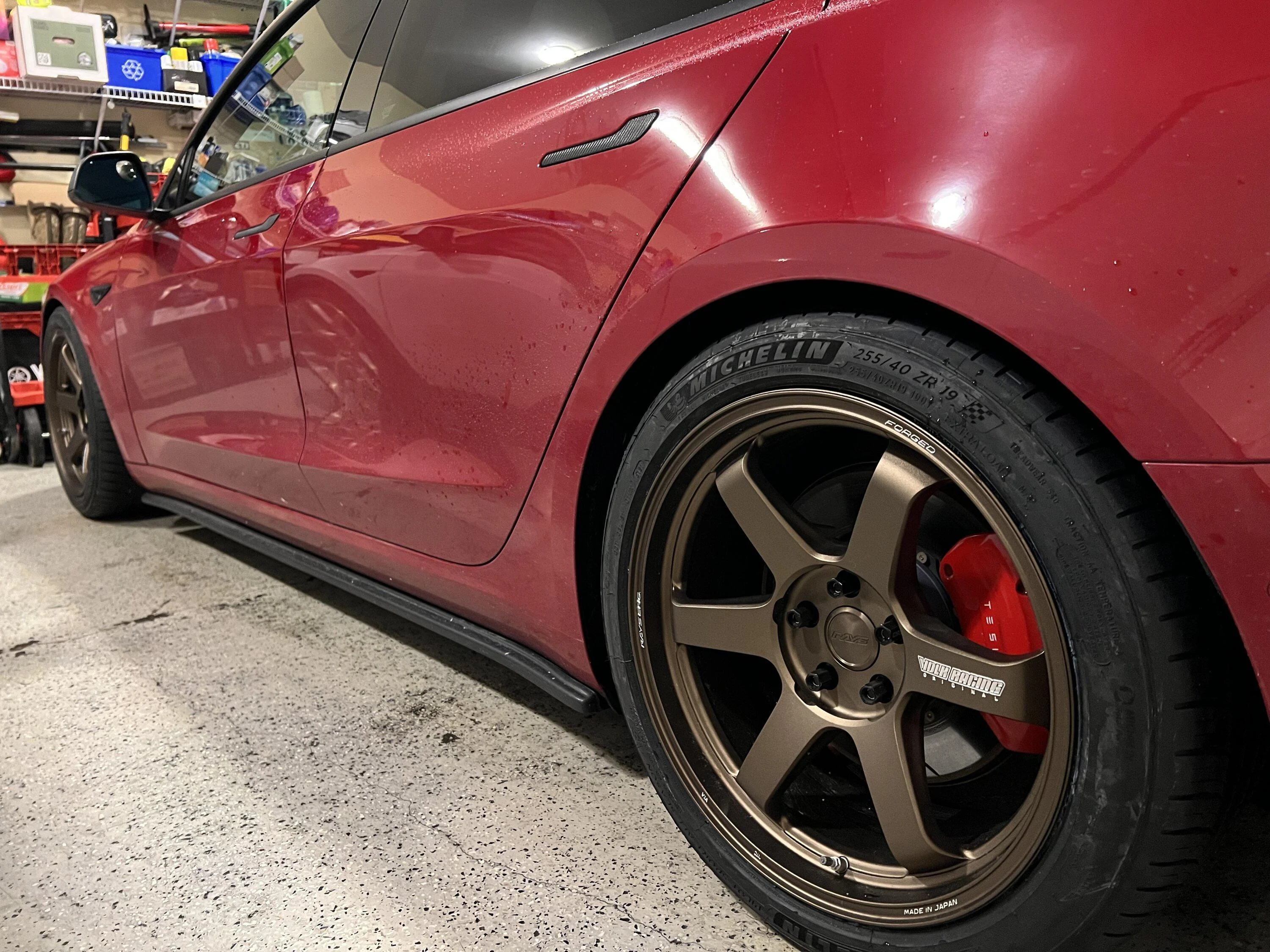

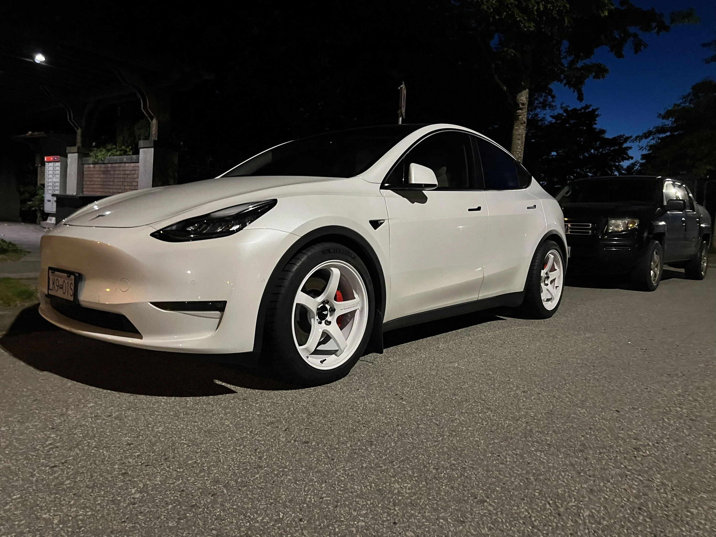

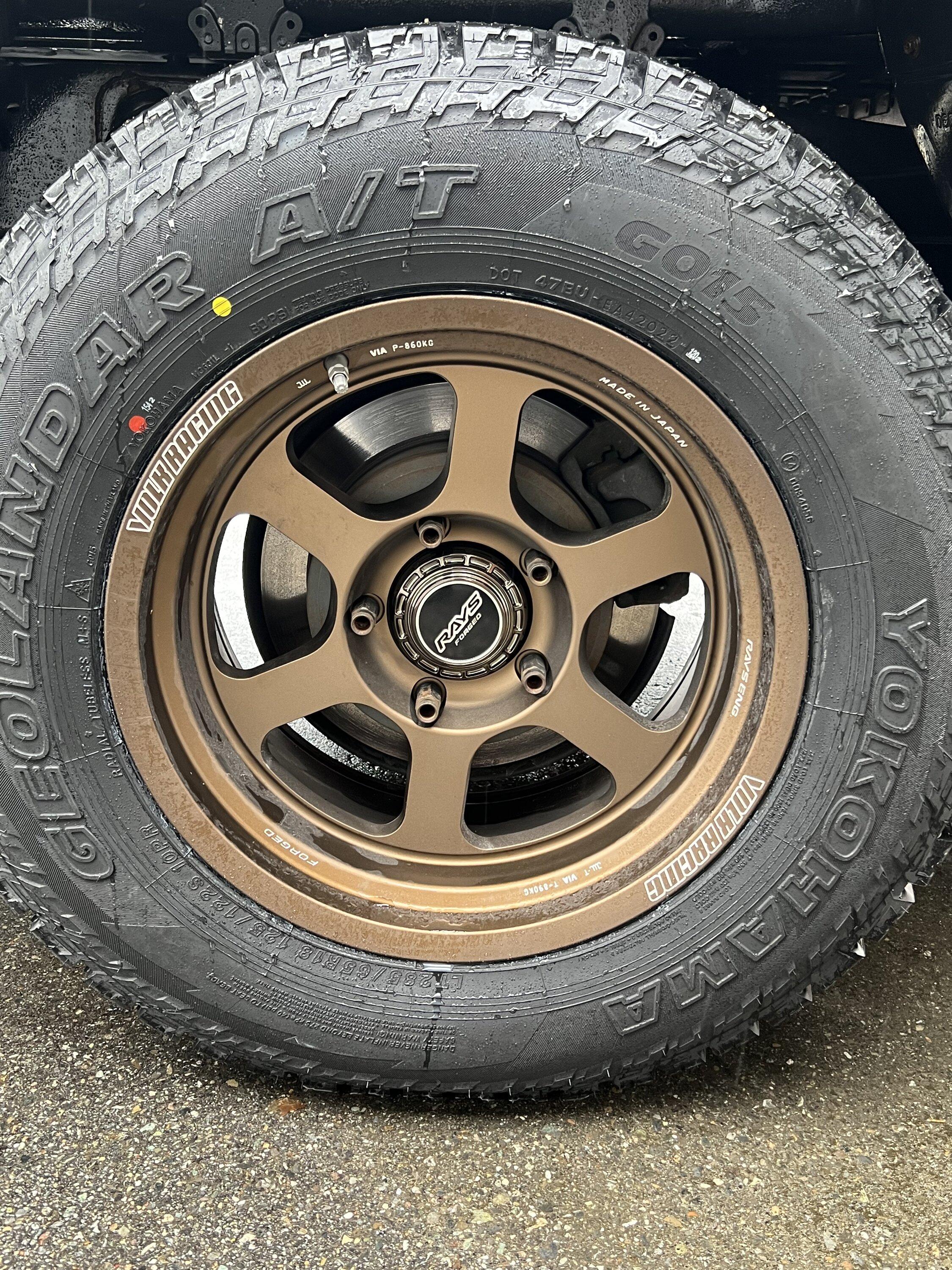

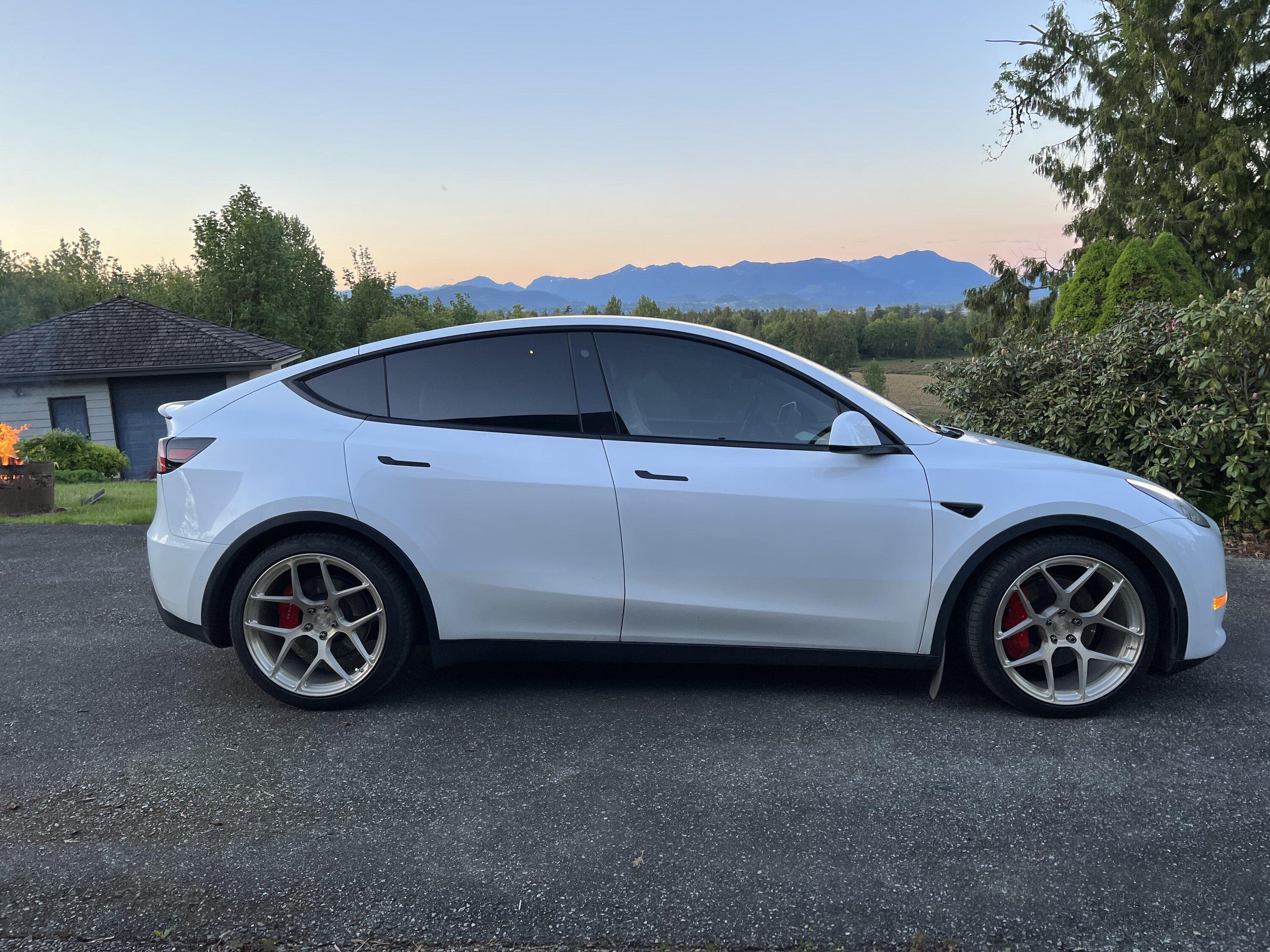

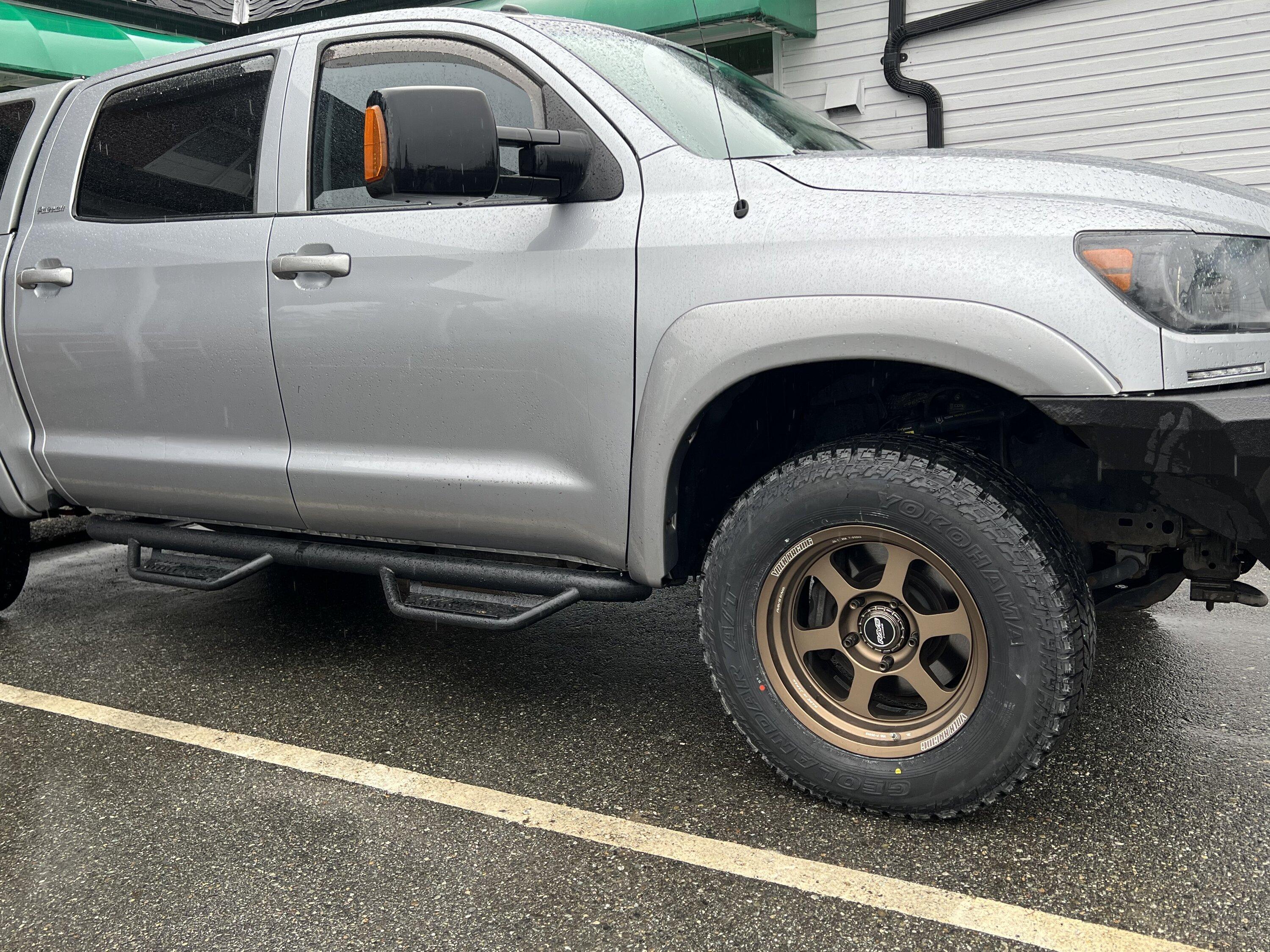

I noticed a loss in mileage in my Toyota Tundra going from Goodyear Duratracs to Toyo OC AT2’s that were heavier. I definitely notice a lower range in my Teslas for compounds and tires throughout the seasons. I’m no stranger to wheels and tires and weight and rolling resistance definitely will affect range. Summer, all-seasons, winters, and studded winters all have differing effects on range.
I’m a fan of Signature wheels and JDM wheels…too bad no Volks or Advans are available for Rivian specs. A few pics of my EV’s and Tundra.

You have some pretty good taste in wheels.
