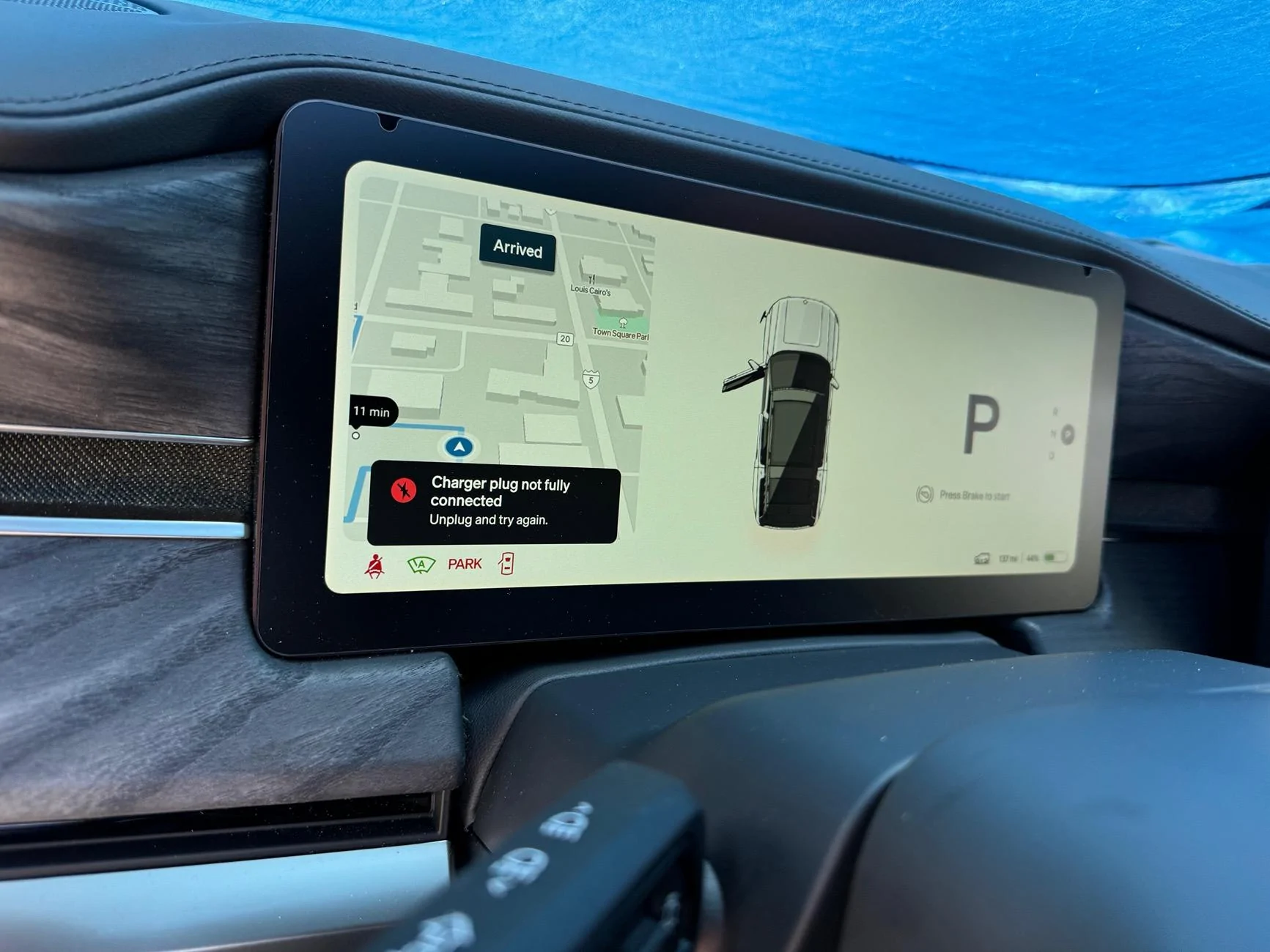

A cutoff switch definitely matches my observations. I didn't see any notification about charging being limited, the error message I got said that the cable was not fully connected, and to unplug/try again, which implies that the truck knew there was something connected but not correctly.

This happened to me this past weekend during a heatwave that hit the west coast. I was driving thru Nor Cal in over 100F (dash read outside temp @ 122F at one pt).
I pulled up to a TSLA SC station that was baking in the sun. The charger handle was already hot to the touch. I plugged the adapter in, it charged for about 3 mins and then shutoff. The below message flashed for about 5s on the screen and then disappeared. No matter how many times I tried replugging or moving to a different station, I could not get the charging to restart.

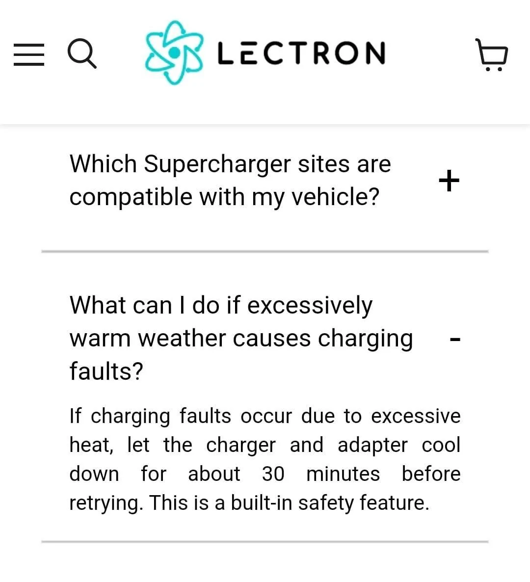

Lectron says differently....which is stupid IMO and thus I wouldn't buy a Lectron.

Yep, Lectron recommends plugging the adapter into the truck first, then plugging the Tesla connector into it. And reverse on the disconnect, remove the Tesla connector from the adapter first, then remove the adapter from the truck.
This has worked flawlessly for me several times (when the adapter isn't overheated of course) and for the folks who got the ones that were an extremely tight fit, made it much easier to remove the Tesla connector from the adapter using the entire truck as leverage. Fortunately the one I got didn't have those issues, I know about them second hand from this forum.

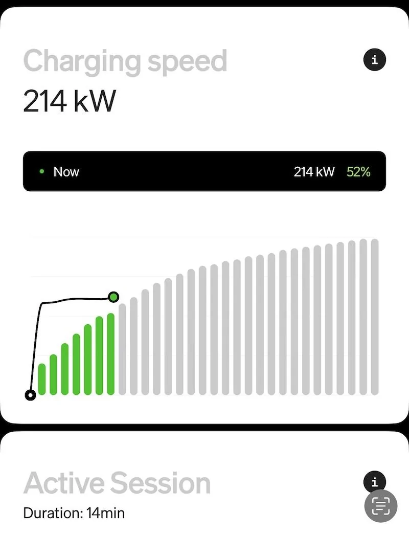

Revisiting this thread now that 2025.18 has been released with higher charging speeds and potentially more problems with adapters overheating.
I was charging at a Tesla V4 Supercharger yesterday using the Lectron adapter and saw a blazing 214kW even at 52% SOC and 14 minutes of charging. Very shortly thereafter however it throttled way back to 102-104kW and stayed there until I was finished at over 75% SOC (sorry didn't get a followup screenshot). No errors saying that the charger was limiting speed and I wouldn't expect a V4 charger to overheat. Was about 90Āŗ with direct sunshine on the adapter, and was very hot to the touch when I unplugged (although didn't get burned). Maybe the adapter was throttling the charge? This could happen more frequently since Rivian is letting the charging process run hotter (and faster!) with the new update.

Fwiw, I have the Rivian NACS adapter and it also derates rather quickly (doesn’t hold >200 kW for very long) though it was a more gradual step down (something like 212 > 190 > 175 > 120 > 85 > 50 as it approaches 80% SOC).
I have also seen similar charge curves at an EA DCFC station as at the Tesla v4 so I don’t think the adapter is the culprit.
but, to go from 214 > 104 is a pretty steep drop, so maybe.
There’s only 1 sure way to tell for certain…. Try charging under similar circumstances @ a CCS station.
