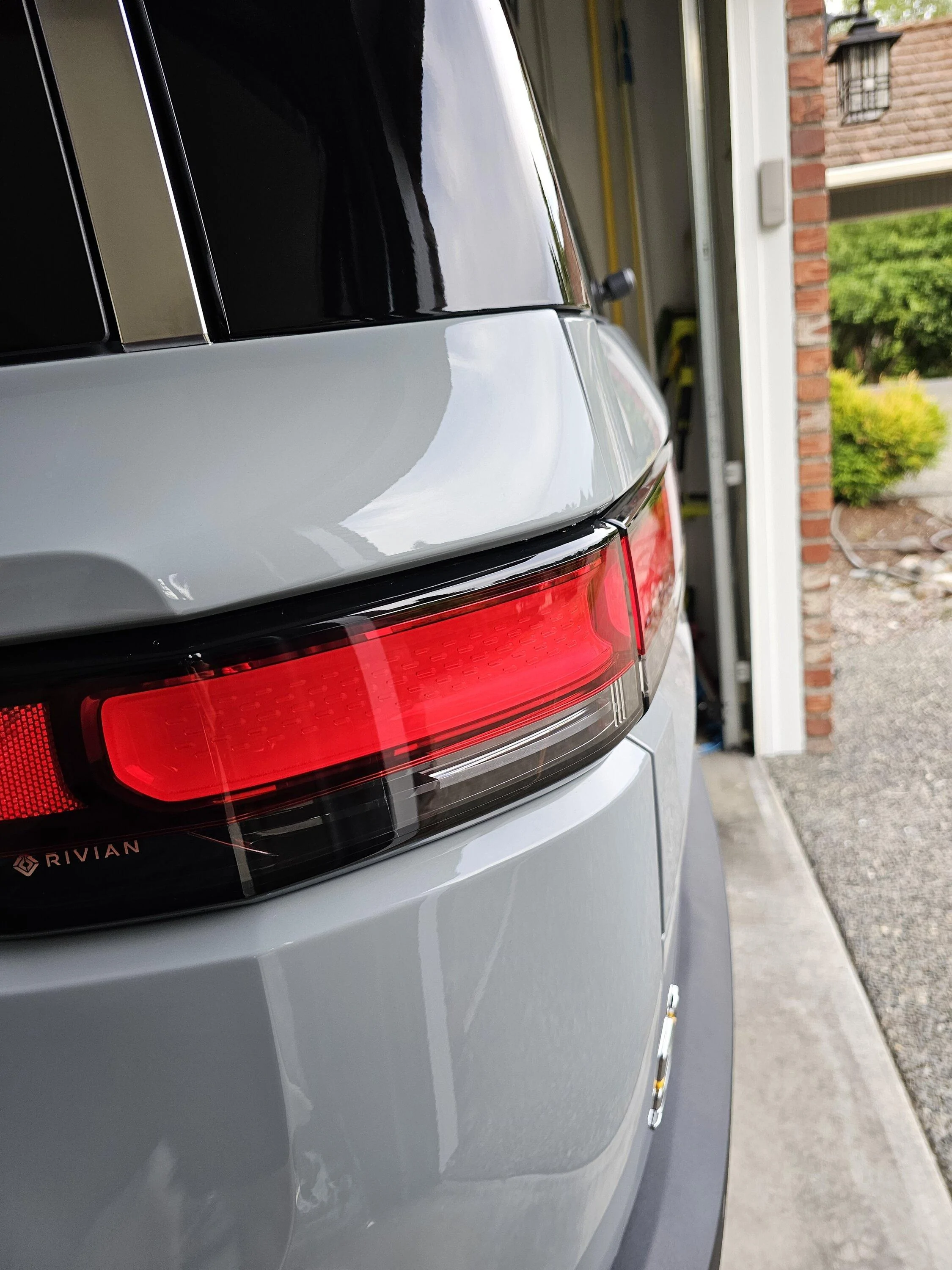

Well... 10 minutes with a socket wrench and the tailgate alignment is now perfect.

Yep.. that is exactly how mine looks.
My liftgate and the driver side door was off just like yours. They fixed my liftgate on the first tried but didn't do a good job with the driver side door (still a little bit too high). It is currently at the shop to redo. vin 5xxx
