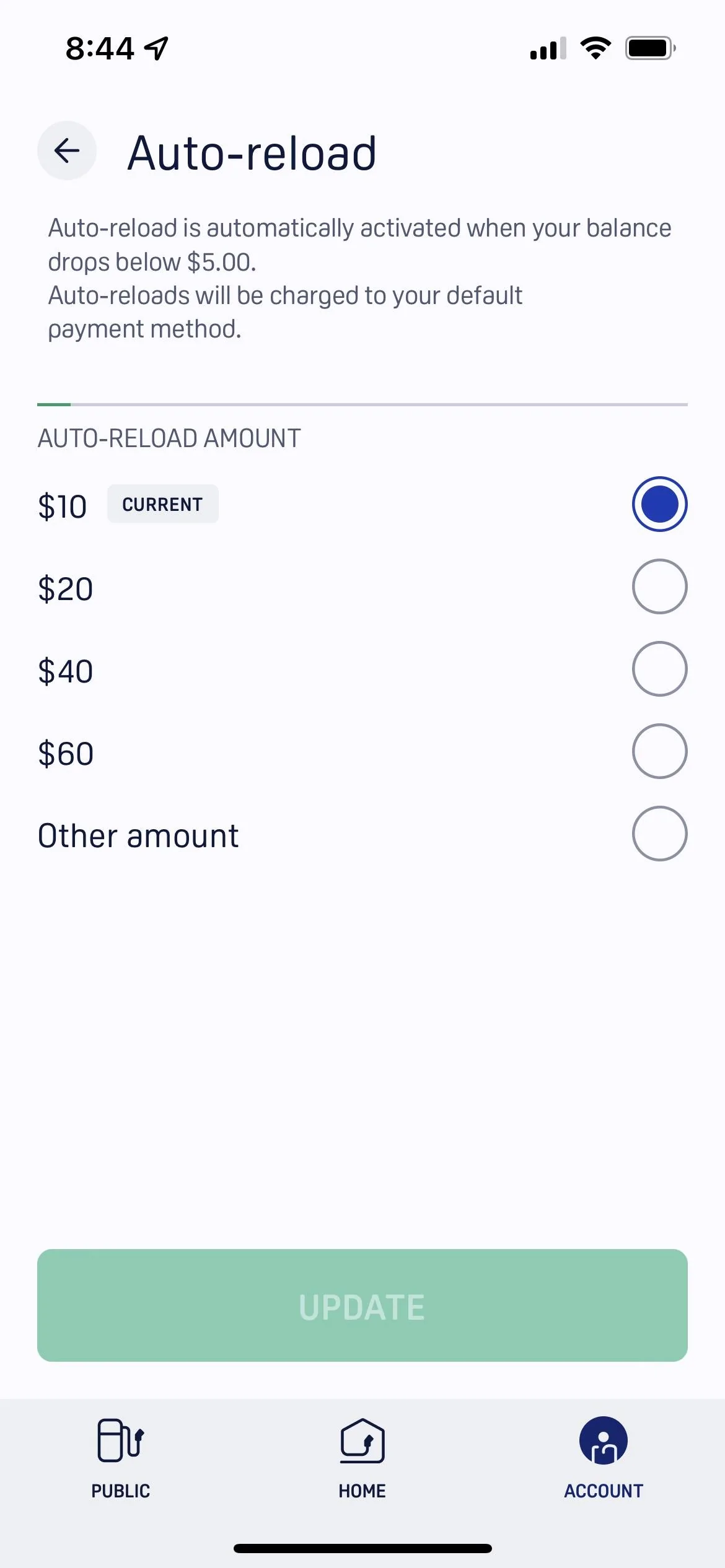

I had an issue where an EA charger in Evanston, WY worked for me on the outbound leg of a trip, but not on the return a few hours later. I chalked it up to user error since I’d had an issue with fraud on my credit card and the card issuer may have denied it. I didn’t need the charge to get home, and really didn’t have time to debug it, so after trying and failing on 3 different chargers I just bailed on it.
One other cause could have been that I hadn’t put any money into my EA account. Does anyone know if you have to do that before charging, or does it just bill your credit card at the end of each charge? I’m new to EA, and to using mobile pay on my iPhone, so still learning all the nuances. On the successful charge, it pulled up my credit card directly from my apply wallet vs. pulling up the EA app. That’s part of what led me to believe the issue was with my credit card on the failed session, as I also got an alert from the credit card company wanting me to verify the transaction.
I have an auto reload setup on the EA app, it will pull in $10 increments from my CC as I charge.
When you pay with the EA "card" in your apple wallet it's not actually charging your credit card. it is pulling from your EA balance. You have up actively add money to that balance.
In the app there is an autoload feature whereby you can have EA load money wherever your balance drops below $5 (not sure if that's customizable).
That’s what I suspected. Thanks for clarifying, and I did set up the auto reload after I got home from that trip. Hopefully the next attempt will be more better. ?
