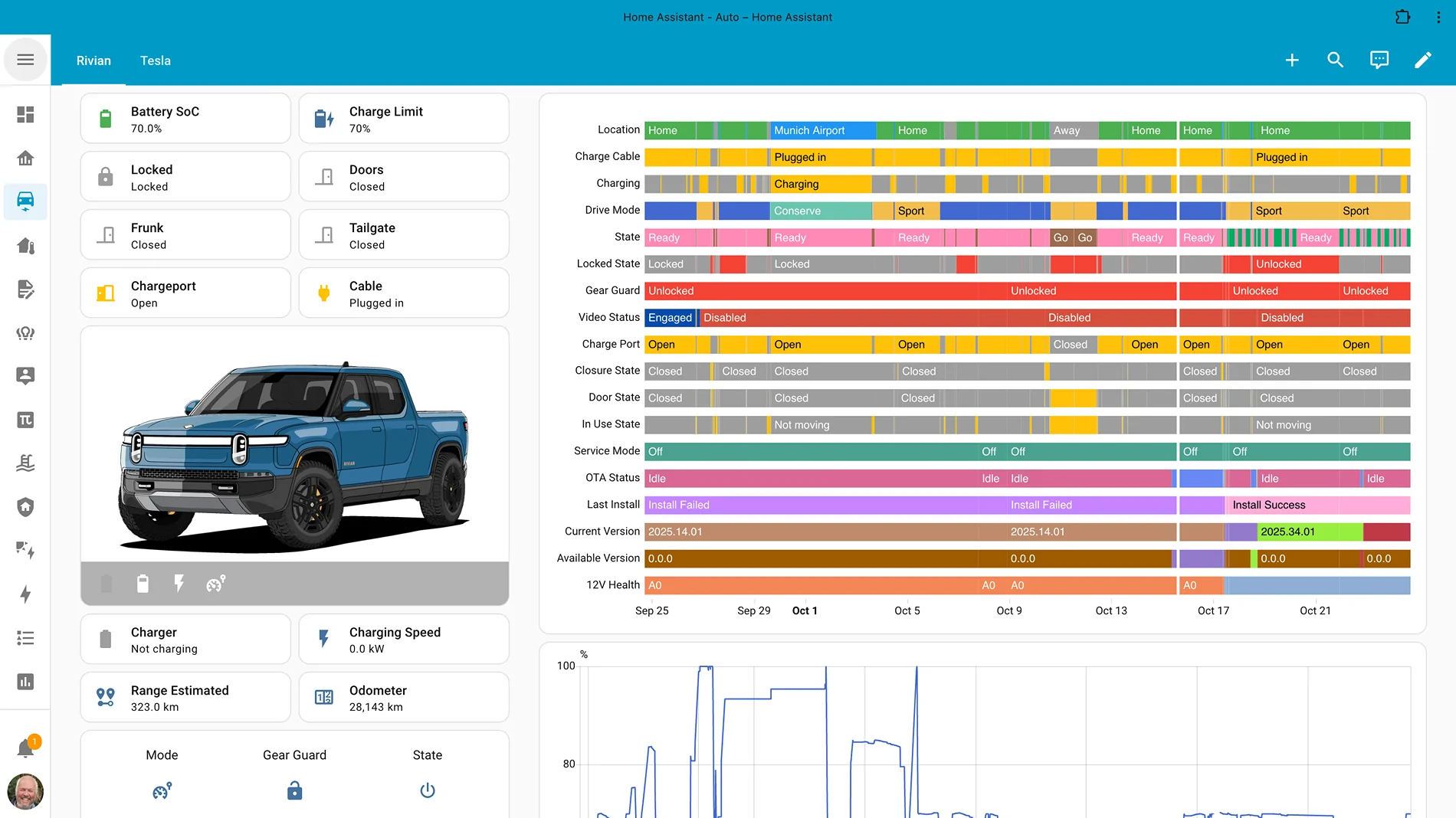

Rivian R1T R1S Installing HomeAssistant to capture Rivian API data - DIY How-to Screenshot 2025-10-24 at 7.04.58 PM

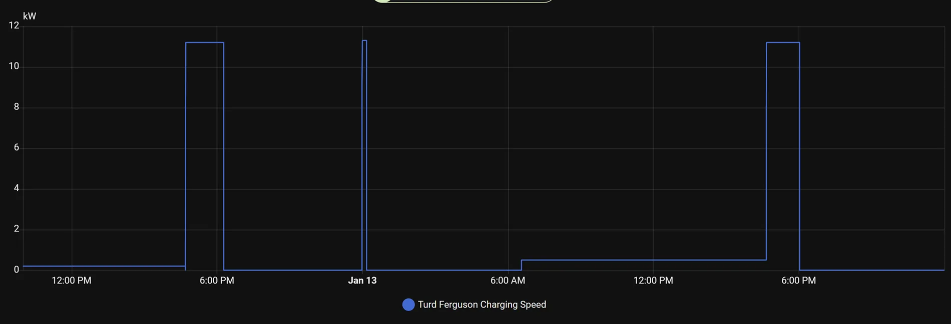

Rivian R1T R1S Installing HomeAssistant to capture Rivian API data - DIY How-to 1768509181473-wj
Edit: Or are you asking if HA can set the desired rate? That I don't know. I don't allow HA to control the vehicle.
