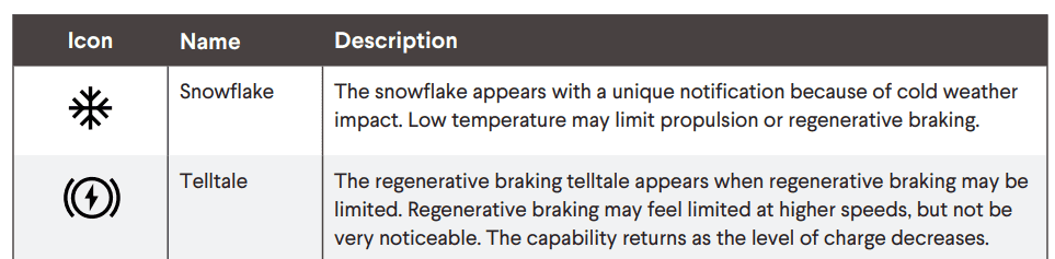

Temporary complete loss like that aside, I have noticed when regen braking starts being limited and the truck is displaying the hash marks on the bar, that once you are into regen enough to illuminate the hashed part of the bar that there is still considerable regen still available. Using it will cause the hashed area to start growing and eventually become so large that at some point it is reduced so much it feels like the truck is just coasting. If you can stay out of the 'extra' regen it doesn't seem to do that.
Ultimately I do agree that Rivian still has some tuning to do here, and that it would be nice to have mechanical brakes blended in when regen is extremely limited.

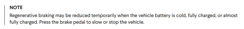

The temperature was in the low 40s. The regen limited warning was never shown and regen was working fully for the entirety of the trip. Even if regen was limited, it shouldn’t decide to turn off going 50 mph down a mountain pass, 50 miles into the trip.
I think what happened was this:
- regen was applied fully, and working fully
- the downhill slope caused the regen to be overloaded somehow (too much current to the battery?)
- regen turns off completely (!)
- car lunges forward
- regen ramps up again
That, my friends, is a BRAKE FAILURE and a non-negotiable safety issue. If regen chokes for whatever reason, the real brakes have to compensate instantly. I can’t have the car braking, then stop braking immediately because of black magic reasons. This is just shit engineering.
This is par the course for EVs. My Model Y did the exact same thing. There should have been a warning sign saying regen is limited. I went down a mountain a few weeks ago in my R1T and had to use the brakes most of the way.
I get 3-4 messages a day on my morning commute. It flaps back and forth between limited due to cold and limited due to charge. The message displayed doesn't always match the icon next to the graph either.
