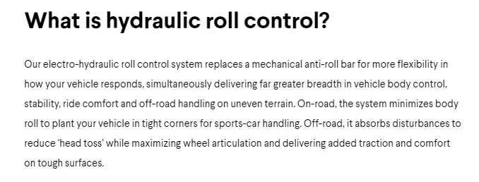

Somehow in all the hunting I've done through the Rivian website I missed this very cool technical feature. Anyone else not know about it?
Rivian R1T R1S Hydraulic roll-control & other FAQ tid-bits Hyd roll-control
Checkout the FAQ's. Maybe there's something new for you https://rivian.com/support/vehicles

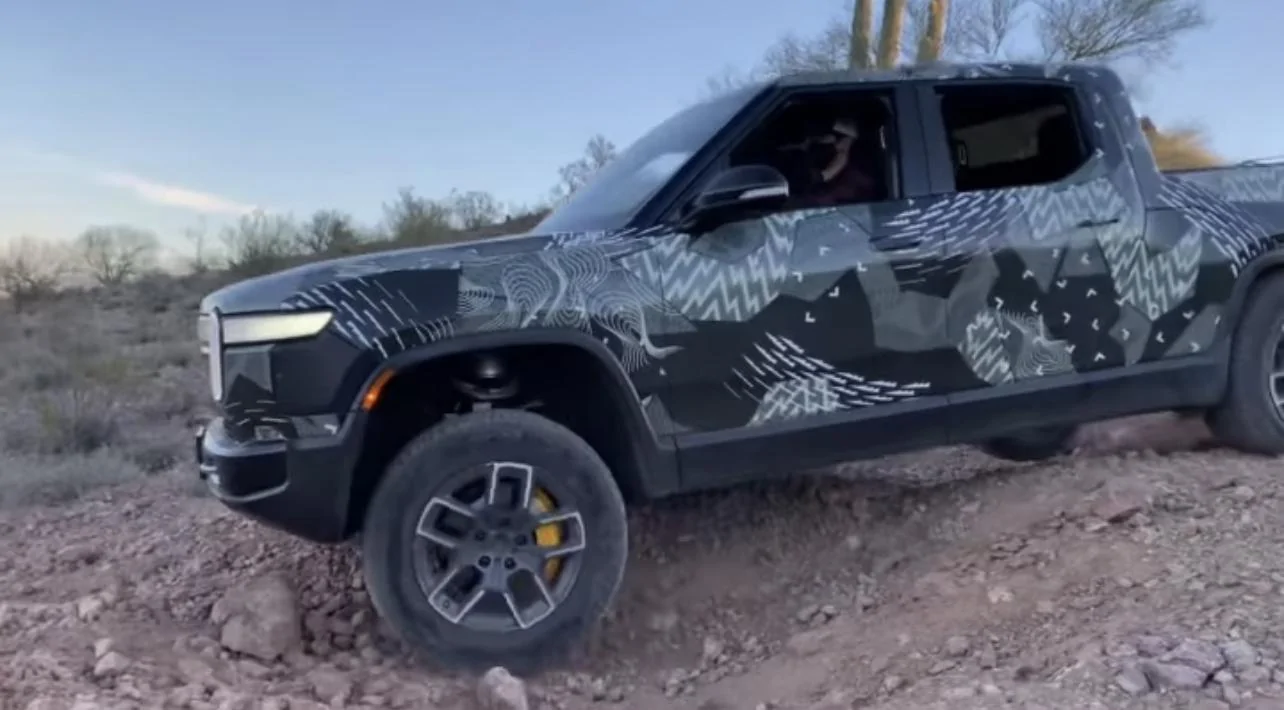

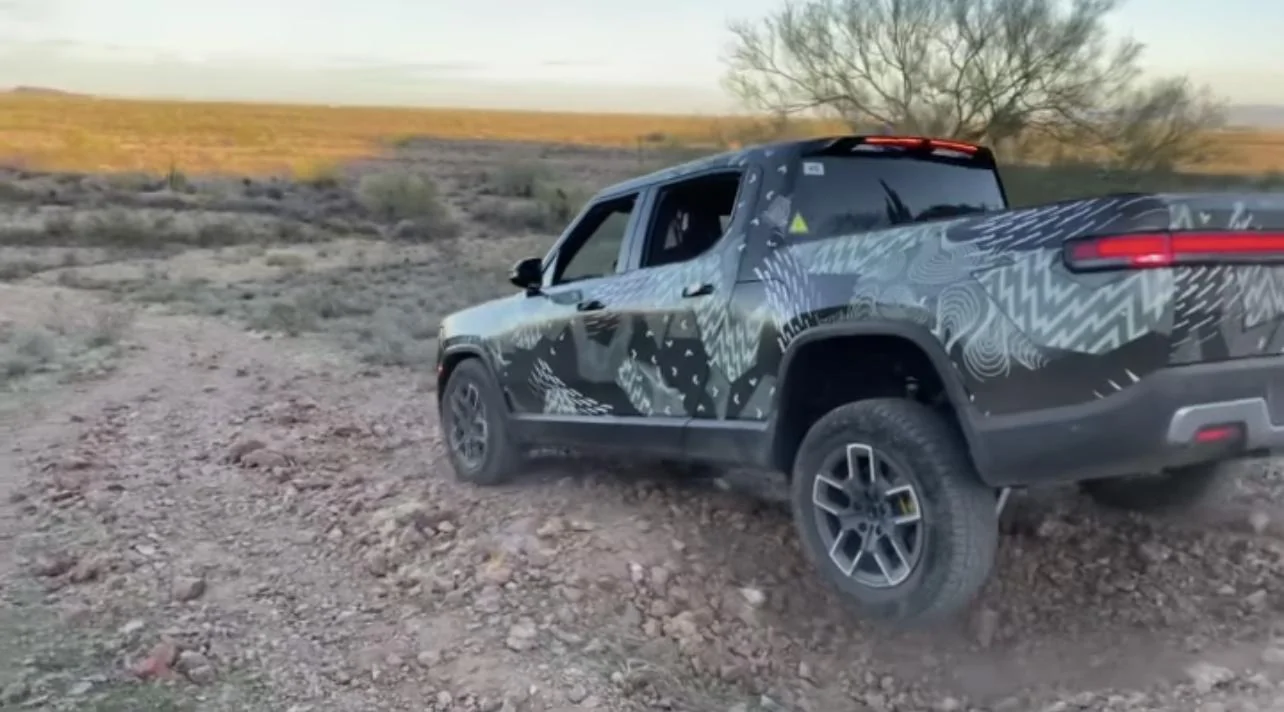

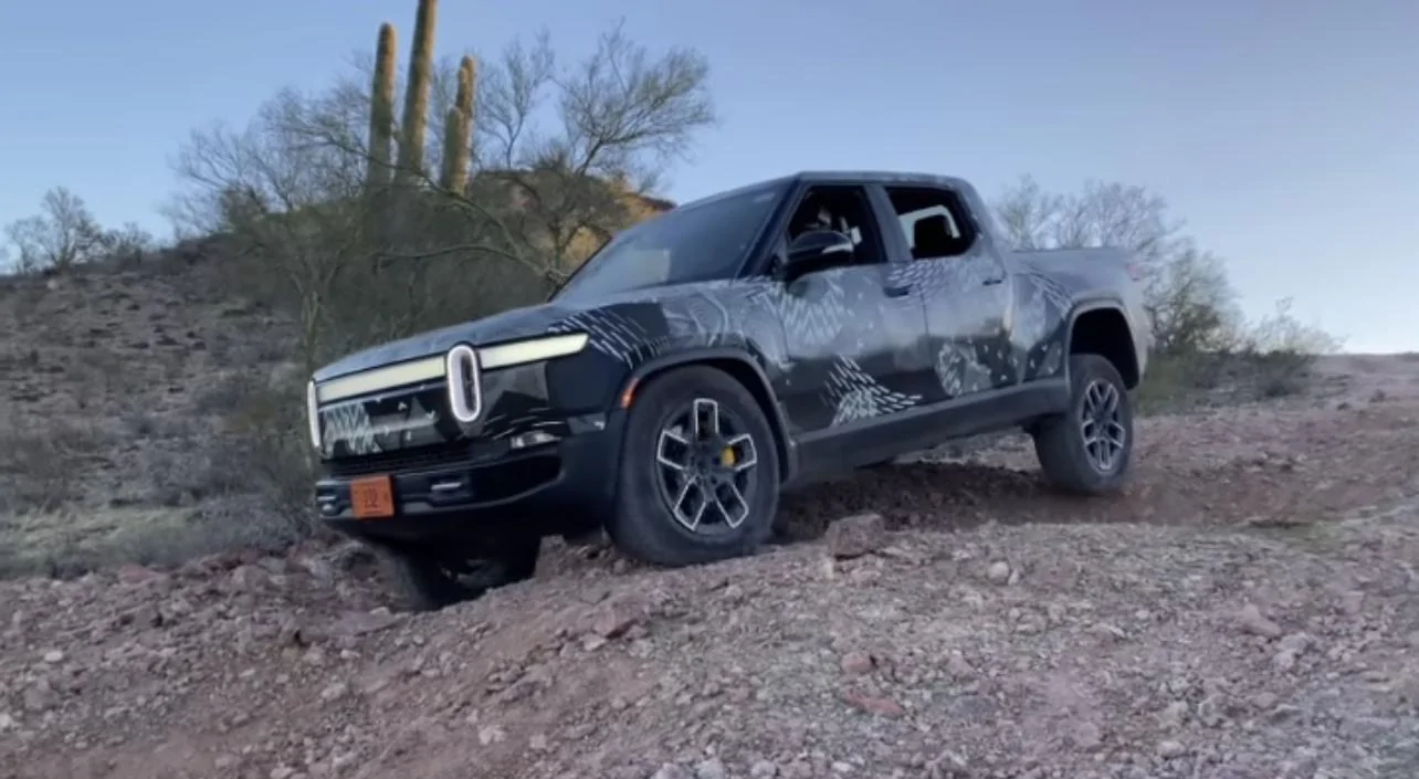

Here’s full compression and full droop, I grabbed screenshots when I first saw the video. Looks decent for independent suspension on a street vehicle, however it’s about half the articulation you get with a solid axle vehicle like the jeep, power wagon, etc. should be “good enough” for most people’s use, probably almost what you’d get from a stock Tacoma or 4Runner.
