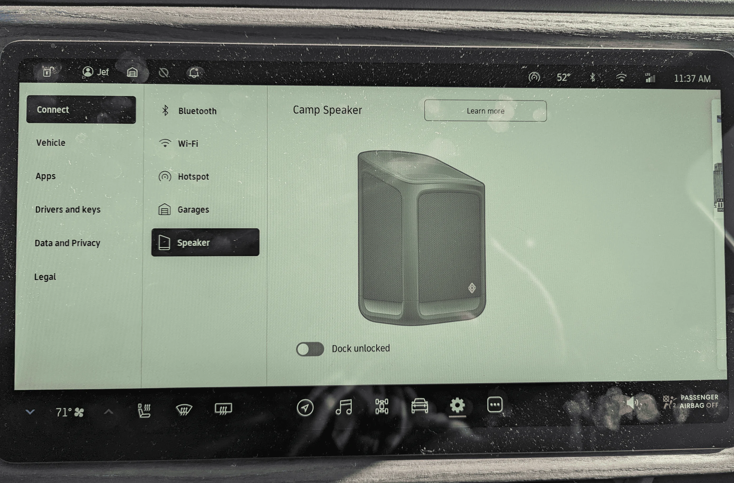

Settings > Connect > Speaker.
There's a toggle in there to unlock it (pardon the dust and fingerprints)

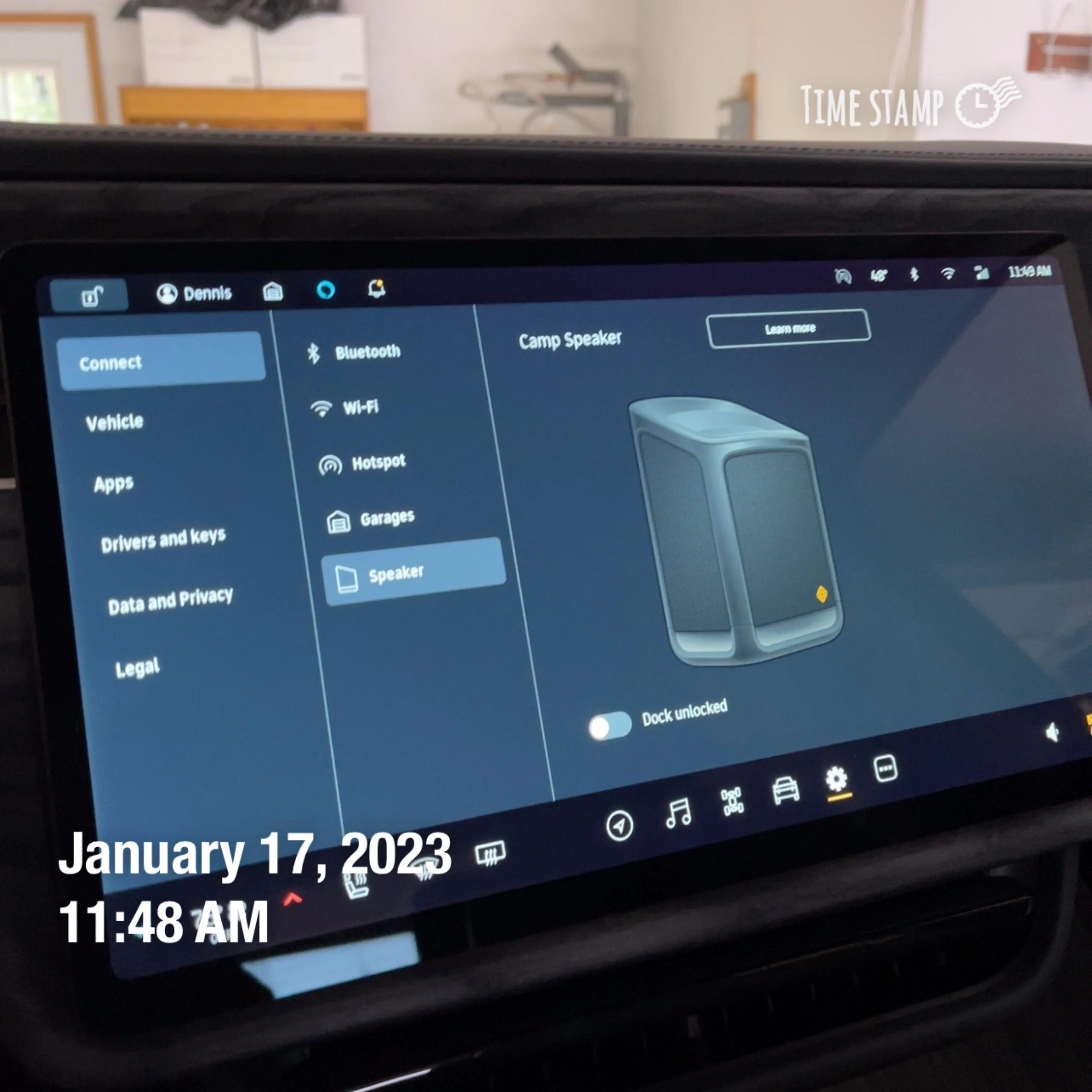

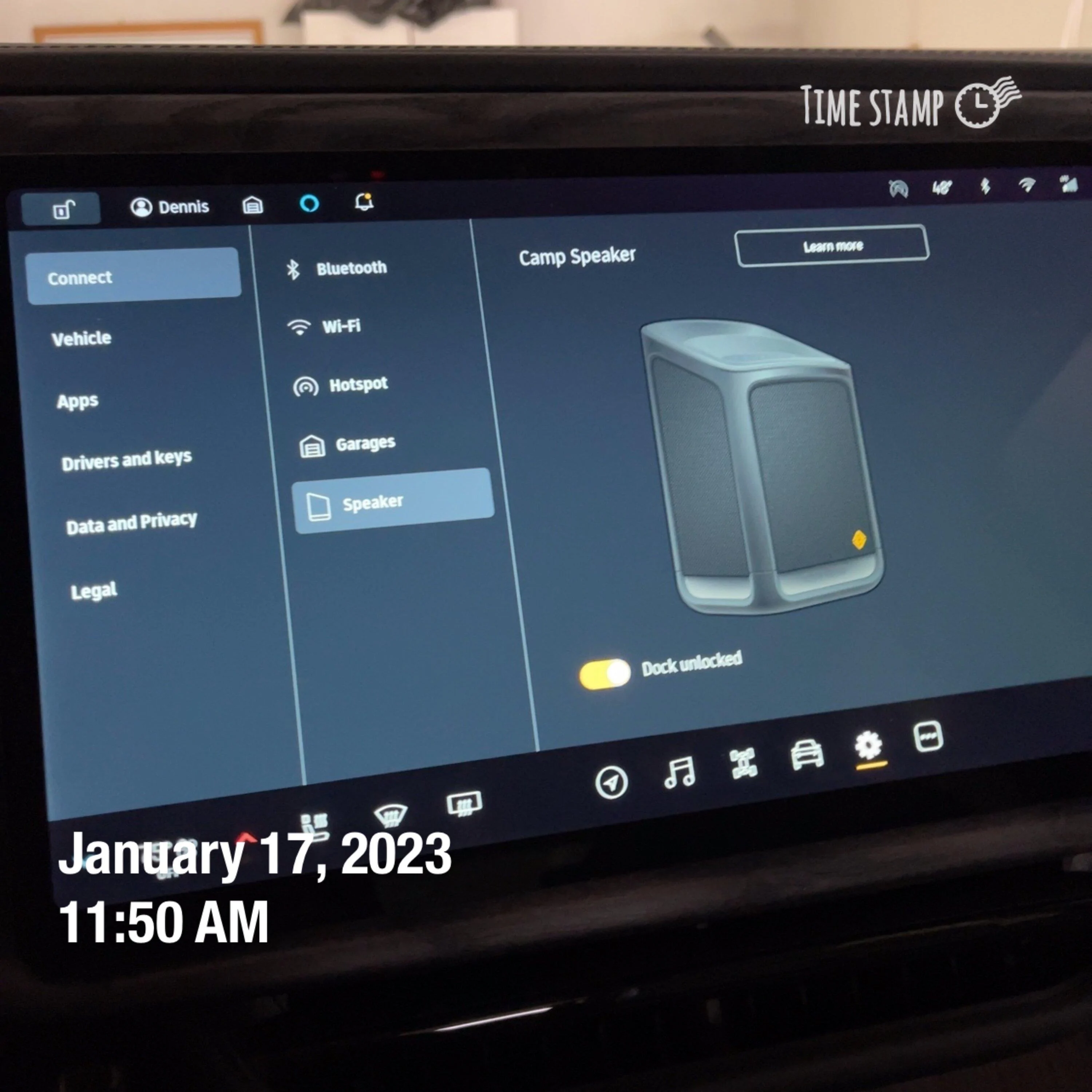

thanks, I found that screen on my R1T. I took a couple photos, one supposedly unlocked and the other locked. It still won't come out of that hole regardless. I'm pulling with both hands also. It's stuck. Maybe time to inform CS or my guide?
ps: what seems kind of weird to me is the "button" says unlocked even if it's to the right or left. I would think if the color is yellow, it should say locked? or is there something i'm not seeing?

r1tshivermetimbers
Richard
Jul 8, 2022
85
54
2022 R1T LE .. Vin#65xx
Hi there,
I had the same issue when I had my truck on day 1, no matter what I did the speaker won't detach.
SC diagnosed it that the speaker latch was broken. When I was there, it looked like this is not uncommon. They had to removed the entire center console and replace that latch. It works now.
Hope this helps.
