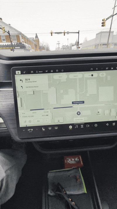

This was a clip I captured when I sent in the ticket. I assume this is the same issue that others are or have had.
Rivian R1T R1S GPS position "jumping" around... 1000002455
ECP
Erik
May 25, 2024
I had the exact same problem. Mobile service solved it in less than an hour by disconnecting 12v battery (I don’t know which one). No issues since then.
