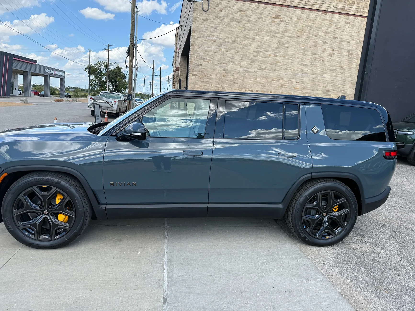

Forgive me if this has been asked/answered previously...
I've only had my Gen2 R1S TM for 2.5mos. As configured my vehicle should get estimated 371mi. according to Rivian's own configurator. I've only charged at home w/the Rivian charger & the 2x I've charged to 100% the vehicle tops out at 356mi of range. I've just crossed 1100mi & avg. efficiency of 2.4mi/kWh & always in All-Purpose mode.
Now I'm a realist, & know under real world driving conditions (& Dallas-Fort Worth traffic) I'm never actually going to get 371mi on a single charge. But shouldn't the vehicle, when charged to 100%, at least show 371mi as the estimated range available? Am I making too big of an issue out of this or should I be concerned?

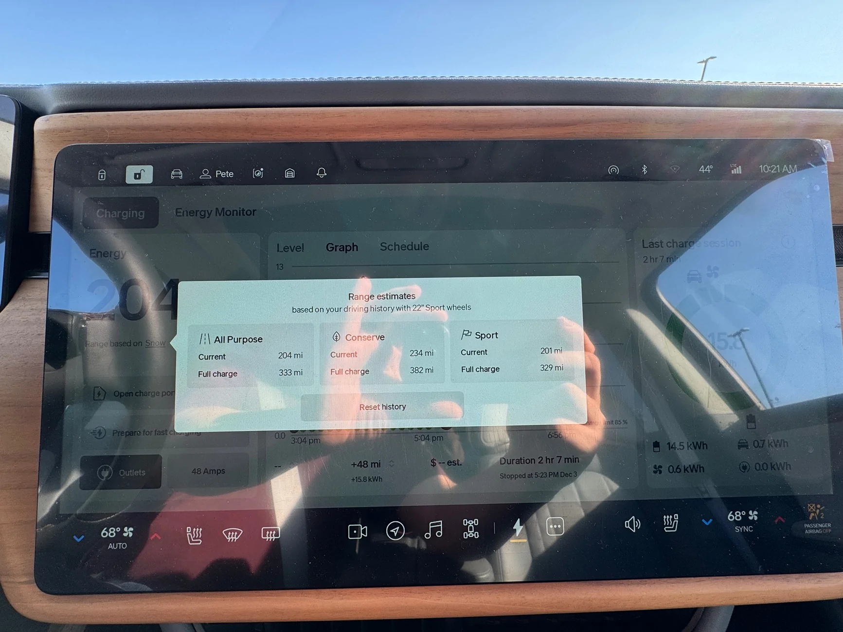

What does it show in conserve mode?
The range estimates are just a fixed multiplier for a drive mode vs the current and current max accessible battery capacity. The ‘based on driving history’ verbiage refers to a feature yet to be implemented (I have this in writing from Rivian).
Here’s our trimax currently (above around 50f ambient it will display the ‘epa’ numbers, ie 346 for AP, 395 for conserve, this photo was taken with the battery at 38f):
Rivian R1T R1S Gen2 R1S TM Range Less Than Advertised? IMG_6916
mikehmb
Jan 12, 2022
154
2,303
5,224
SF Bay Area
Here’s our trimax currently (above around 50f ambient it will display the ‘epa’ numbers, ie 346 for AP, 395 for conserve):
I think you just answered the question - if it shows higher numbers above 50 degrees ambient, it's actually doing something smart (compared to earlier SW which was basically guess + maybe some driving history) and taking into account battery temp management energy consumption.
Very cool to learn, regardless. Mine (dual perf max) shows pretty much "420" for AP all the time, regardless of temps. But I just got it in Sept and it hasn't really gotten below 40 degrees here yet.
