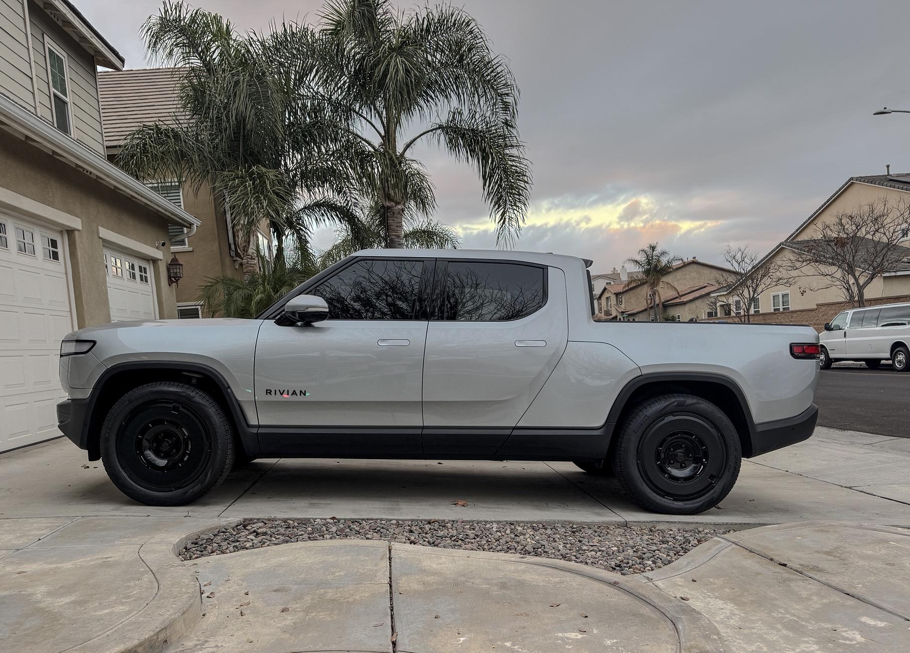

They fit with zero issues. Here is my Gen 1 with Gen 2 Aero Wheels that I customized to all black.
Rivian R1T R1S Gen2 22" Range Wheels ARE compatible with Gen1... IMG_8139
