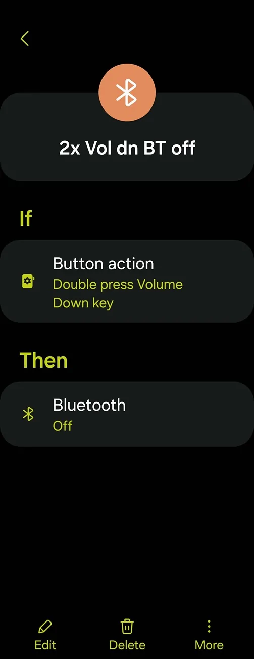

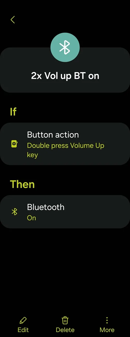

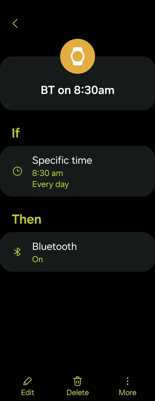

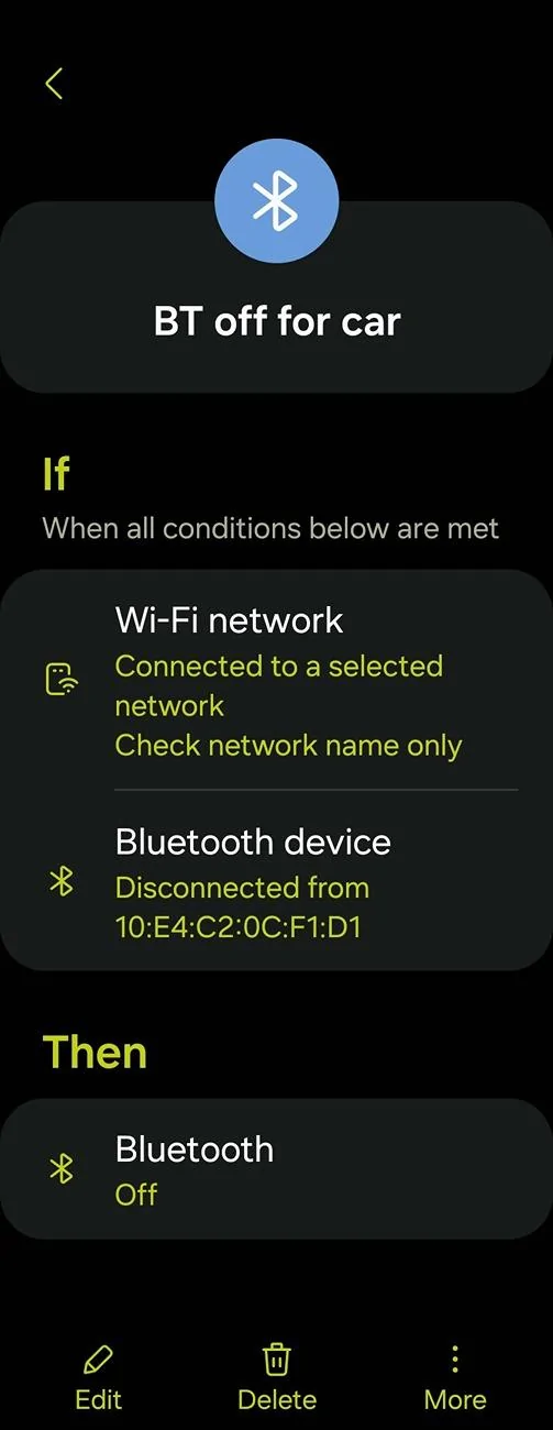

Here are some screen shots that should help. I also use earbuds and have them as an exception so it doesn't turn off BT when I'm using them.
Rivian R1T R1S Gen 1 Vampire Drain (Possibly) Solved (or Hacked) 2024-09-23 15.42.22
Here's the one to turn on in the morning.
Rivian R1T R1S Gen 1 Vampire Drain (Possibly) Solved (or Hacked) 2024-09-23 15.42.01
Rivian R1T R1S Gen 1 Vampire Drain (Possibly) Solved (or Hacked) 2024-09-23 15.42.57
Here's how to assign buttons for when it's an exception to what you need.

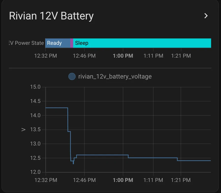

I installed 12V battery sensor that reports to my Home Assistant:
I will continue to monitor this. I took delivery in May 2023, the car production date is March 2023, 1 battery. 23k miles

That is a bit strange as as much as charging a 12V battery takes per 24 hours (let's say 2kWh) - it should not affect driving efficiency in any visible way, IMHO.
Interesting. It does look like it’s using a fairly standard lead-acid charge cycle, even with an abbreviated float stage. Then there’s just that voltage drop to about 12.2V right before it wakes up and begins the cycle again.

Indeed, here is another image:
So during sleep something is draining the 12V battery, I would say maybe it is a Bluetooth sensor, maybe something else. BT sensors are up and running as I can see them in the BT scanner. Even if the proximity lock is off.
