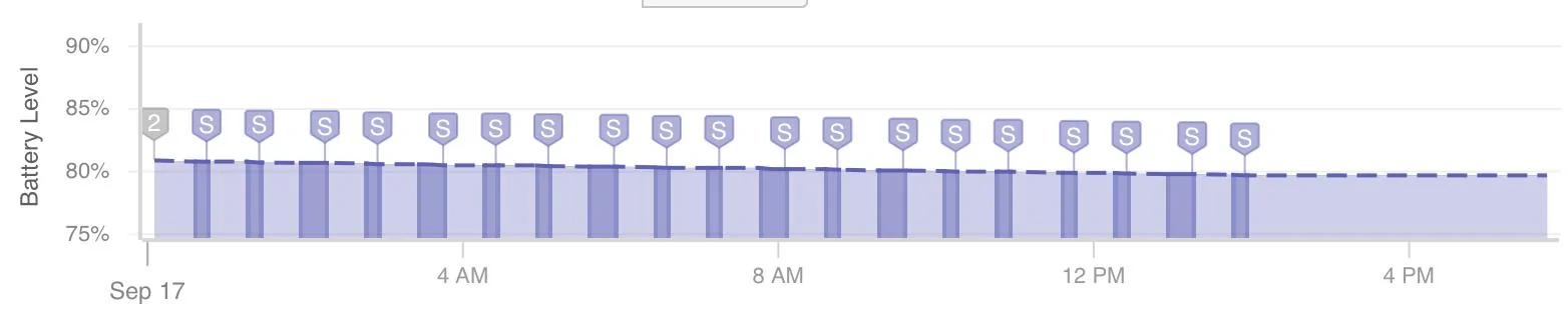

I managed to find a different brand OBD2 to 12V adapter and started testing this afternoon. My preliminary testing so far is VERY promising. My R1S wouldn't stay asleep for more than 30 min without waking up for 15. Now it has slept for 2 hrs. When I plugged in my 3 amp BT, the LED came on to indicate that it was charging, then about 15 min later, it went sold green to indicate charged. Looking forward to see if my VD is decreased, but this is promising. I'll see how the VD looks by morning. For those that garage park this is the easiest method to charge the 12V battery.
The adapter I purchased is https://www.amazon.com/dp/B00Y38WRSI .. it is pretty long and honestly is kinda loose in the OBD2 port. Not sure if the Battery Tender branded one is more snug.
Update : since connecting the OBD2 Battery Tender, my vehicle has slept for about 4 hours and continues to sleep. From the capture below, you can see the constant sleep/wake cycling prior to the tender connection followed by a well deserved long sleep! hopefully it will get more rest and less VD!
24 Hour update : According to Electrafi data, my vehicle (single 12V battery using OBD2 to 3A Battery Tender) has slept for an entire 24 hours! I woke the vehicle by unlocking, depressing the brake pedal, then relocked To confirm that there was no power loss. This method may be the way to resolve VD once and for all. I’ll test for about a week, then will test again without the Battery Tender connected.

That's great. Have you measured how much power the 12V recharge is taking?
No I have not, but house power consumption is not spiking at all through the day according to Tesla Solar app. I believe that once the 12V battery charged, no additional power was needed as the car slept continuously
