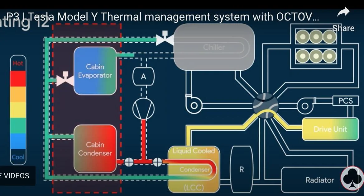

Telsa and Rivian are fundamentally the same. They both use liquid for the cooling/heating loops and have a radiator to air exchange excess heat, and if a heat pump system, to also extract heat from the air.
Tesla has a liquid cooled condenser LCC. The frunk in model y never had a heat issue. The condenser there is located on the firewall. In the rivian the condenser is located up front.
Yup, you can see the R1 condenser/heat exchanger right behind the front grill. Literally same spot as in the cutaway of the Tesla. Was checking out the front of our R1S last night and thought it was funny to have what looks like a small ICE radiator right there. I knew what it was for but that prompted me to start this thread today. That location is an obvious spot if you want it to be exposed to the most effective cooling possible.
The Model Y system is discussed here:
https://insideevs.com/news/452464/tesla-model-y-heat-pump-system-details/
Great article (esp for us nerds). But I think the cutaway is still correct and there's still that radiator (what they call heat exchanger, same thing) at an angle at the front. The Model Y LCC is mounted to the firewall but eventually that is still "cooled" by the radiator at the front. Something still has to cool the liquid....
Correct, but it still has a radiator (lower right below). The LCC transfers heat between loops in the car, the radiator is an air source heat exchanger to dump excess heat, and to absorb air heat in low temp heating mode.
True its still cooled but somehow Tesla's strategy results in a frunk that isn't affected like this in hot weather.
I believe Tesla fan pulls the air towards the ground where the Rivian is pulling the air up, around the frunk tub, and then out the vent holes in the wheel well.
