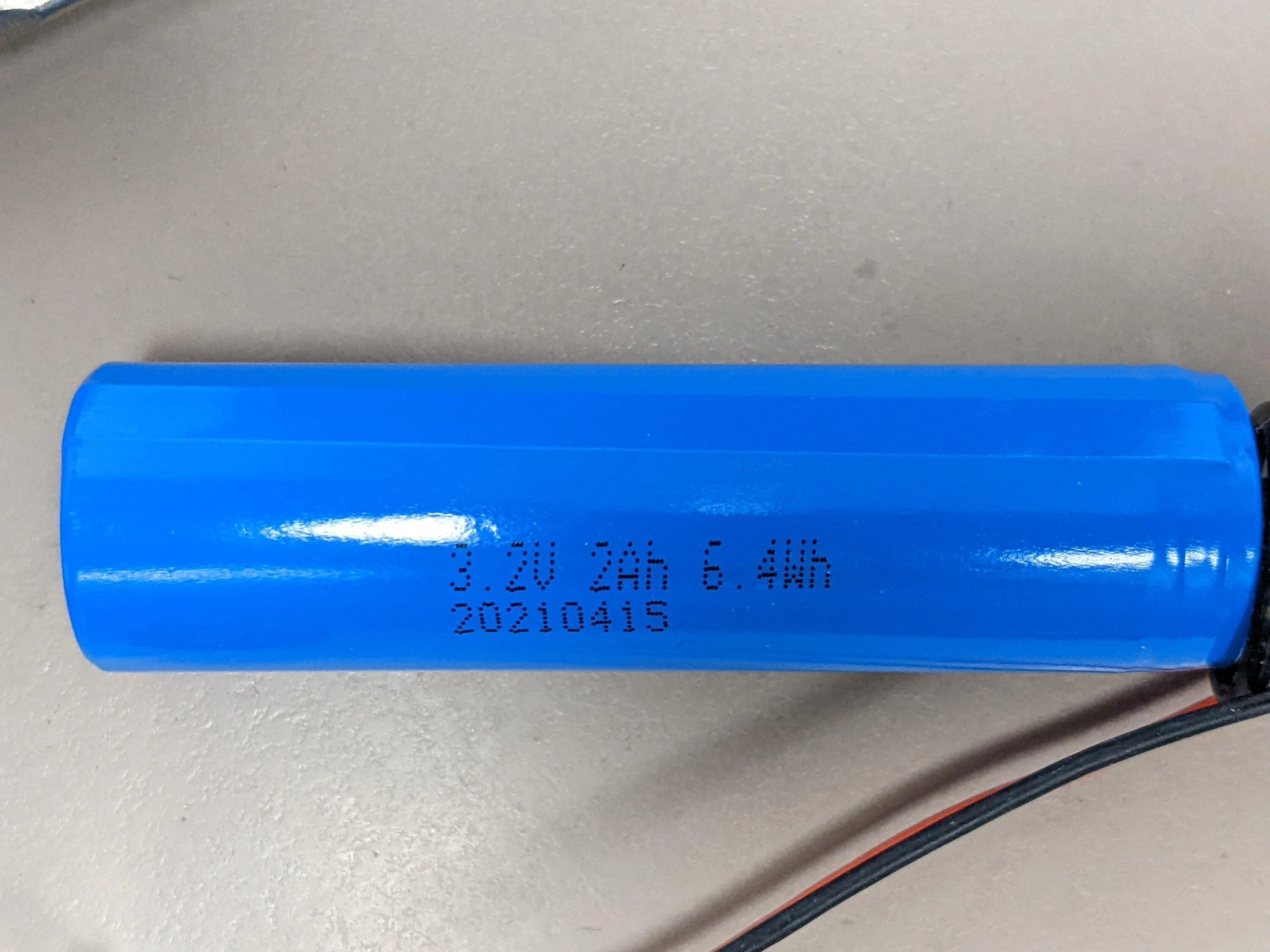

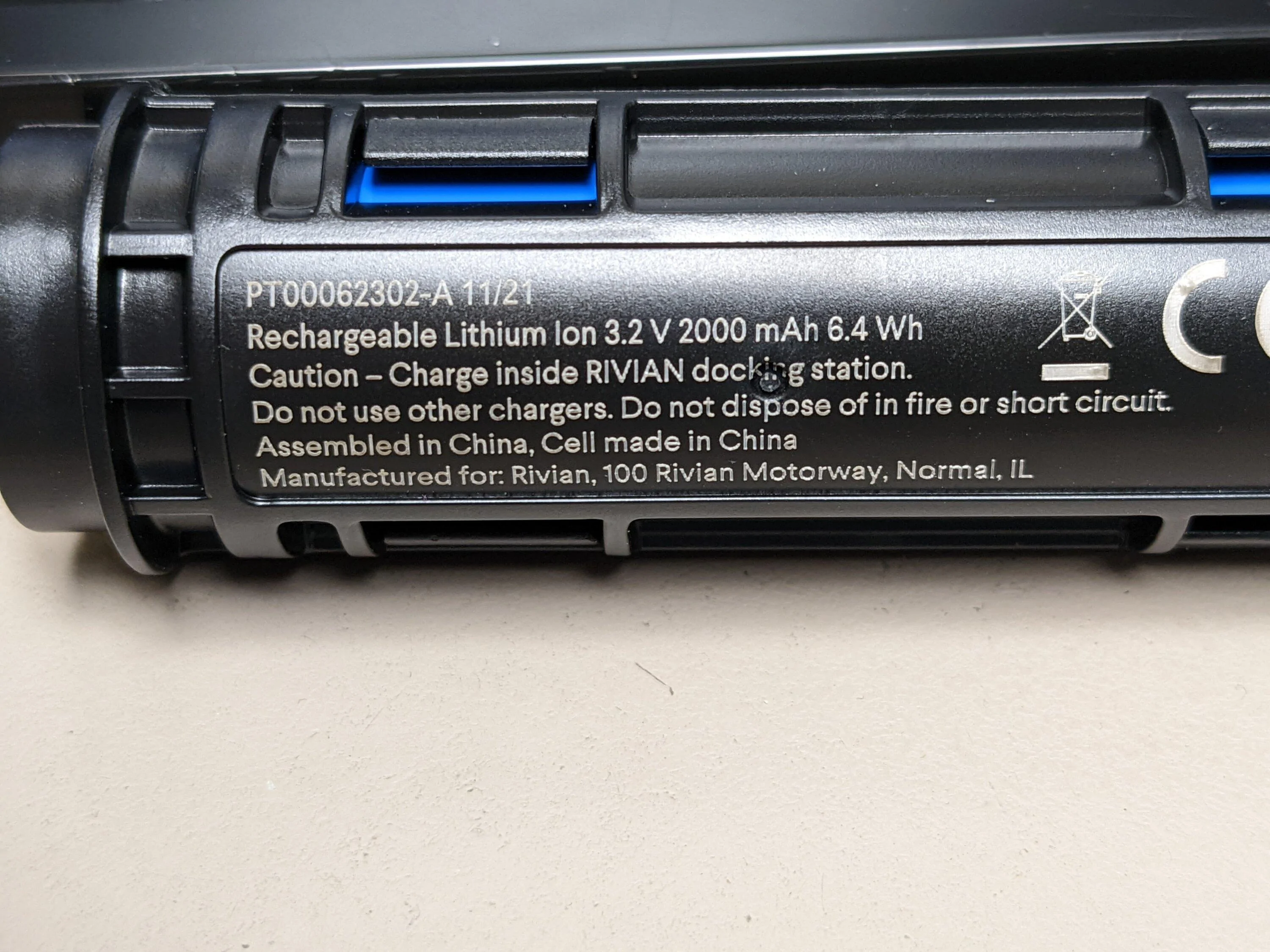

Here’a a Reddit thread discussing the battery in the flashlight. It’s a different size than 21700 and since it’s a 3.2V cell, it’s almost certainly LFP.

I took mine apart. It's not even the same size cell as the ones in the truck battery. 3.2V nominal makes it LFP.
Rivian R1T R1S Flashlight tip PXL_20220519_141710918
Rivian R1T R1S Flashlight tip PXL_20220519_141510441
