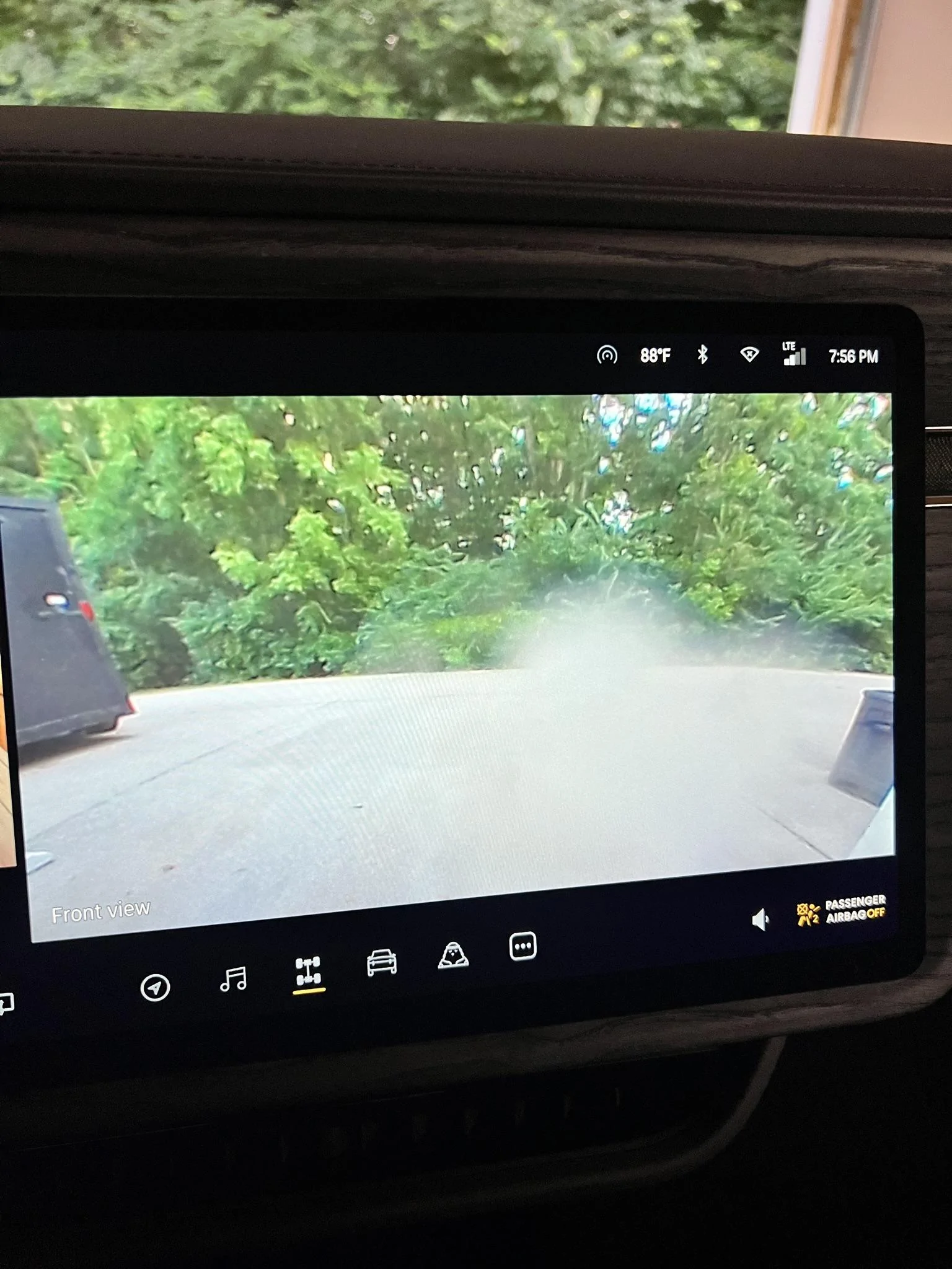

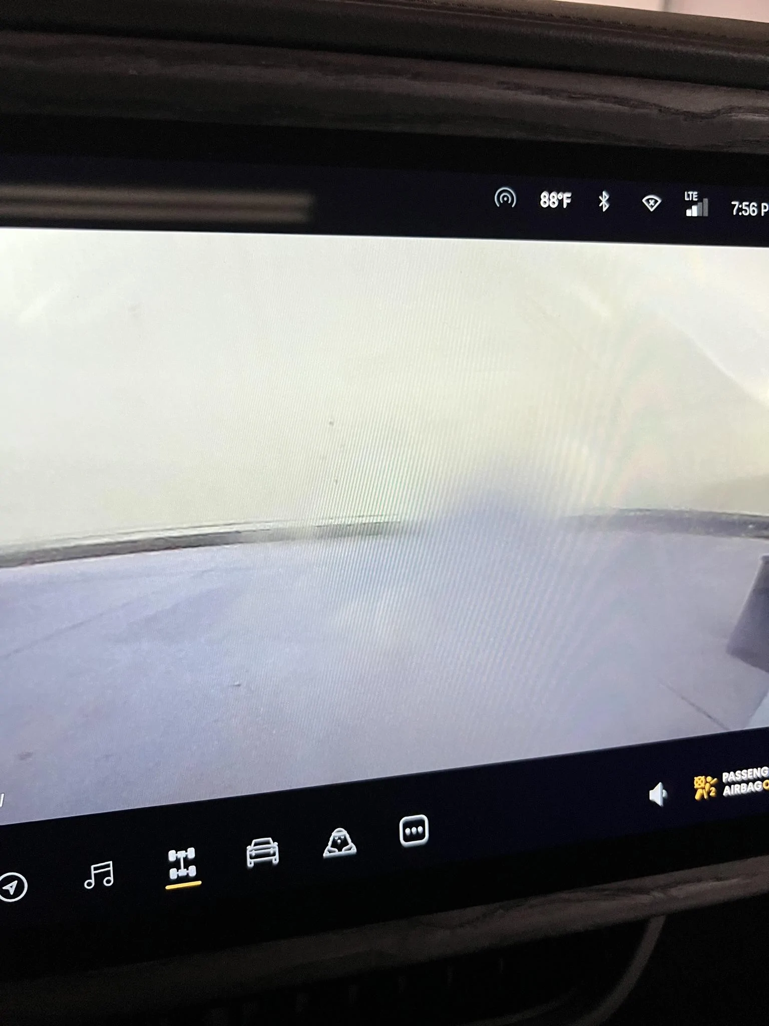

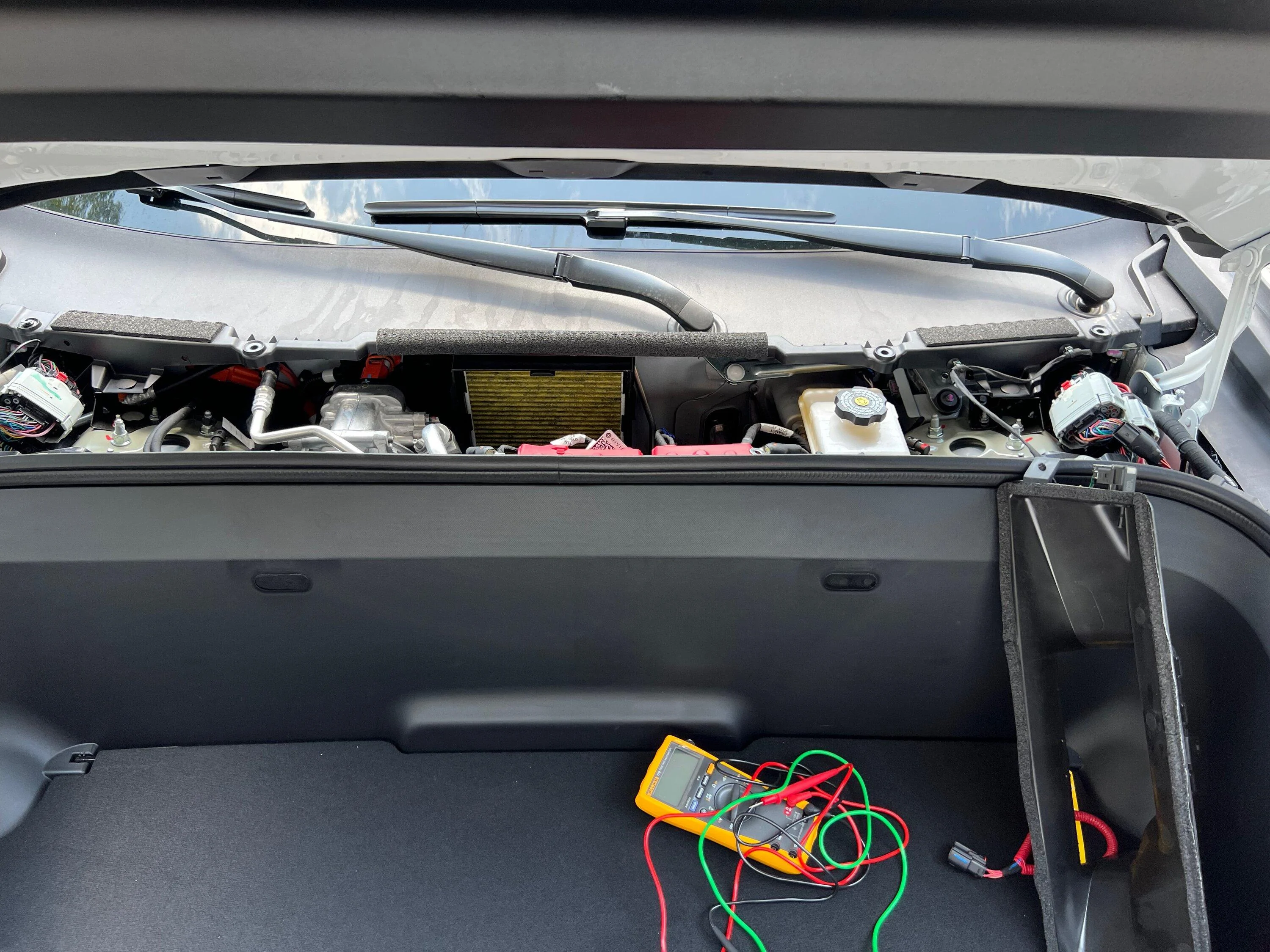

Well, FINALLY got my R1T repaired and delivered. Albeit, it took over a week from the time the repair was complete and several calls with a very helpful and responsive Service Center employee in ATL, to schedule my delivery. Everyone was very professional and helpful.
I had a panel gap issue with the left side gear tunnel and the front camera has a scratch or something that even after cleaning it with a microfiber and widow cleaner, has a blurry spot that is pretty visible when parking. Other than that, it is working well so far. Now its time to catch up with all of you owners who have had yours for a while and help the forums with info.

man when you see multimeters busted out... on a EV Vehicle thats frikken scary....... lol

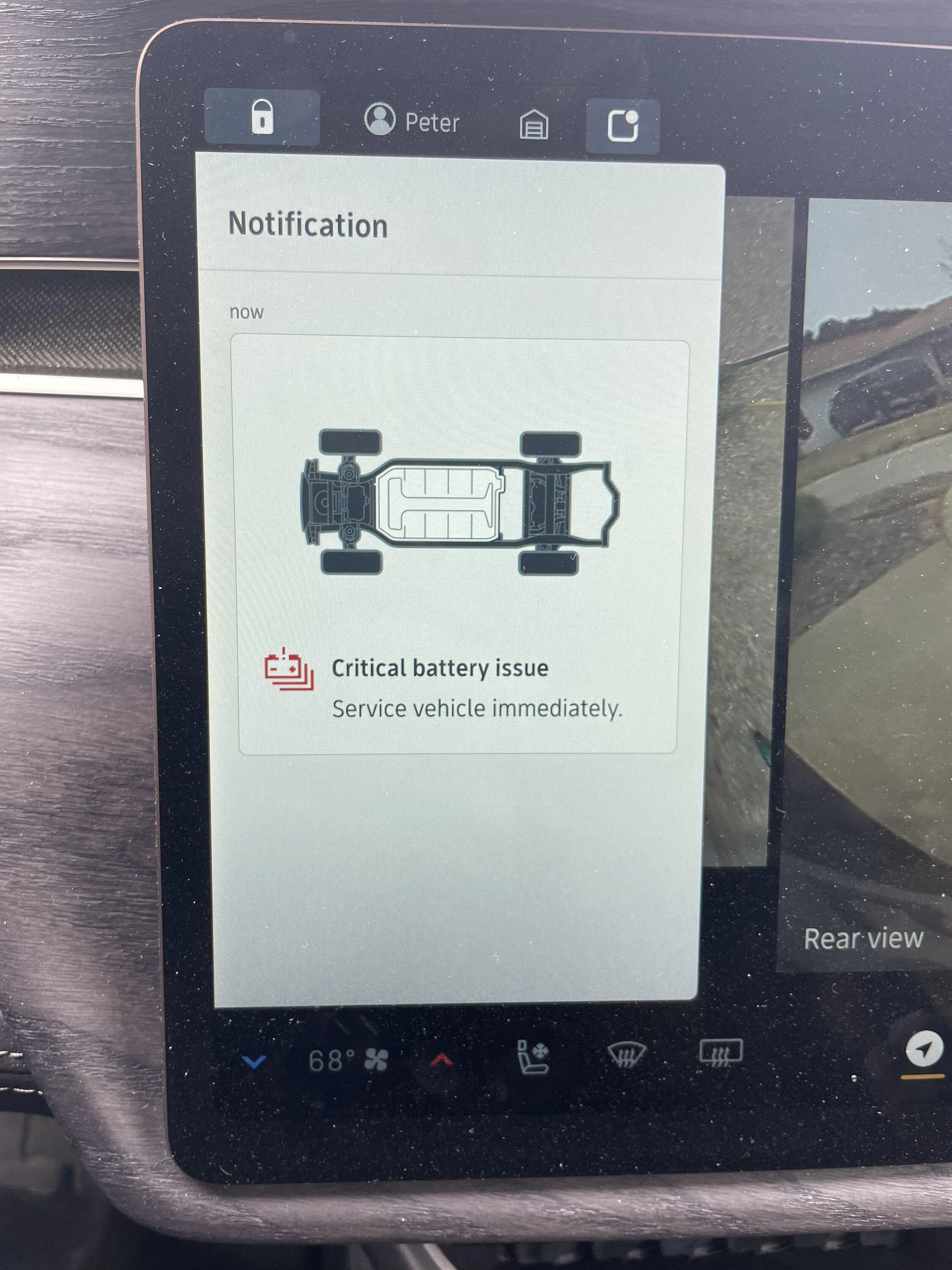

Was this they warning you got? Wondering if I’m getting new battery?

Personally, ill take multimeters over oil collection sumps, timing belt cover pullers, valve feeler gauges and piston ring pliers any day. :)
That is what showed up on my screen. It wouldn’t let me shift into neutral or limp to a parking lot. I was dead in my tracks. Hopefully you can get it fixed without getting a whole new battery. Dang

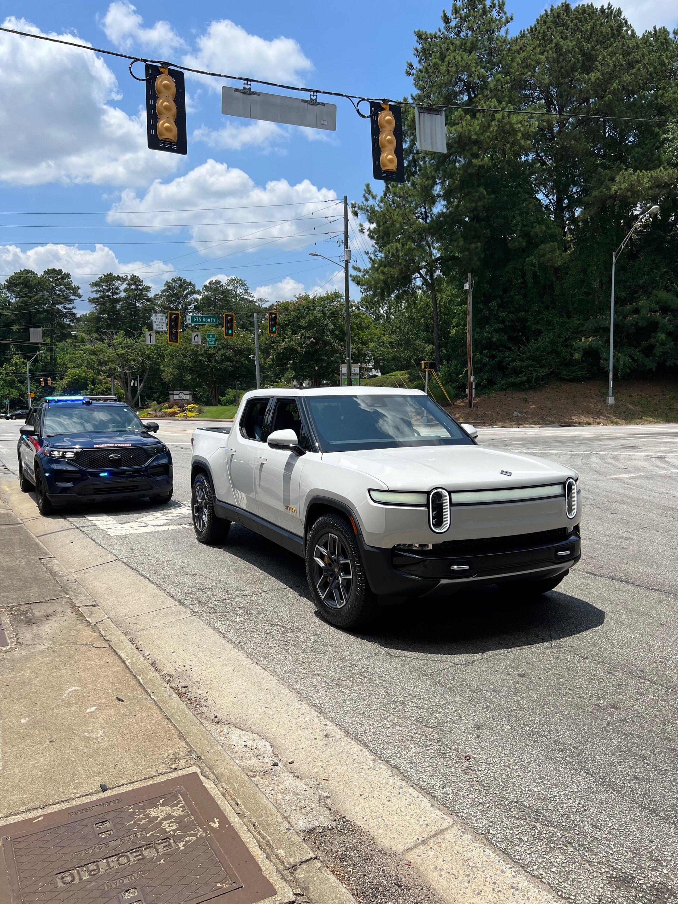

Well, after picking up my R1T in the Atlanta service center, we started our drive back to Nashville...until we got to about 5 miles away and that is when I was in the middle of an intersection turning and a "Critical Battery Issue" alert went off on the steering wheel screen. The vehicle immediately came to a stop and was subsequently stuck in park. I was unable to shift to neutral nor any other gear to move the R1T. We were stuck in the outside turn lane.
I ended up using SOS to call for police presence to control traffic. I also then had to dig through the app to find the roadside assistance, which was able to eventually connect me to the SC that I just left, then dispatch a technician (1 hour) .

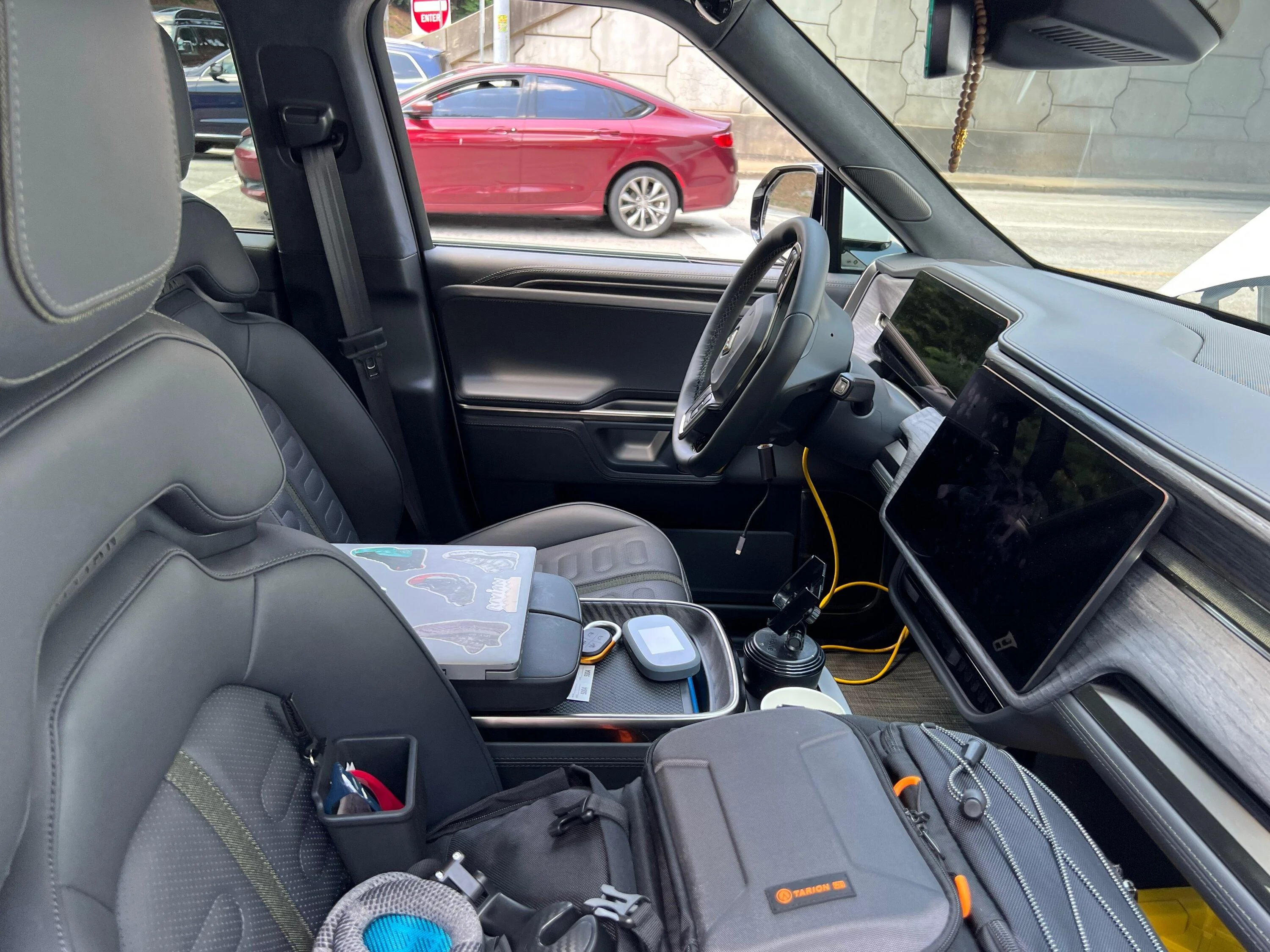

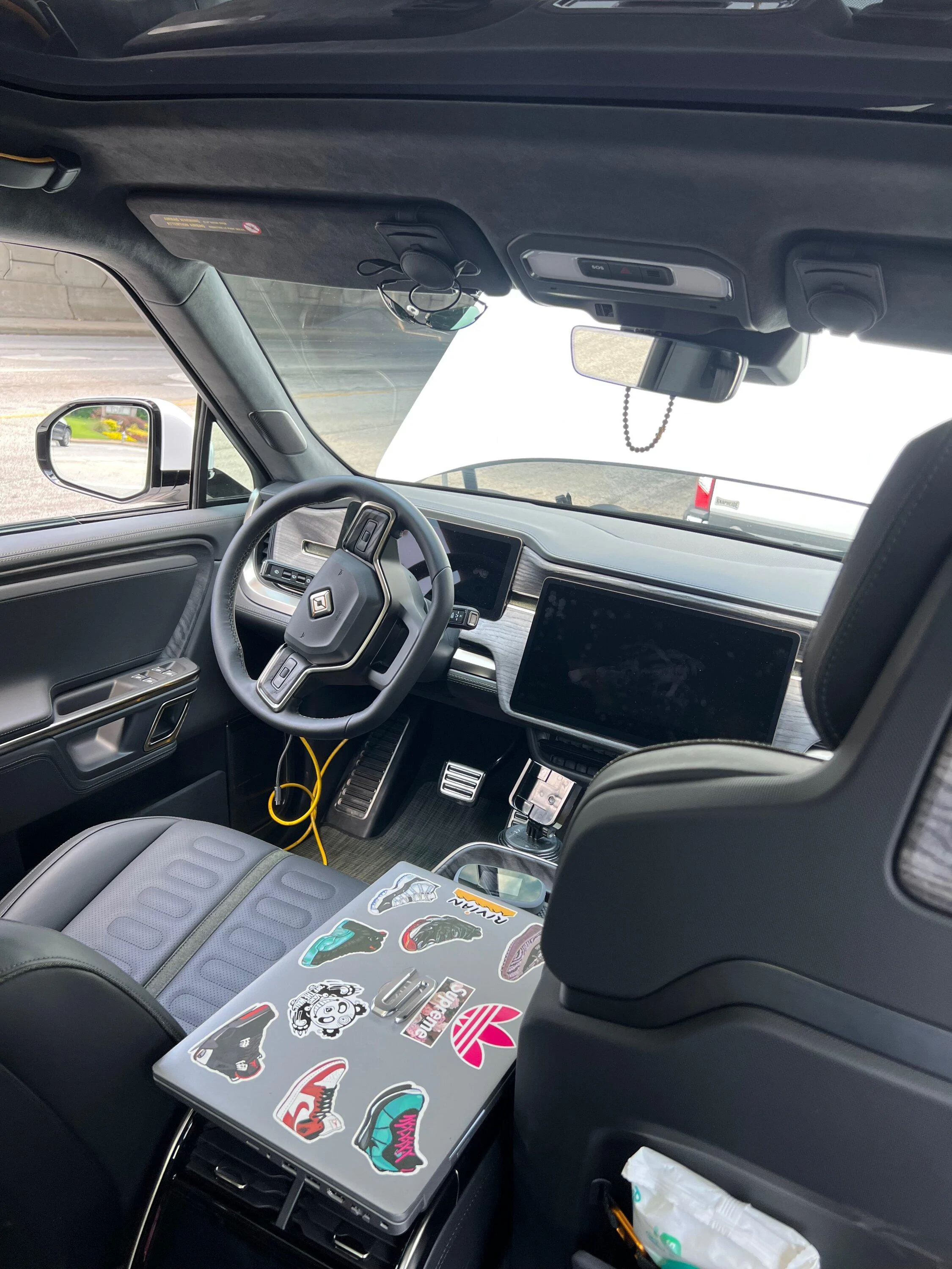

The first technician was unable to get the laptop to connect via LTE, so they sent another tech with another laptop, which resulted in the same negative connectivity. I had performed about 5-6 software resets and another type of reset where I walked away from the vehicle about 50 feet away to avoid any of the keys, phone, or FOB to interfere in the reset. Nothing.
After about 30 more minutes, the two techs were able to hard unlock the brake system and push the R1T backward to the nearest gas-station to prepare for a tow trailer. The SC did seem to take it seriously, as my wife was able to get an uber back to the SC to relay the issue. She was able to take an Uber back to me, and the SC manager shortly followed in his own R1T. We attempted to cross load as much of my personal gear, car seat, and effects over to the manager's vehicle, but none of the gear tunnel nor tonneau, or tailgate would unlock, thus some of my stuff was stuck till they could bypass it. And I had one of my pistols in the center console, which locks with the vehicle, so I had to wait until that was unlocked as well.
While this was all going on, the SC was working on getting a tow and a rental vehicle for us. After about another hour, while back at the SC, they decided to let us use the manager's R1T as a loaner, and stated they would begin fixing the R1T on Monday and once complete, deliver it to me in Nashville. I am still waiting to hear what is actually wrong, but the critical battery error seemed to redline the whole truck.
I feel that the technicians and managers were doing their best and were respectful/picking up on our obvious disappointment. Moreover, I was a bit frustrated that I paid for a hotel the night prior to picking it up (5 hour drive) and invested well over 12 hours in breaking down, getting techs dispatched, getting a ride back to the SC, getting a loaner, and then driving a half fueled R1T back to TN.
