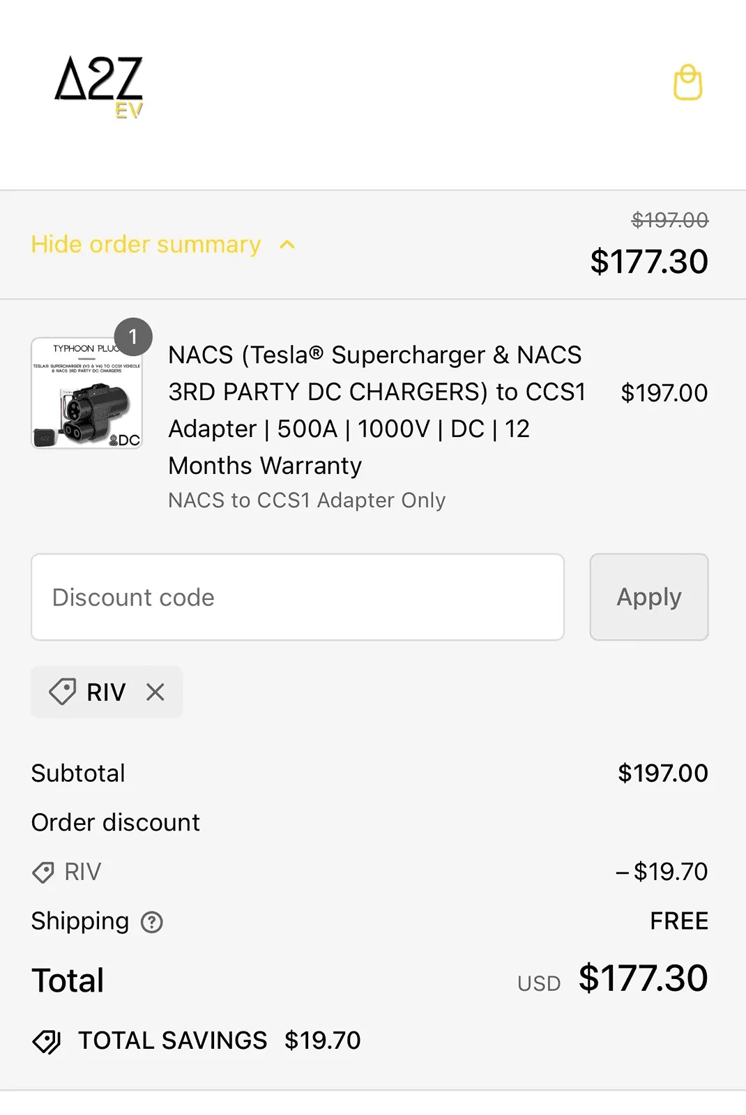

You need a level 3 charging adapter (1000 volt / 500 amps) instead of the level 2 charging adapter (60 amps) you currently have.
The only one I would recommend that is shipping out and has been reliable for Ford / Rivian customers is the A2Z adapter.
You can get it $177 shipped after the "RIV" discount code has been applied.
A2Z EV Link - NACS (Tesla® Supercharger & NACS 3RD PARTY DC CHARGERS) to CCS1 Adapter | 500A | 1000V
You can always call them after you've placed your order to upgrade to expedited / overnight shipping for $15.
You still have to wait 3 weeks for the order to ship but once it ships, you should get it in couple days.
