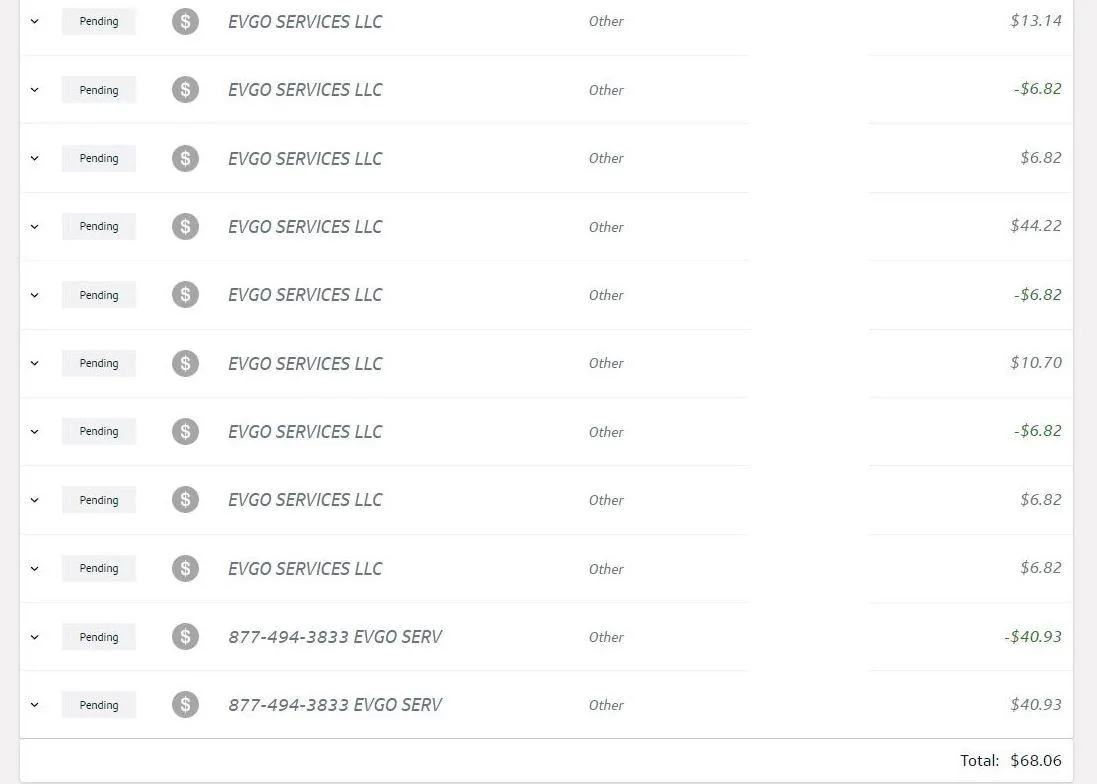

As a cybersecurity professional, I want to alert the community that EVGO, its app and chargers have some major security flaws and I would recommend not using them until these issues are addressed.
I was excited by the EVGO integration in the last update and signed up for an account. I registered my R1S's VIN on the account and entered my credit card details.
When I arrived at the charger, I plugged in but the autocharge+ feature didn't work. I tried several times and located the charger in the app and tried to start it from there. After several attempts as well as trying to use a credit card, it eventually started. I went for lunch. When I returned and hour later I checked my CC account and there were several charges and 2 separate charging charges - 1 for 10.70 and 1 for 44.22. Both were from the exact same time period (overlapping). Today, back at home, with the car in my garage, I got a charge on the CC that I was charging again (150 miles away). I opened the app to see the charge ongoing.
When I called EVGO they were very apologetic but the rep could not really do anything but stop the existing session and open a ticket with their 'backoffice'.
Some things that concern me coming from a cybersecurity perspective:
1) The chargers did not recognize my car even though it was registered as they claim it should have.
2) There is a non-interactive UI at the chargers so you don't know what is happening and can only control it from the app which is largely unresponsive.
3) The app has extremely poor UX and apparently can get miss-synced with or hijacked by another vehicle without warning or notice. I still cannot see what car is using my account. The claimed 'VIN recognition' is clearly not real.
4) The app does not have strong authentication and no option for MFA.
5) Others have claimed on the web that accounts are easily hijacked with just username and email. I haven't tested this as it would be a crime but beware.
6) Multiple CC charges are made frequently instead of just for the usage (see attached). This is confusing for users and you can miss an overcharge.
7) You cannot leave the service, remove your Credit Card, or close your account even if you call them. Apparently 'only the backoffice' can do any of these.
For now, until they get these issues resolved, I would avoid this app and service. I will give them a week to resolve the charges and then contact my credit card company.

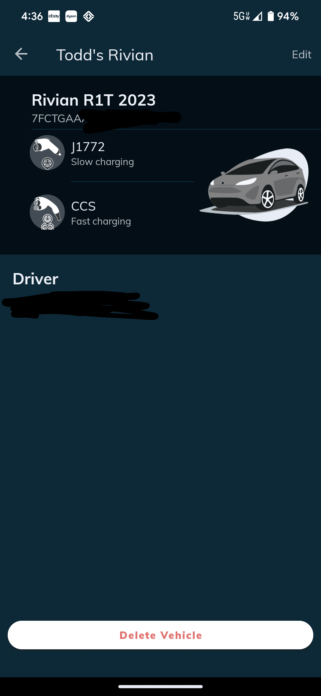

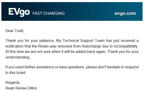

I oversee and manage cyber, infrastructure and technology security teams. We specialize in financial institutions and investment firms. I won't get into the alleged compliance violations as they are likely inaccurate and I do agree (heavily) with ethical disclosure instead of putting things on blast publicly.
I'm just here to drop some news that I was told. I went to use autocharge+ the other day and it didn't work, furthermore it was removed from my account. I reached out to EVgo and was told the following. Take it as you wish.
Rivian R1T R1S EVGO Warning - insecure service 1695506256762
Edit for a bit more context: When Autocharge+ didn't work I called them and they asked me to remove and re-add the vehicle. Once I did this it never gave me the option to setup autocharge again. That's when she filled a support ticket and I received the above response.
I forwarded the email chain to my guide in hopes (but don't hold high hopes) of a confirmation from Rivian. I'll respond when I hear from them.
I'm just here to drop some news that I was told. I went to use autocharge+ the other day and it didn't work, furthermore it was removed from my account. I reached out to EVGo and was told the following. Take it as you wish.

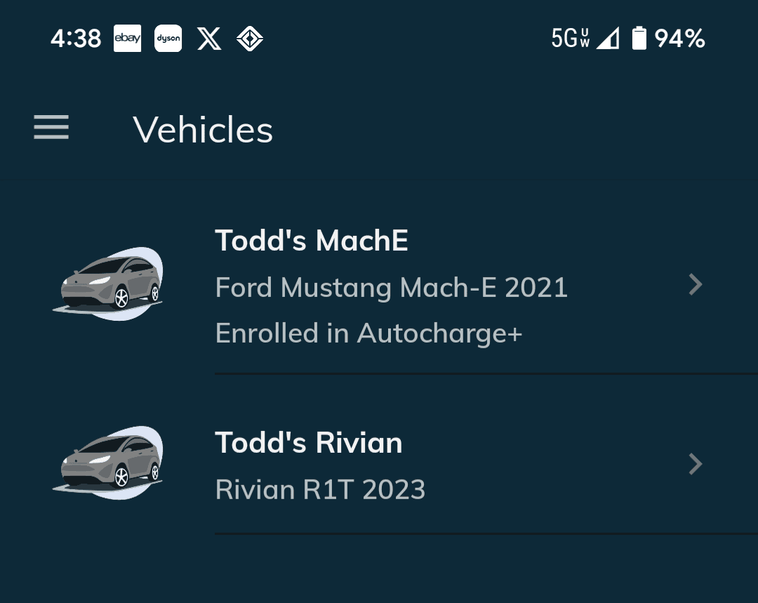

Just curious when you tried to use it. Mine still shows on my account, it was last used on 9/13 with no issues.
DevSecOps
Todd
Apr 16, 2023
177
423
Sacramento, CA
2023 R1T, 2023 M3P, 2021 Audi SQ5
CISO
Last Thursday - 09/21
Here you can clearly see it's not an option either:

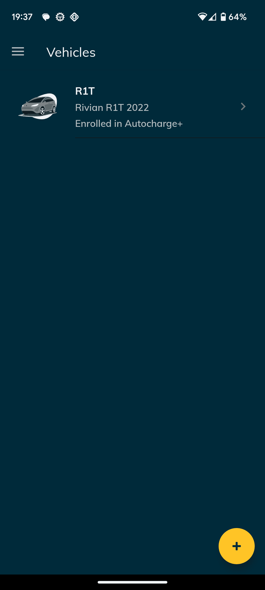

VSG
Oct 3, 2022
3,522
6,739
R1T LE/RB/OC/20
My vehicle still shows up as enrolled.
Rivian R1T R1S EVGO Warning - insecure service Screenshot_20230923-193728

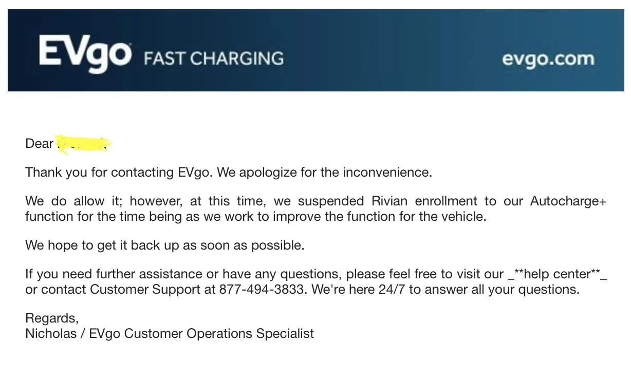

My R1T has been in "pending" mode for Autocharge+ for weeks now. I went to an EVGo station again today to try to finish enrollment, but was getting error codes and messages from the EVGo app. I called EVGo and they had me connect the truck to a charger and start charging. After a short charge, the service rep claimed my R1T was now enrolled in Autocharge+. However, hours later, the EVGo app still shows the R1T as "pending" for Autocharge+. If Rivians are really not supported for Autocharge+, it sure would be nice to let their help/service support folks (and customers) know.
AllInev
Nov 22, 2021
38
1,269
2,129
Oakland, CA
Prius V, 2022 R1T
Just got this message from EVGo, so it seems they've suspended enrollments in Autocharge+ until further notice.
