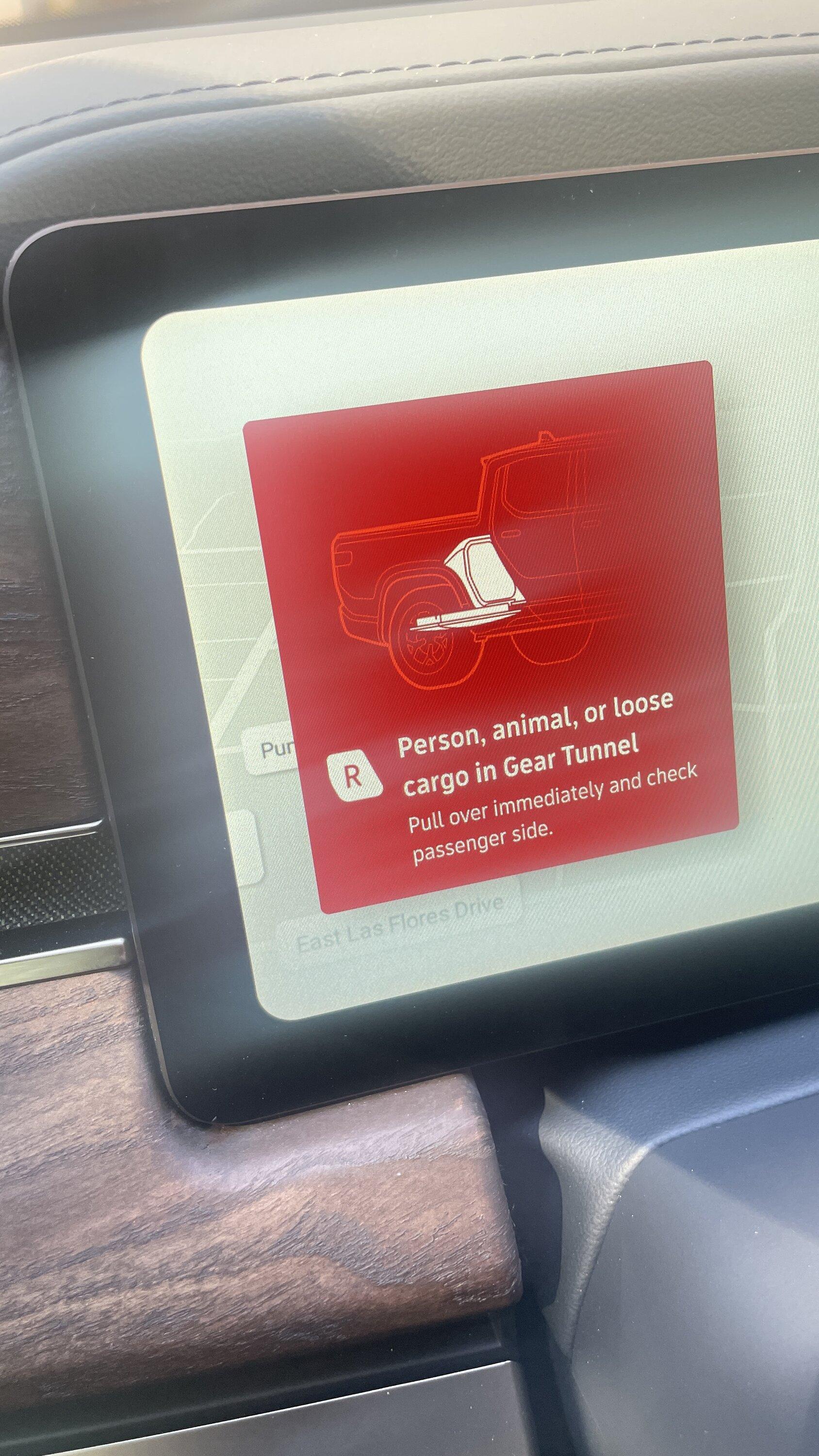

I got in the car and had this oddly specific error message. My truck is so new I haven't even put anything in the tunnel yet. I opened and closed the passenger side gear tunnel door and it went away.

I've had this on my left gear tunnel door since April. They've "fixed" it before, only for it to come back after some off-roading and mudding. They're now ignoring my new service request.

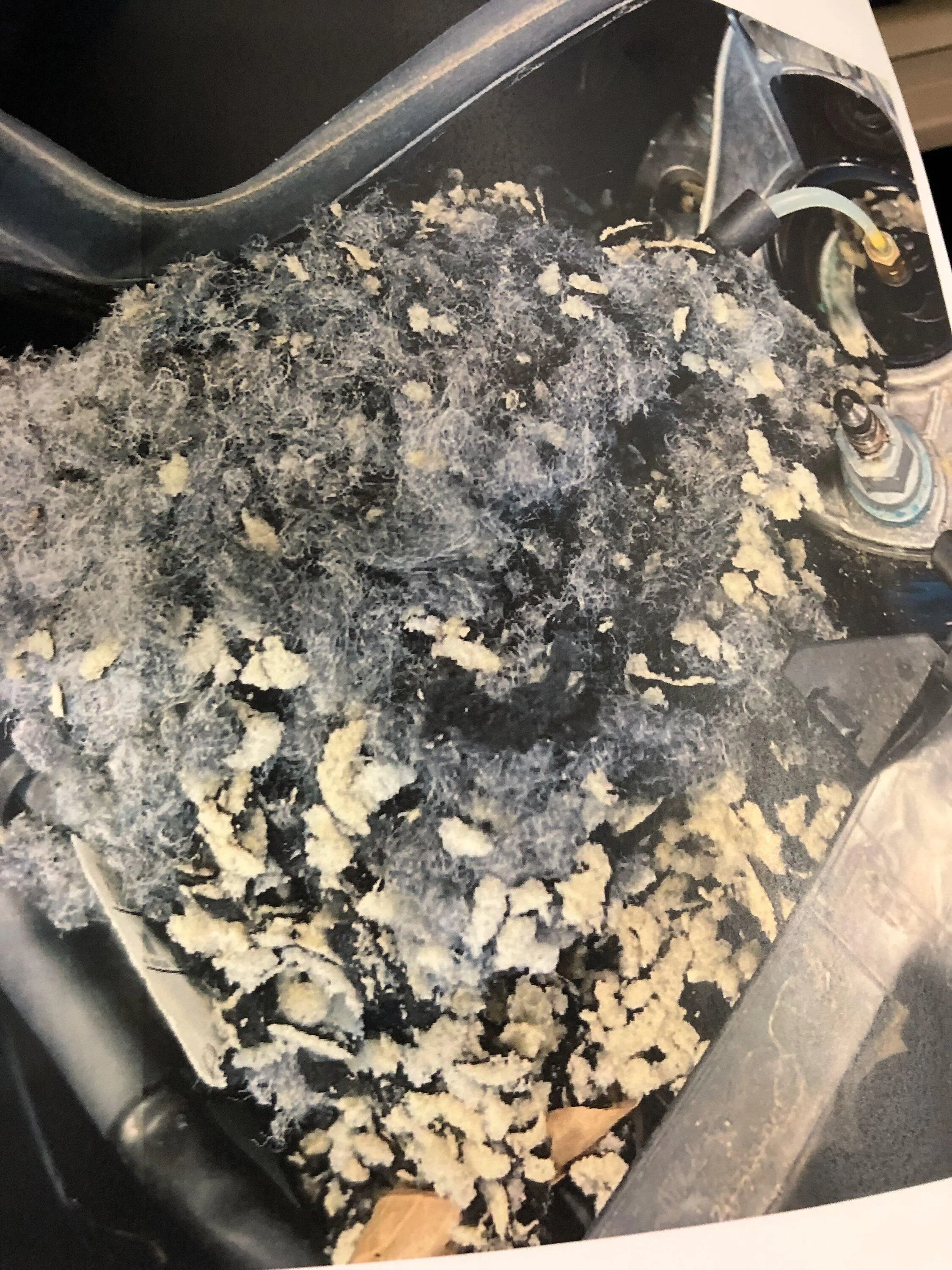

did you live in the country? Here's what I found under the hood of my GLS after storing it over the winter...
Haha. I don’t but we do have some enterprising squirrels that I’m always trying to keep out of my old Land Cruiser.
Error
I got that once. I had a stadium chair and a bag in there that didn't appear to have moved much. It went away quickly so I didn't worry about it.
I got it on my second drive without having ever opened that door or used the gear tunnel.
