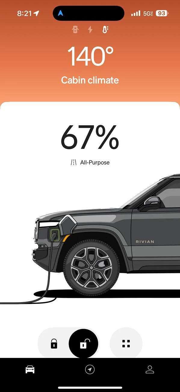

Went to my app to unlock the car and noticed the high temp icon, the same one that you see when the car is parked in the sun. It showed the interior was 140F. Opened the door and it was normal temp inside. Asked the Rivian guy and he said oh reboot your app. Did that and it showed 140F. They took the car back in and said it needs a new interior temp sensor. They said we can give you the car back and call you when the sensor is delivered. I asked, doesn't that sensor control the interior fans and climate control? The guy said yes, so your HVAC might not work right. I said please keep the vehicle until it is fixed.

warm. I've never attempted to max mine out, but running defrost on high for close to an hour when it was around 0F outside left the cabin in the 95F range.

It was maybe 60F outside and interior temp was about the same. I thought maybe they just forgot to plug the sensor back in since they were working on the system, but I was told that it needed a new sensor. You would think this is something that would instantly pop up once they plug in the computer to check everything out, but I guess not. Rivian offered to deliver the vehicle back to me once this is all done, but honestly the reason I want to pick it up in person is in case something like this happens.
