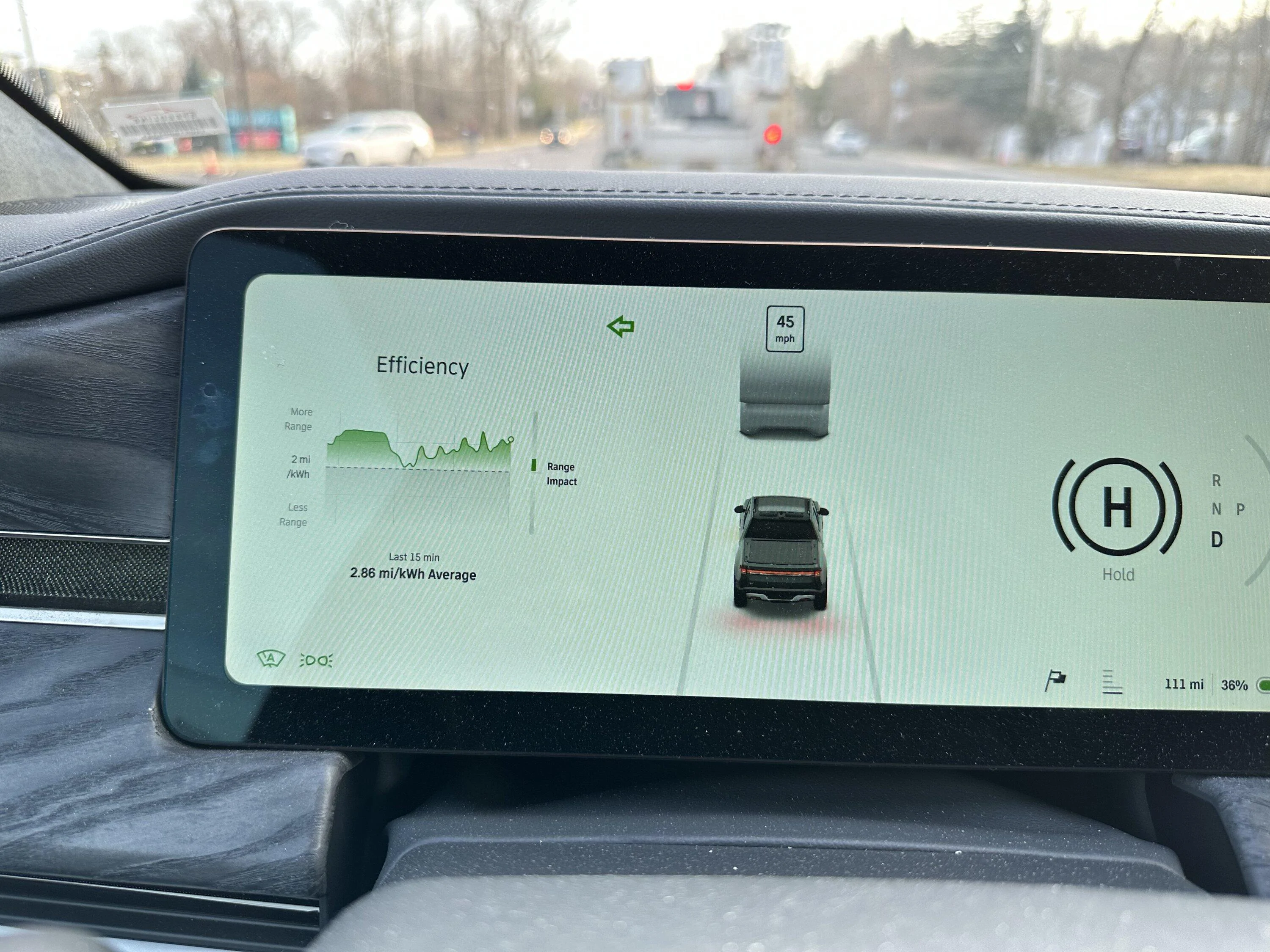

So I’m further north than you, same coast.
Here’s my last 15min in sport:
Rivian R1T R1S Efficiency secrets? 44D6CA57-0D4E-48F4-A478-05E5CD21CF4A

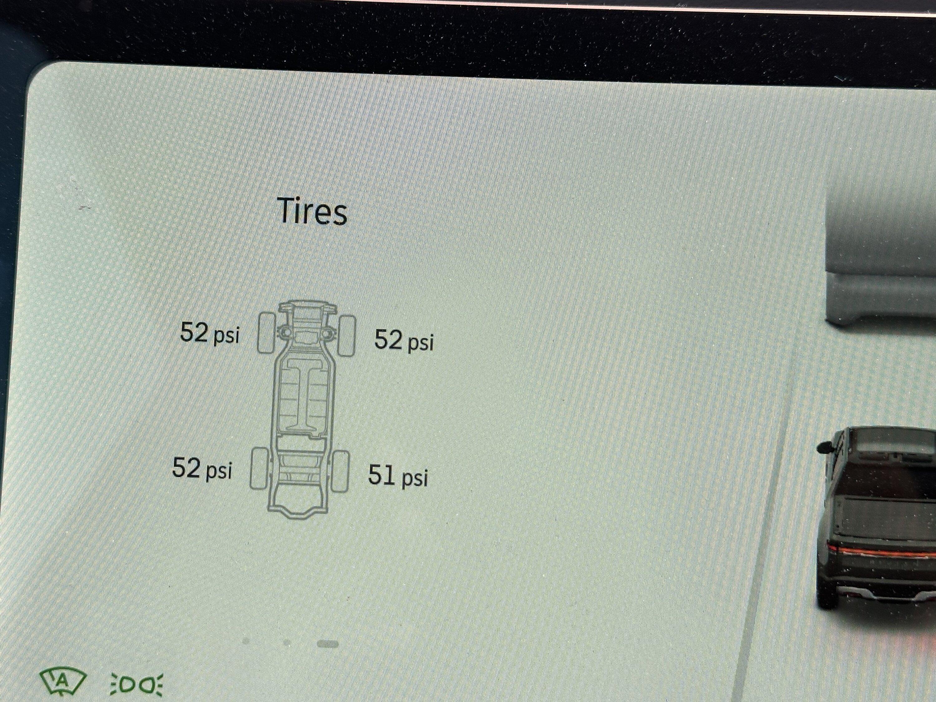

Efficiency tip #1:
Rivian R1T R1S Efficiency secrets? 595B863C-DC14-4D86-AAC3-82B4B2A75DDA
50psi cold.

This is what I've found as well. I started seeing reduced numbers and thought 45 psi wasn't that big of a deal. I aired everything back up to 48 cold and got a noticeable increase in efficiency. I have been disappointed with Conserve mode, not really noticing a huge difference vs. AP low. The projected mileage at destination is different but when you get there it's not.
