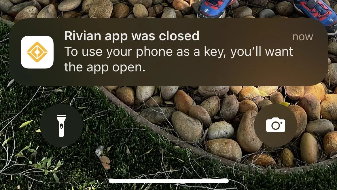

I think there may be some difference in what people understand as the app being "open". To clarify, at least based on my experience:
App Open in forground - this obviously works.
App Open in background - when you swipe up to close the app, it's not "Closed", it's in the background but still running. It still works PAAK.
App Closed - This is when you "Kill" the app by swiping up halfway, and then swiping up AGAIN to kill the app. At that point you should get the following notification, but I have seen it not always notify.... When the app is killed, PAAK does not work - it should not work, unless there is some bug......
TLDR, the app can be in the foreground, or hidden in the background, and PAAK will work.

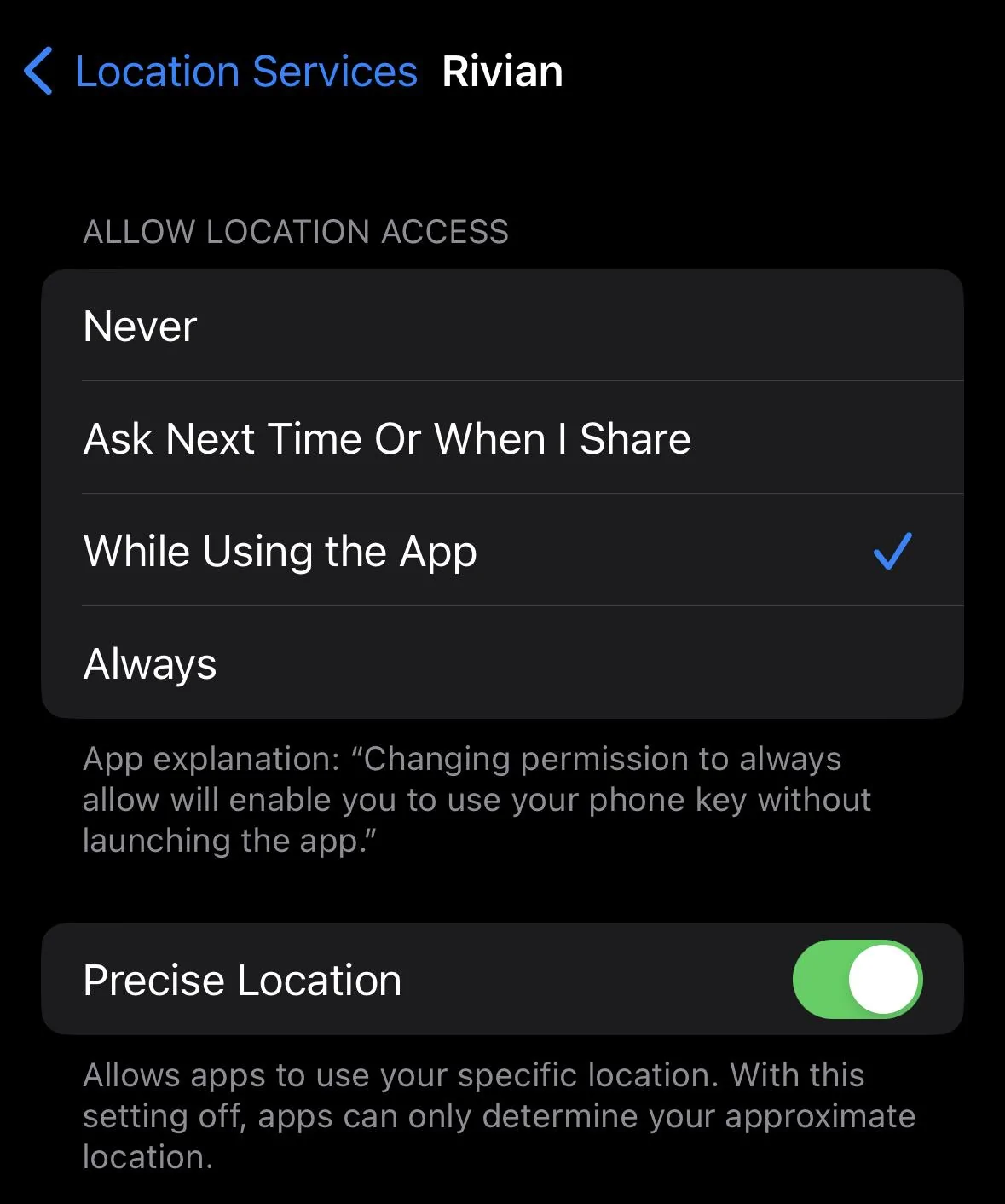

Is this an iOS Privacy & Security -->Location Services setting issue?
I have mine set to "While Using App." That way I can quit the app on my iPhone walk around my carport and backyard with my phone in my pocket in peace without the car waking up, lighting up, unlocking, etc.
If set to "Always" the the truck wakes up and unlocks or the rear taillights always blink as if it's pinging my phone whenever I walk around with my phone on me - whether the app is launched, in the background, or fully quit.

Why not just turn off proximity lock for your home location?
Because it's pretty easy and convenient for me to launch the app, walk out to the truck, and let proximity lock do its thing. This time of year, I'm regularly launching it anyway to pre-cool in the desert heat.
It's now routine for me to quit the app when I walk into the house as well.

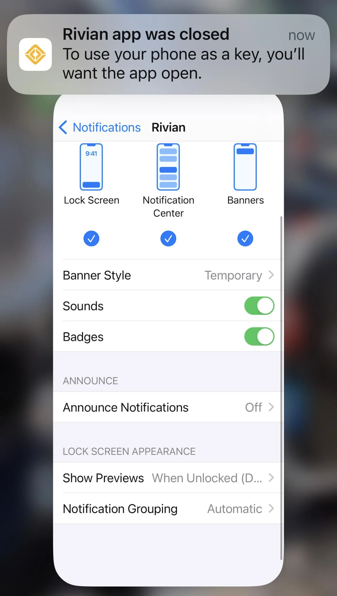

If you swipe up on the app in IOS it is closed and won’t function as a key. It even gives you a warning notification that the app is closed and your phone is no longer a key. I’ve played with this many times and you can stand around next to the truck all day long looking at your fully connected bluetooth connections and the truck will not unlock or do anything else.
