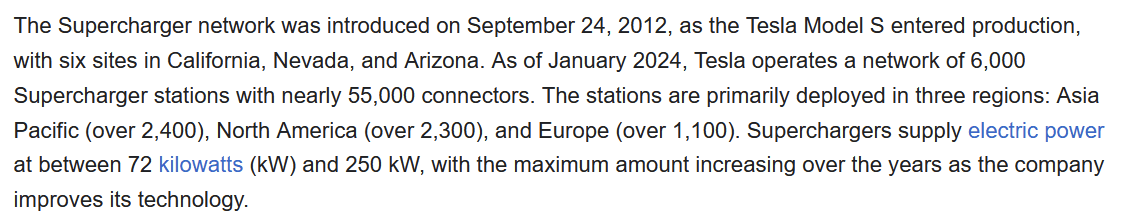

Superchargers in Europe use CCS ironically
Can all Tesla vehicle owners use the Supercharger network in Europe?
Yes. The Supercharger network is available to all Tesla vehicle owners.
All V3 Superchargers in Europe feature single-cable CCS technology that is compatible with every Model 3, Model Y and Model S or Model X vehicles built in May 2019 or later. To access V3 Supercharging with a pre-May 2019 Model S or Model X vehicle, request a CCS Combo 2 Upgrade quote from your local Service Center.
All V2 Superchargers in Europe feature dual-cable posts to accommodate both DC Type 2 and CCS Combo 2 charge-ports.
https://www.tesla.com/en_ie/support/charging/supercharger

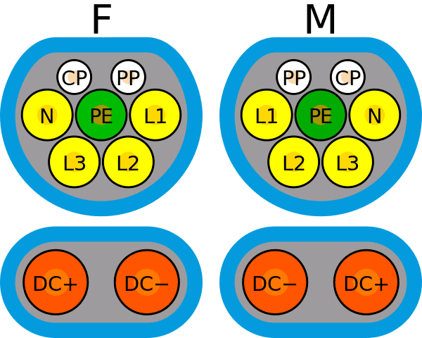

NACS would be just as crummy as CCS1 in the EU because neither supports 3 phase. That's why the EU made them use CCS2 also. Honestly, NACS as a long term connector is a mistake. We could all get potentially faster Level 2 AC at the same amperage. Most big commercial buildings already have it available.
NACS supports 277v charging on non transformed 480v 3 phase. That means a 13.3 kw charge rate at 48 amps vs 11.6 on 240v and only 10lw on 208v three phase.
I the vehicle has to support this as well which I believe newer Tesla vehicles do. This is a huge benefit to commercial installations in the US as they will be able to install chargers directly to their 480v service vs using transformed power. Should lower the cost for them and provide more EV charging options. Plus it's a faster charge.
The 208v is why charging is so much slower at L2 in many business locations. BTW to get kw you multiply voltage by amps. ?
I don't know much about EU power so this is just for the US.

277v is still single phase into the EV unfortunately but you are correct that there's increased kWh due to the higher voltage with the same amperage. A nice perk.
An EU type 2 connector has provisions for three phase directly into the EV. 3 phase is readily available at many residential properties in the EU. The same 60A breaker size can yield 40-50kw without expensive DC conversion equipment.
