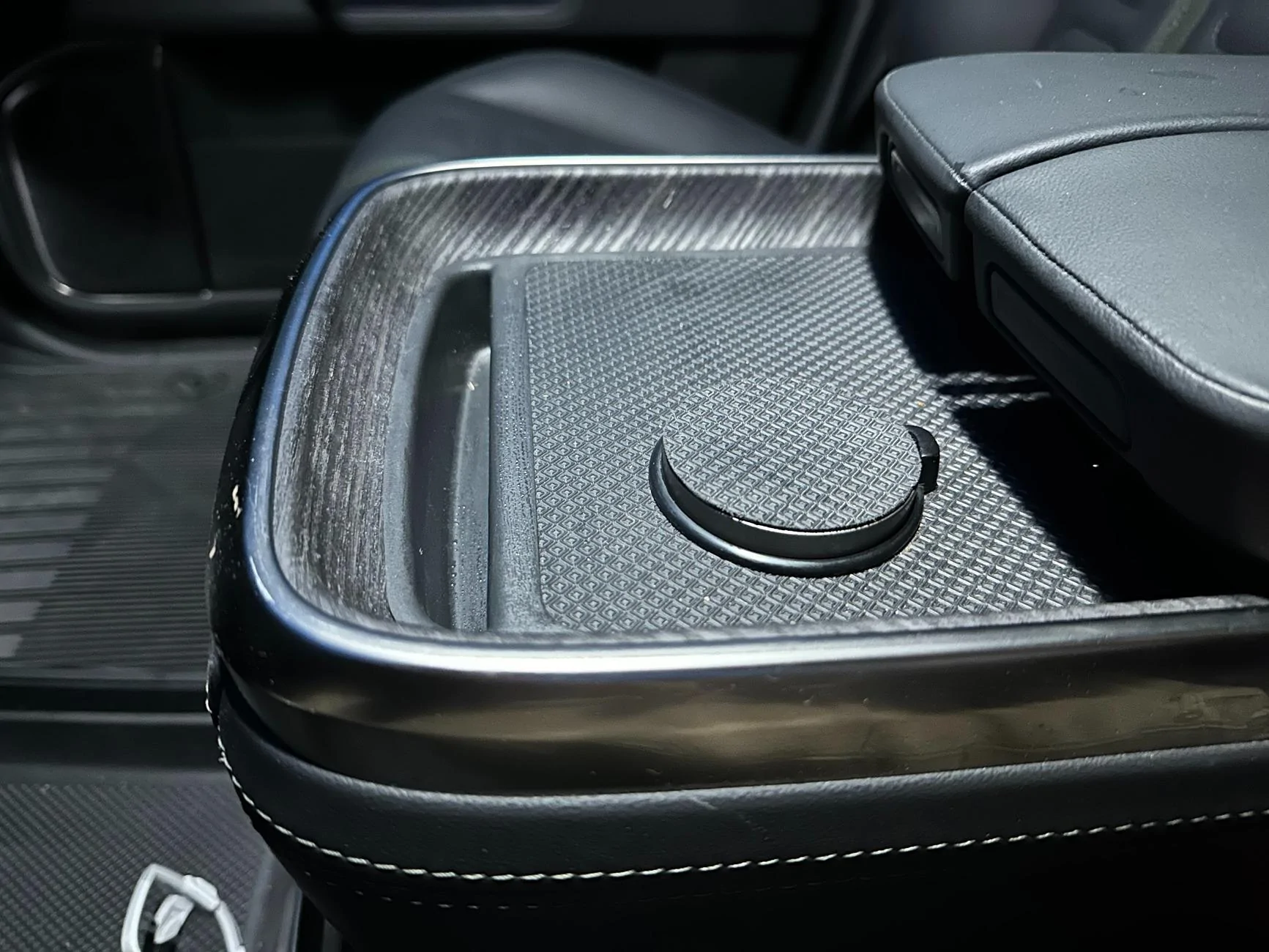

I really like the mini logo rubber mat, but I like chargers that charge too, so down to the workshop I went.
  • Cut a hole the size of a Qi2 charging puck.
  • Routed out a slot in the underside of the mat for the flat usb-c cable (plugs in to usb-c in center console).
  • Sanded the bottom of the rubber cut-out to allow magnet and charging to pass through more easily.
  • Attached cut-out in place of the glass top layer of the Qi2 puck (removing existing glass was a pain due to adhesive).
  • 3D printed (ABS) a trim ring for a clean transition to the pad.
Happy with how it came out, may take another pass at the trim ring, or I'll forget it exists and enjoy my working charger, time will tell.
