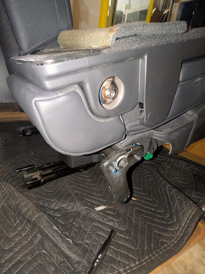

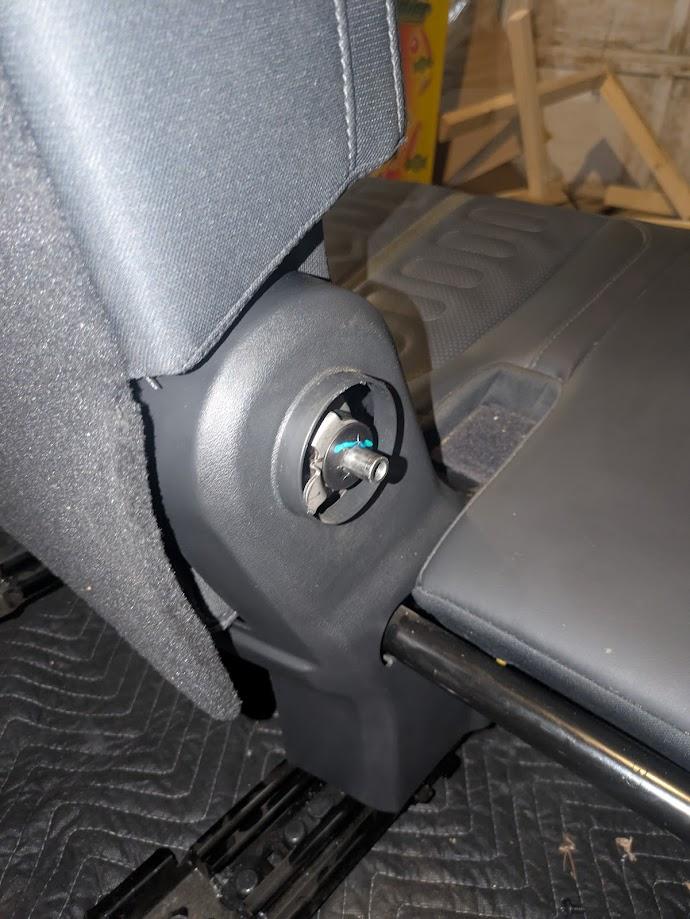

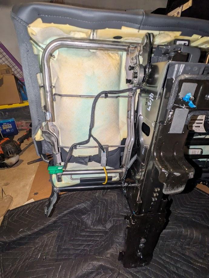

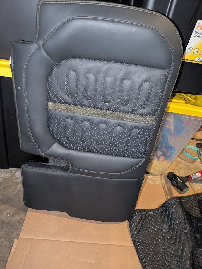

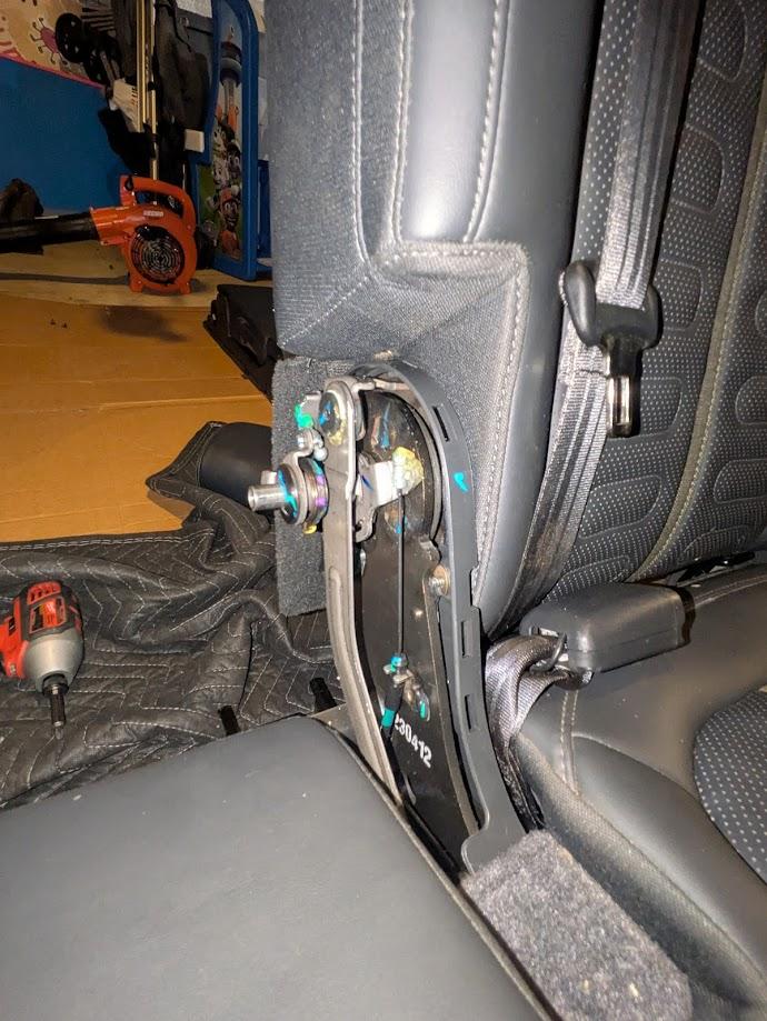

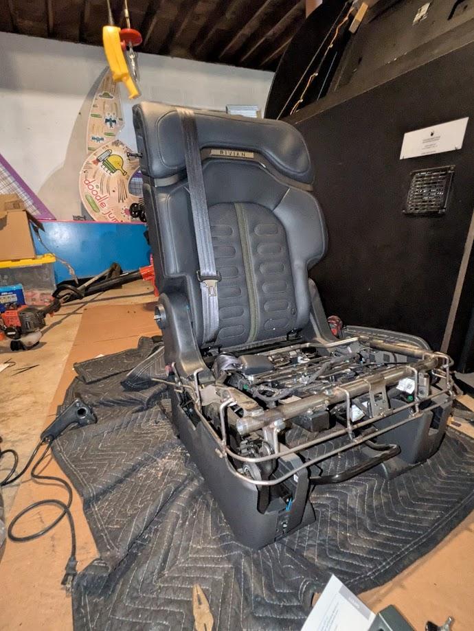

We recently purchased an R1S after owning a Model X for the past 4 years. With 4 kids (ages 7, 5, 3, 1) in car seats, the poor design of access to the 3rd row is a pain. I was surprised that I could not find anyone who has tried to modify the 60% seat to remove the center portion to create an aisle in the middle row...surely someone has already done it?!?! But since I could not find anyone who has already done it, I figured I would give it a shot and take pictures along the way. If you have done this (or know of someone who has) I would love to see build pictures to learn from someone else before I start cutting the seat frame.
I started this evening and I will plan to post updates as the work progresses. Cheers to starting something without a fully formed plan!

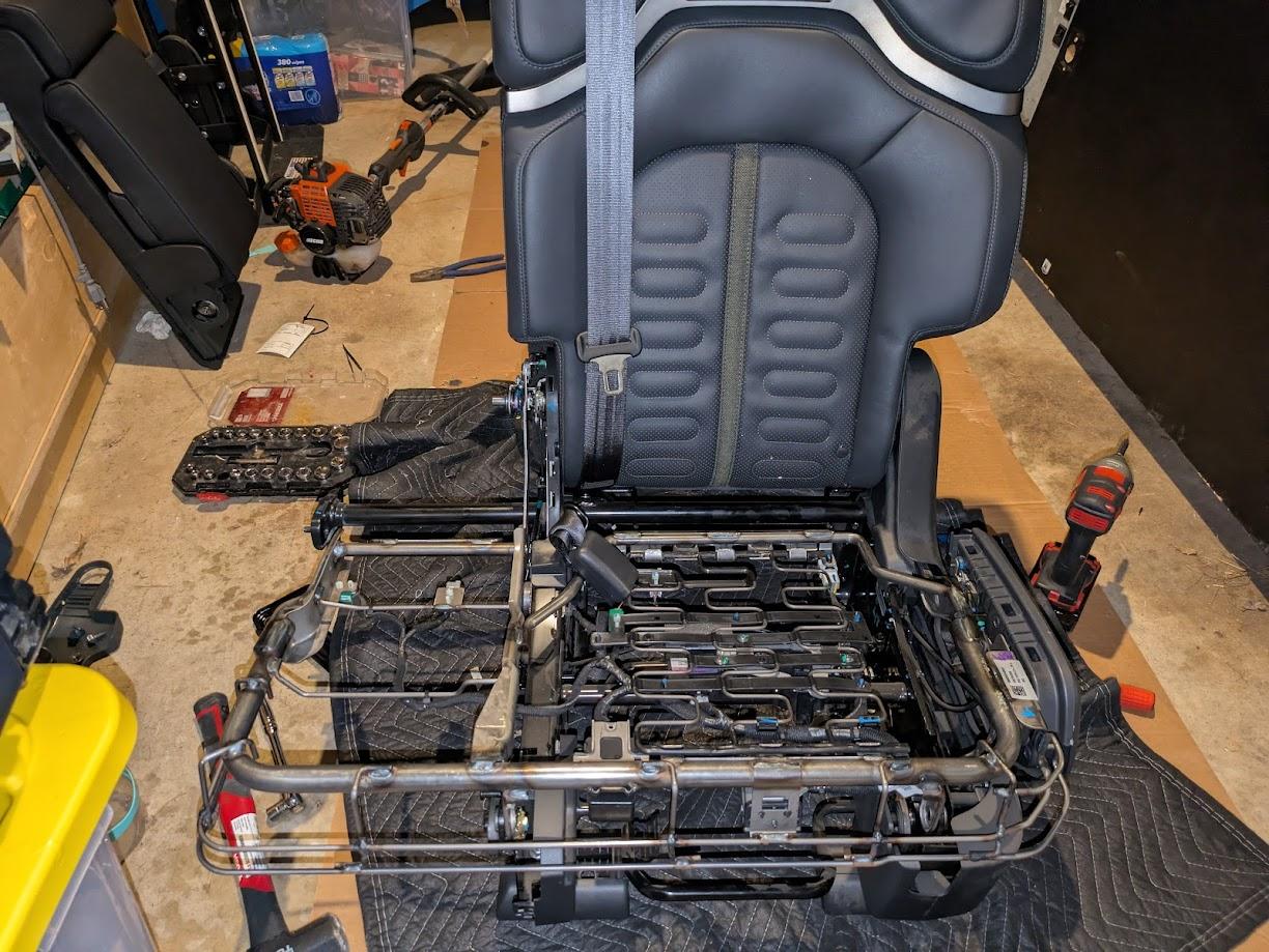

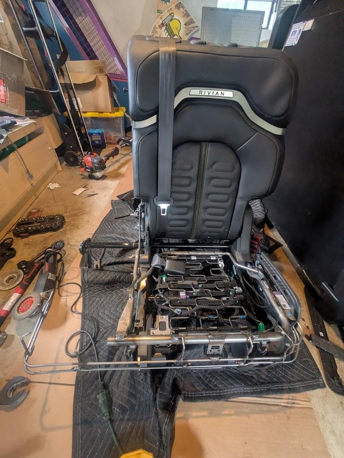

Progress so far (updated May 4):

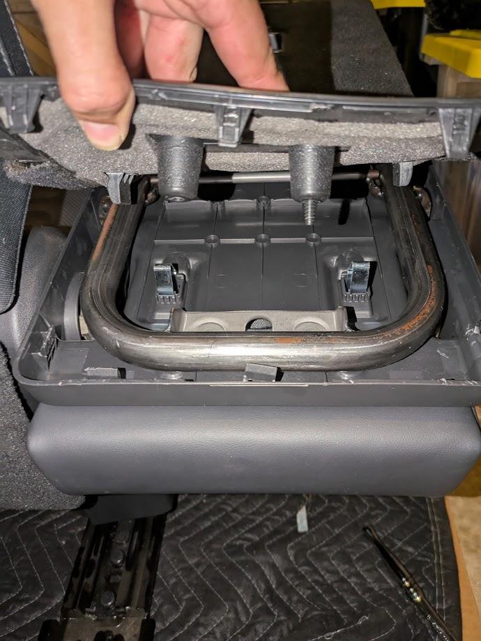

  • removed top portion of the middle that folds down.
  • removed plastic trim around floor mount for the rail
  • removed plastic trim that covers the rail and covers the hinge for the folding top portion
  • removed the bottom seat cushion from the seat frame

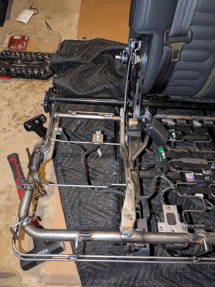

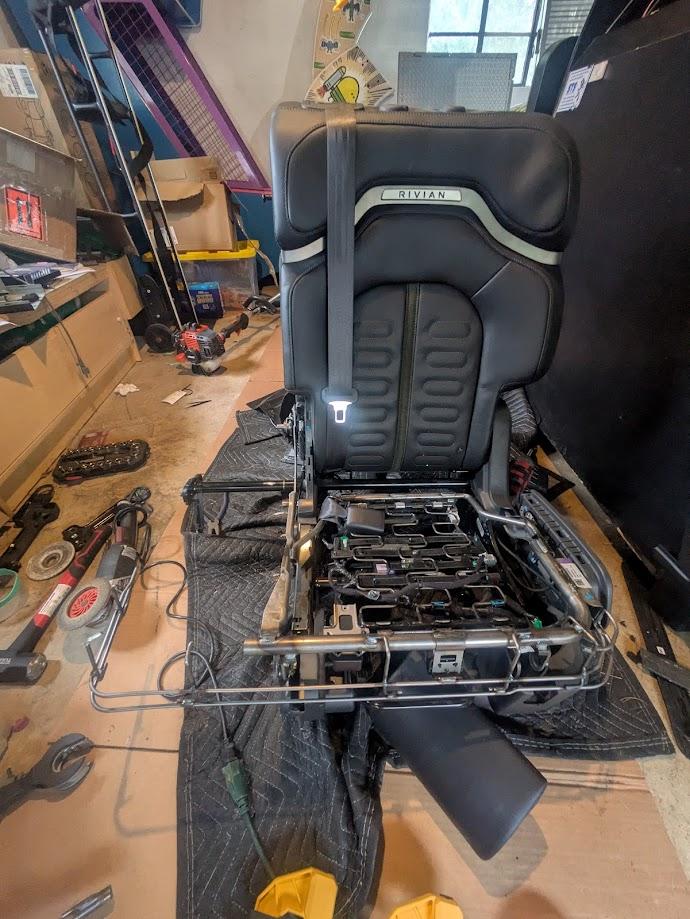

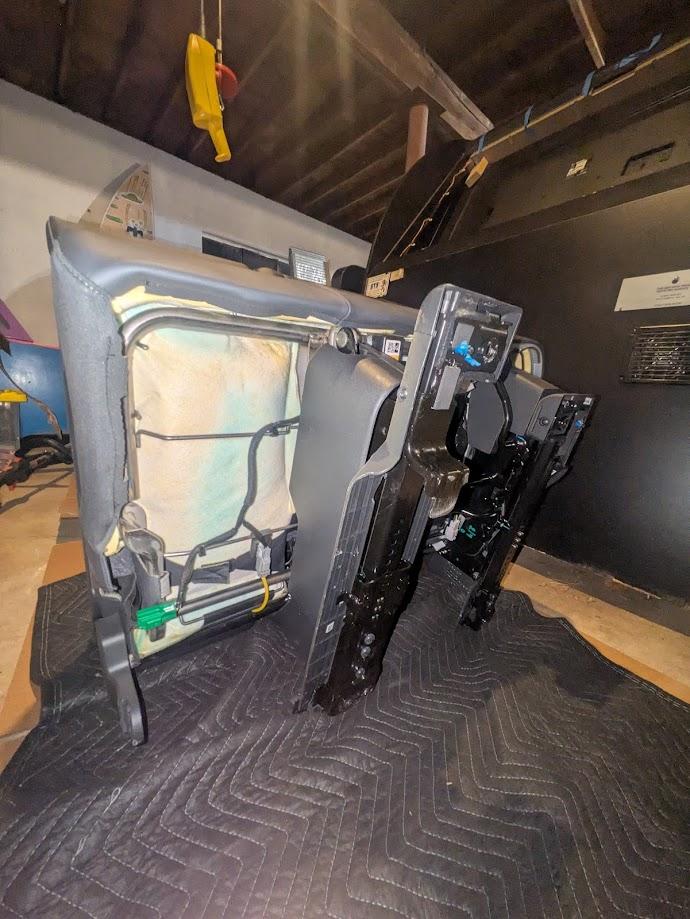

  • (new) grind down welds connecting wire frame from tubular frame
  • (new) cut out tubular frame including middle seat wire frame
  • (new) cut out rear tube - black bar that serves as hinge for folding motion
  • (new) bend wire frame to match curve of plastic molding

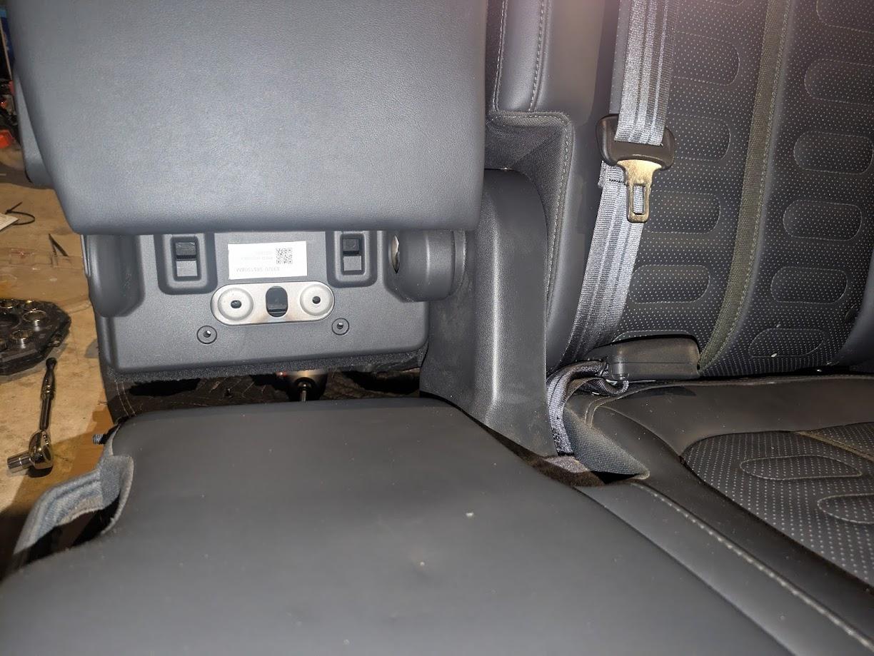

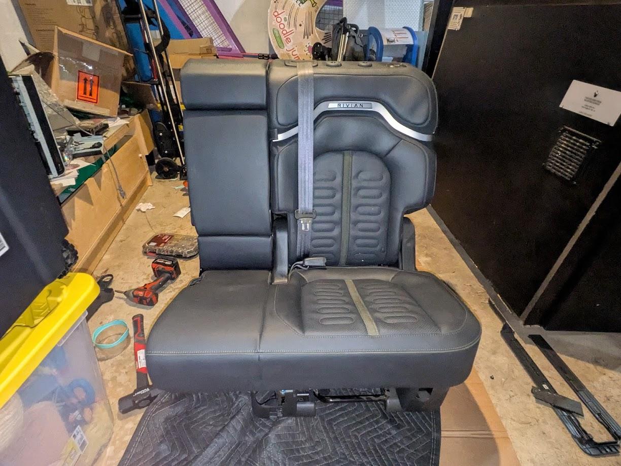

Original seat before any work:
Rivian R1T R1S [Removing Center Seat Section Project] - R1S 2nd Row Captains Chairs from Modified 60% Seat WTO1mG31UkR0r9WVftHs1GA=w1224-h919-s-no?authuser=0

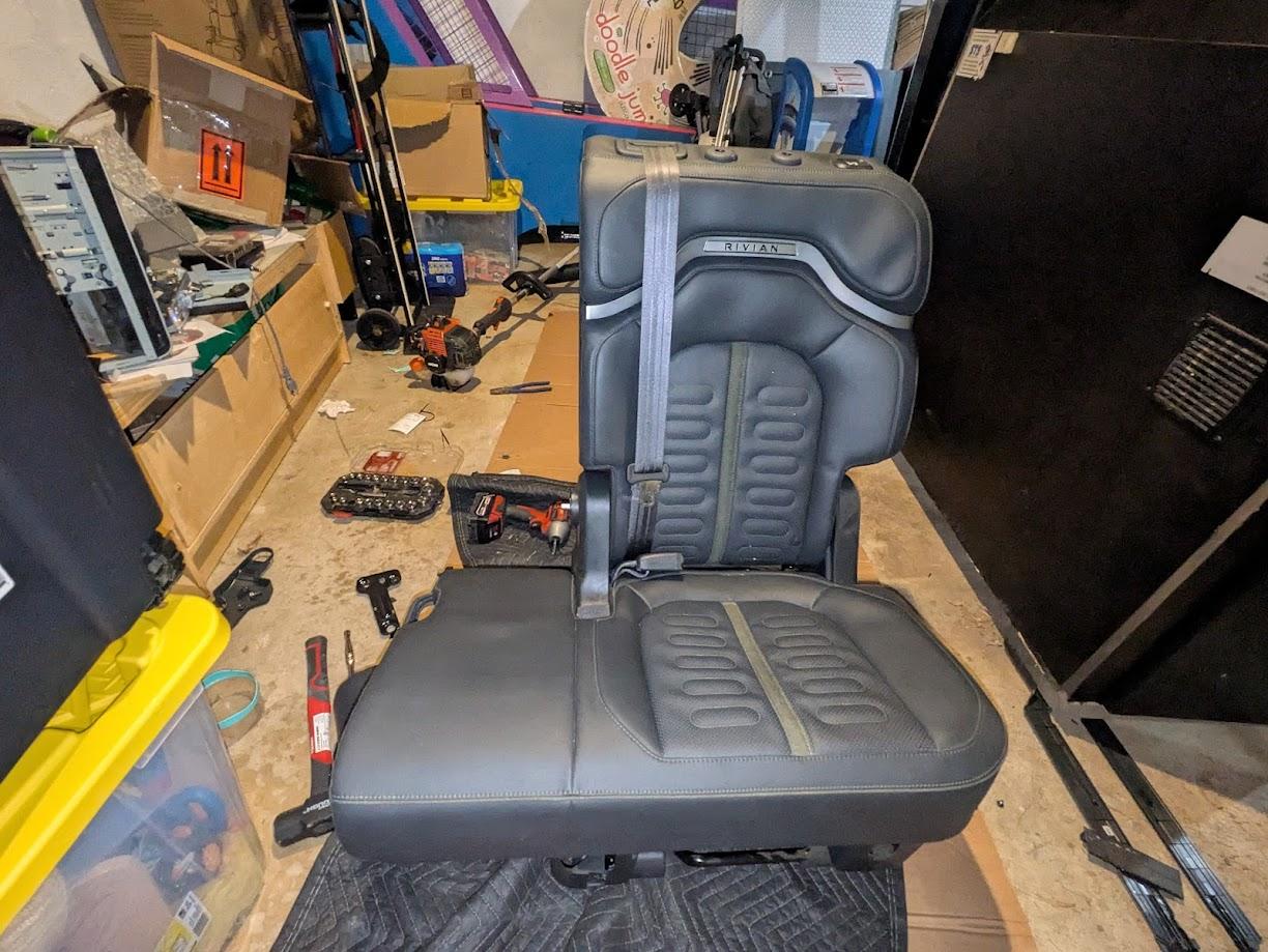

Current state (Updated May 5):
Rivian R1T R1S [Removing Center Seat Section Project] - R1S 2nd Row Captains Chairs from Modified 60% Seat 8hLT3D0_FwJZHn-0HzjA7C6w=w690-h919-s-no?authuser=3
Work in progress photos:
Rivian R1T R1S [Removing Center Seat Section Project] - R1S 2nd Row Captains Chairs from Modified 60% Seat y9PAruC-txOfqQYD5qqPlDtQ=w690-h919-s-no?authuser=0
Rivian R1T R1S [Removing Center Seat Section Project] - R1S 2nd Row Captains Chairs from Modified 60% Seat yVdxhD2Tsai6ww_Z8SXtMC5w=w690-h919-s-no?authuser=0
Rivian R1T R1S [Removing Center Seat Section Project] - R1S 2nd Row Captains Chairs from Modified 60% Seat 6FP15sL2ar6R2mh8ypb174pQ=w690-h919-s-no?authuser=0
Rivian R1T R1S [Removing Center Seat Section Project] - R1S 2nd Row Captains Chairs from Modified 60% Seat p7_Zq0fcfPPlanJV-Eh7T1Jg=w690-h919-s-no?authuser=0
