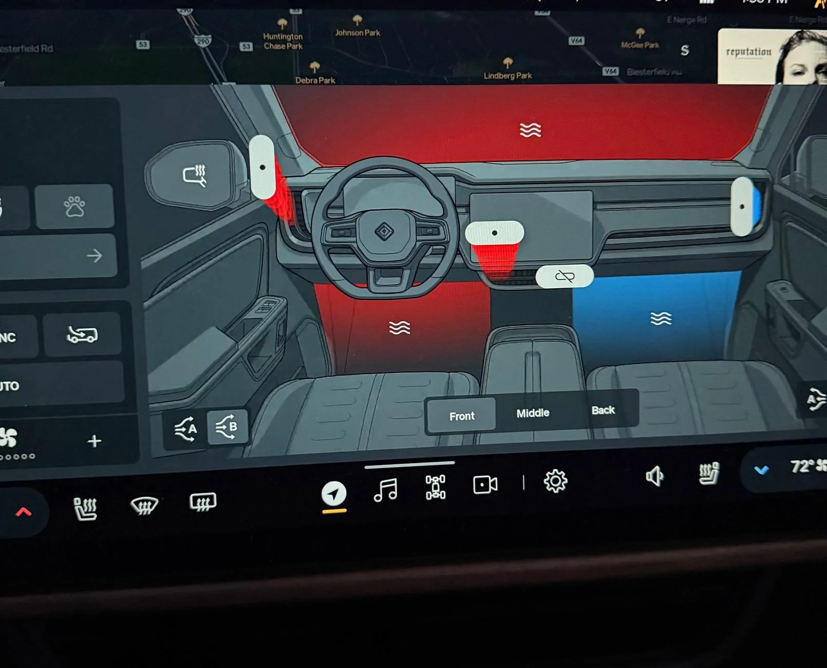

The HVAC has left much to be desired since day one. I feel like they still haven’t got it right. A one degree difference on the thermostat could mean blowing hot air and cold air. There’s nothing in between.
In this photo, driver is at 73F and passenger is at 72F.
Rivian R1T R1S Did the new update break the hvac? IMG_0125

I typically have mine synced at 68 in the winter and 71 in the summer and it's comfortable throughout the cabin.
Based on these reports, it sounds like a dumb system that can't handle multiple inputs (more than one constant heat temp). I love my Rivian but can't understand why some design choices were made and why needed to overcomplicate it (electric air vent controls).

Has anyone else noticed HVAC temp differences change the depth of color for the vents? Like borderline hot is pink, and HI is deep red. Opposite is light blue and dark blue.
