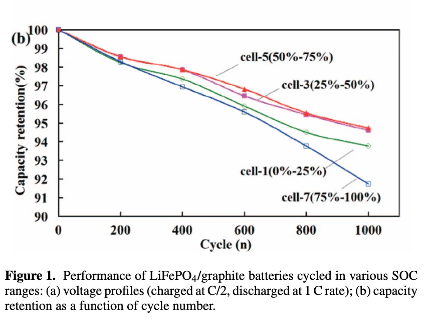

Yes, there's not a lot of data online about various SOC ranges, but it seems that targeting an average 50% state of charge may be best. From the study below on LiFePO4 batteries, it's clear that 25%-50% vs. 50%-75% is a negligible difference, but the extremes should be avoided.
Personally, I follow Rivian's SOC range recommendations. They have studied this a lot more than any of us have! I see no reason to stop charging at 50%, and there are the potential problems of increased connector contact cycle count and no buffer range for unexpected road situations where you need spare capacity.
I think this is all you need to know. Everyone else is just synthesizing info 3 or 4 degrees removed from this.
