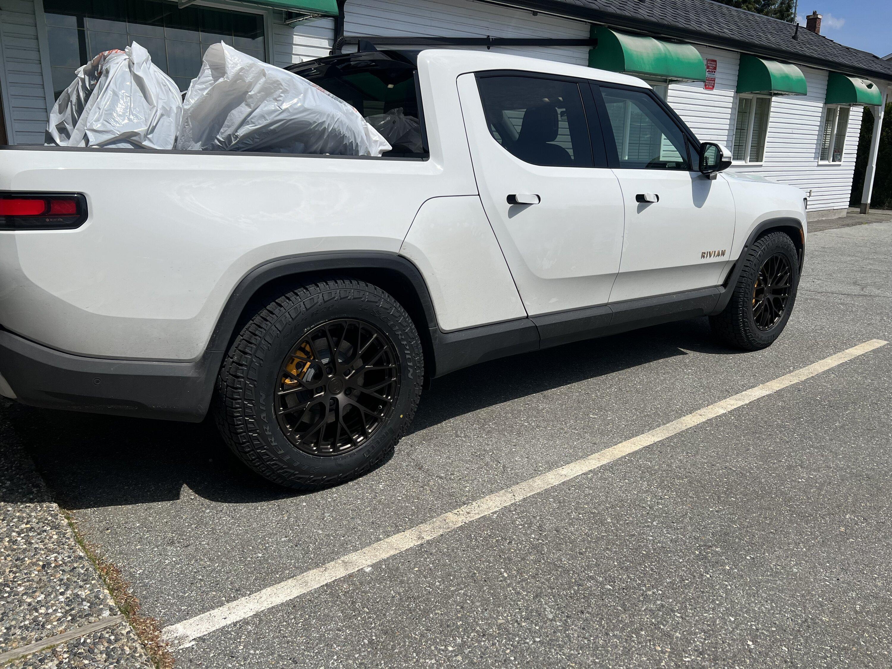

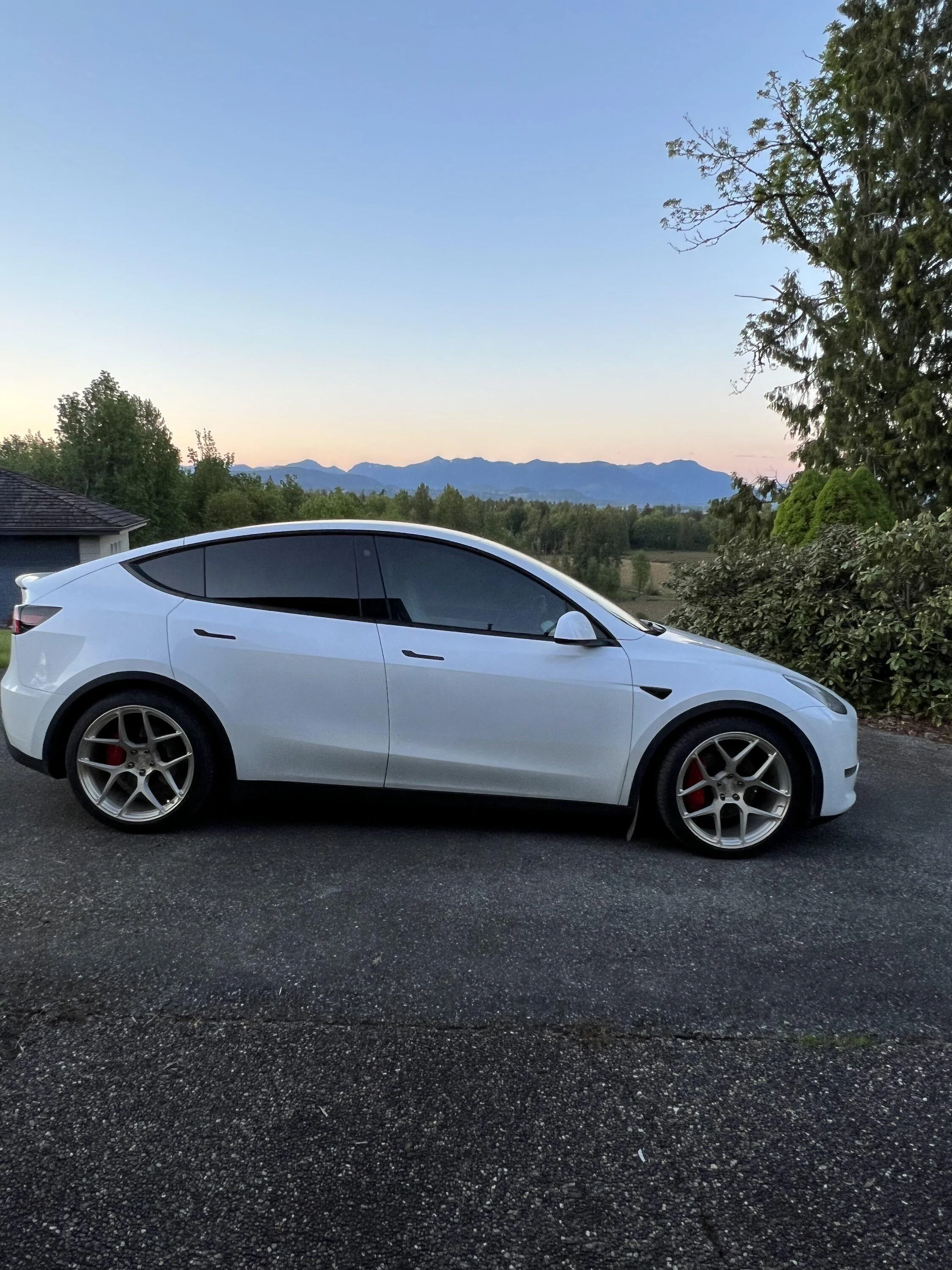

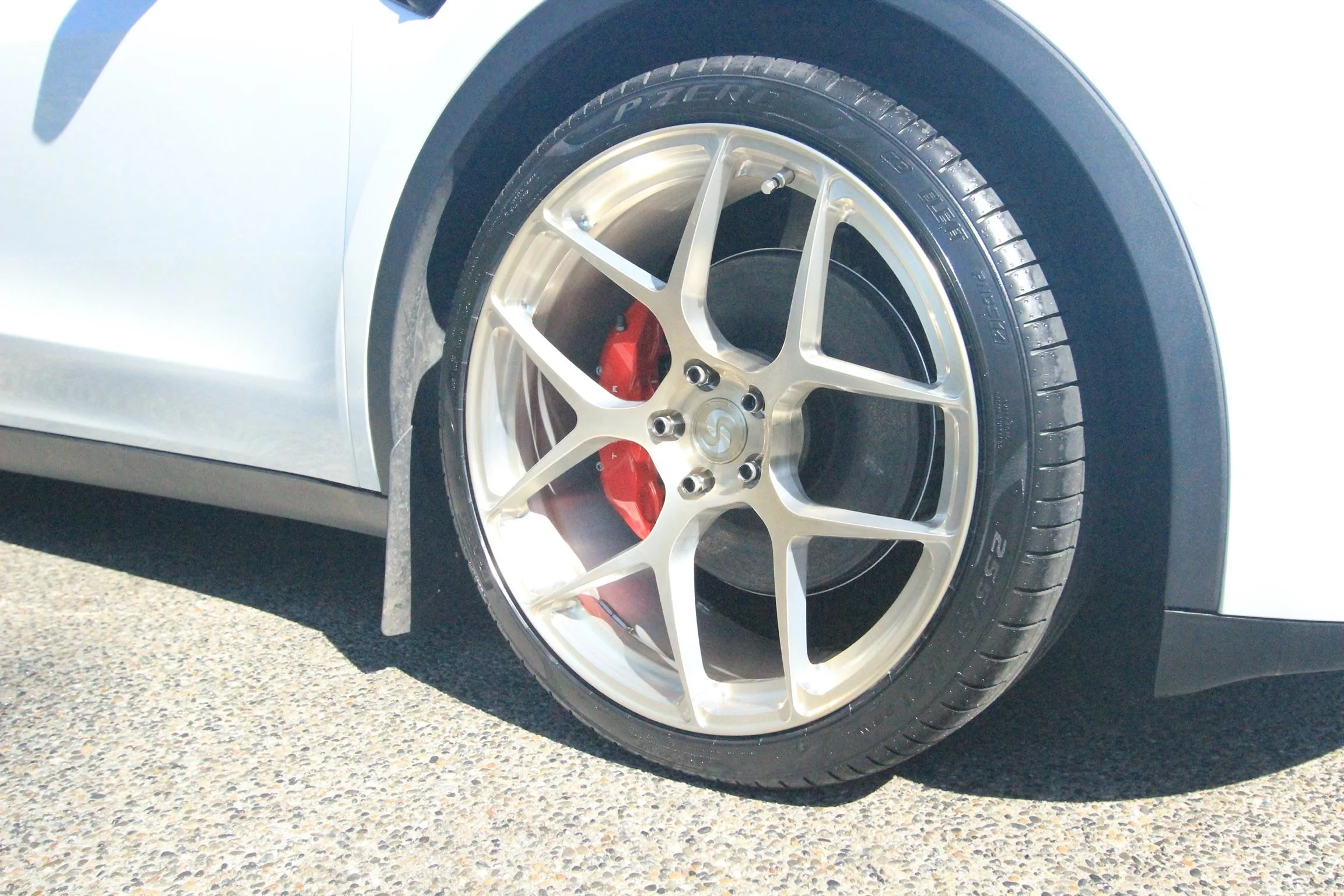

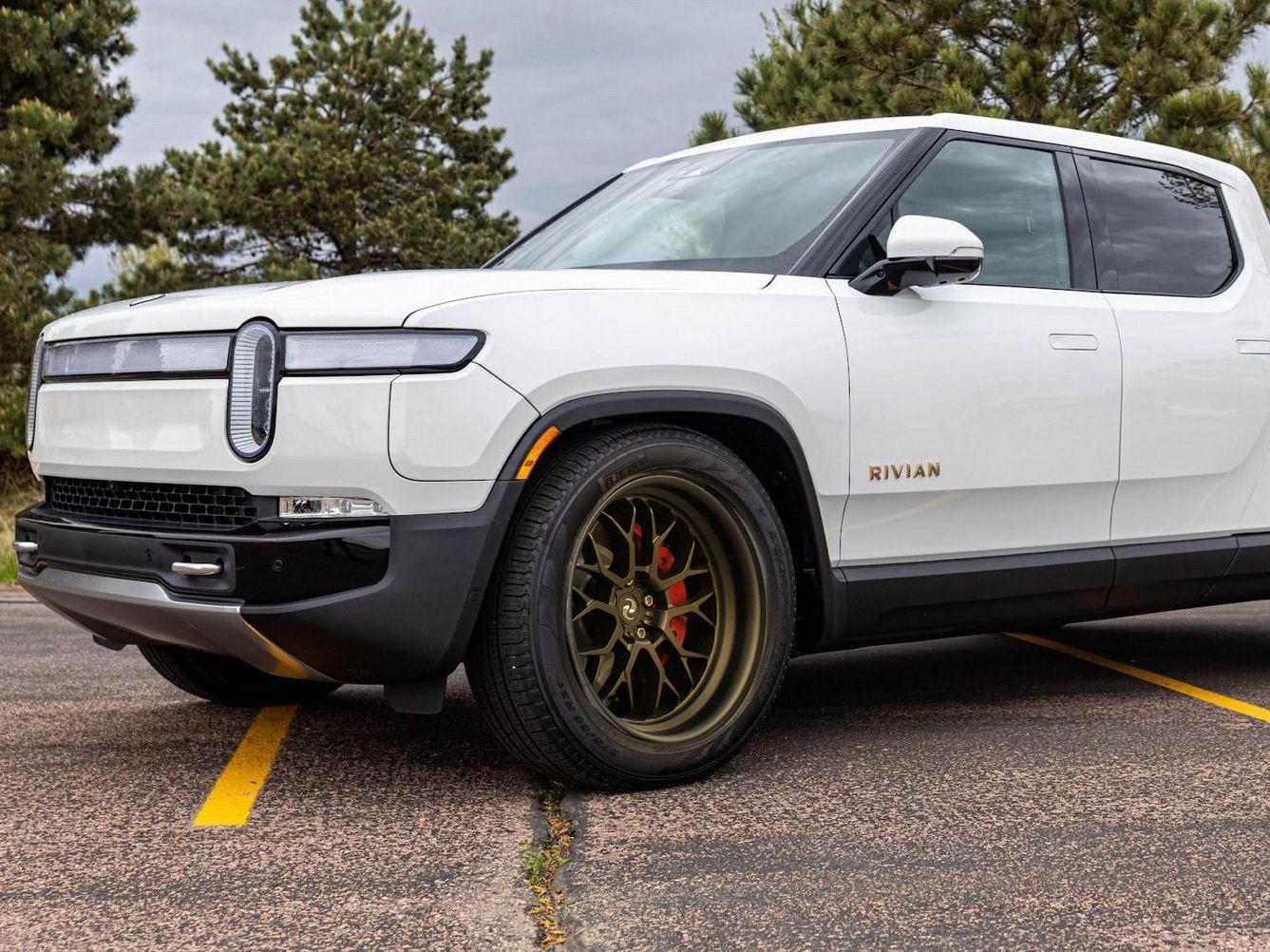

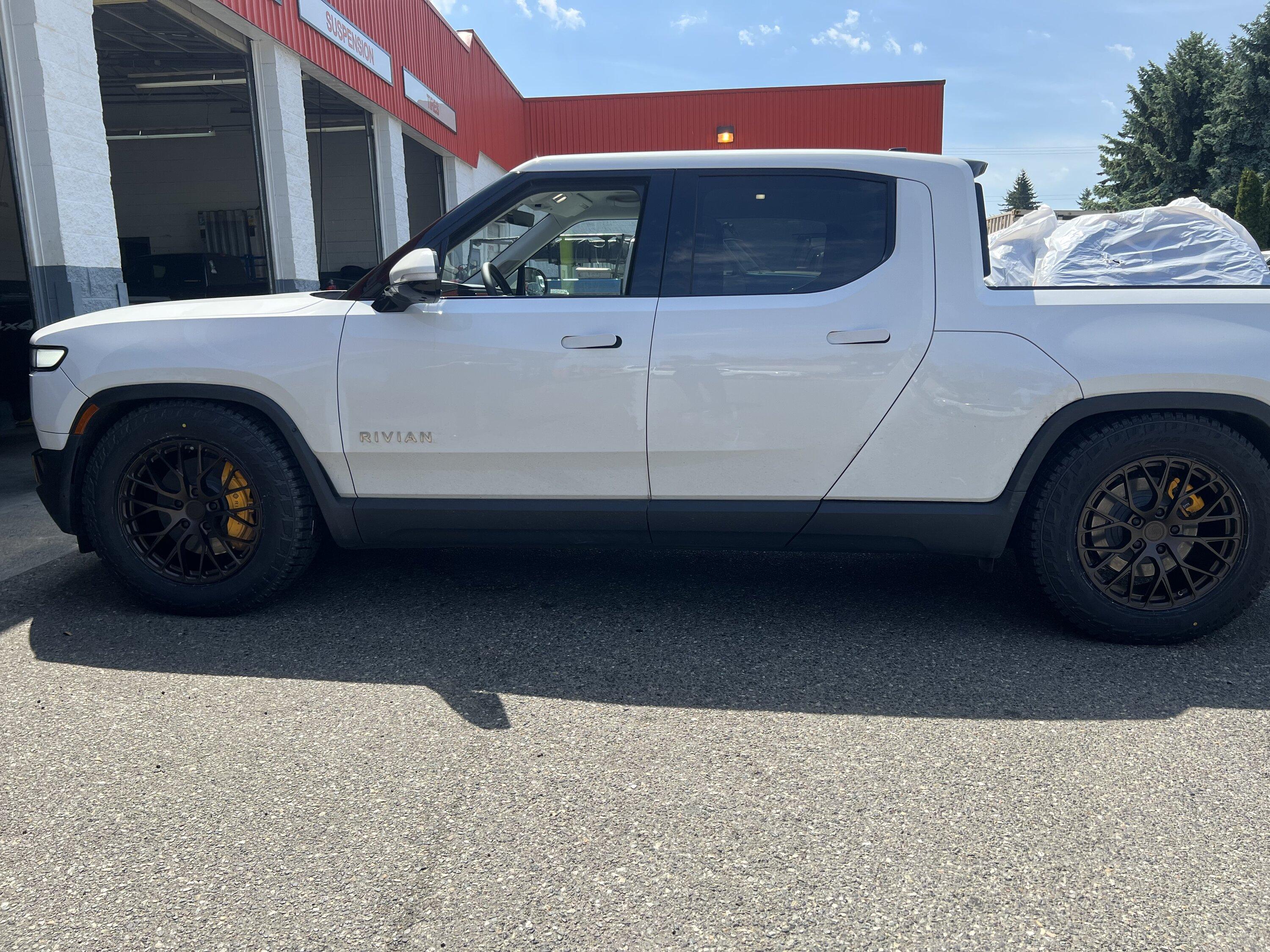

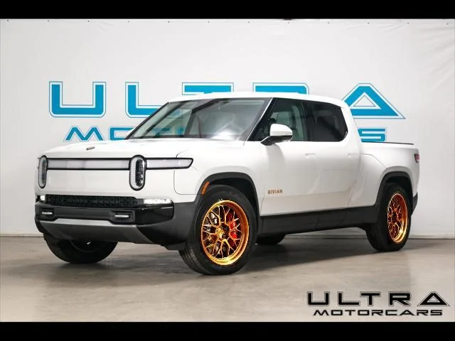

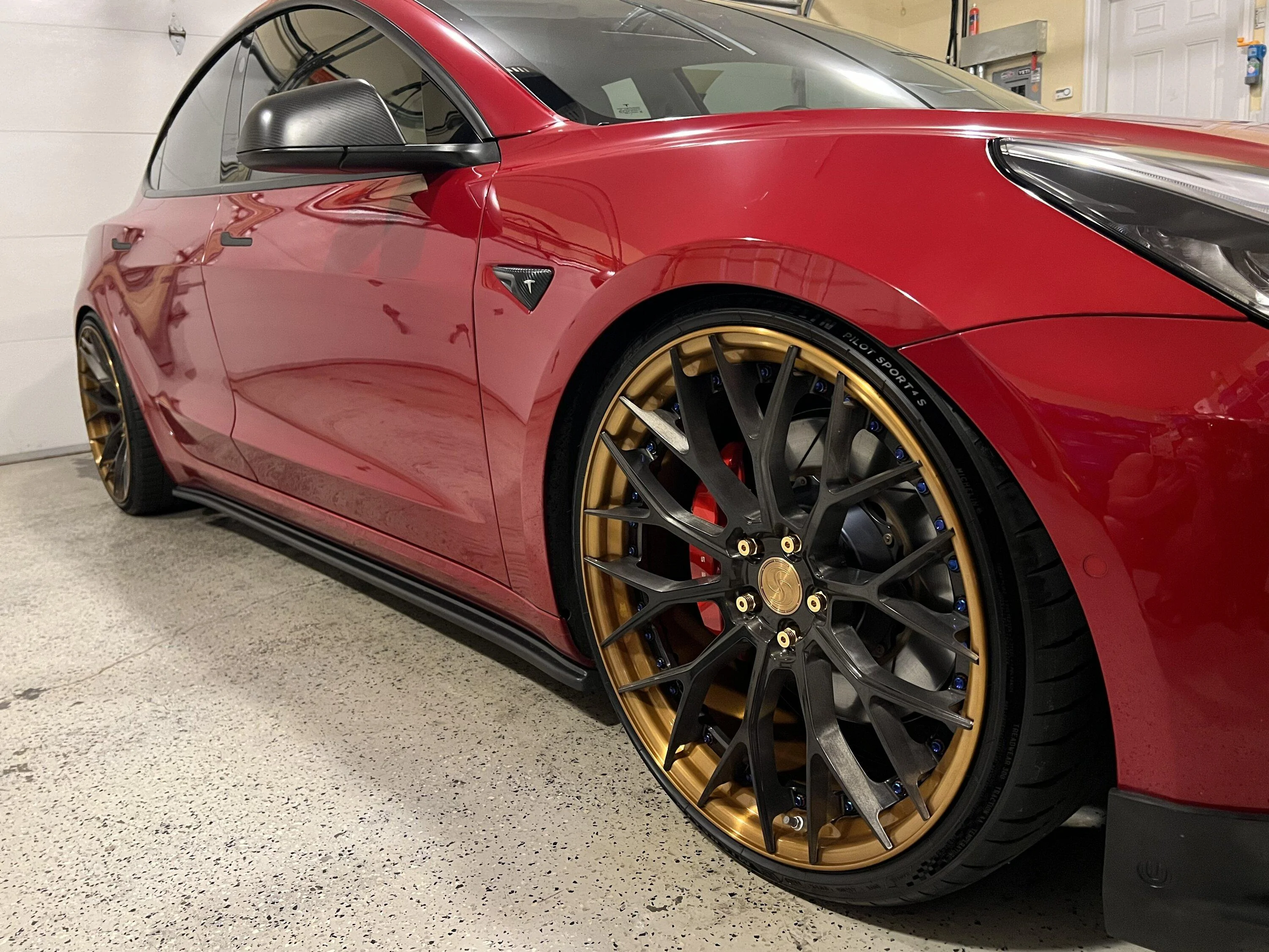

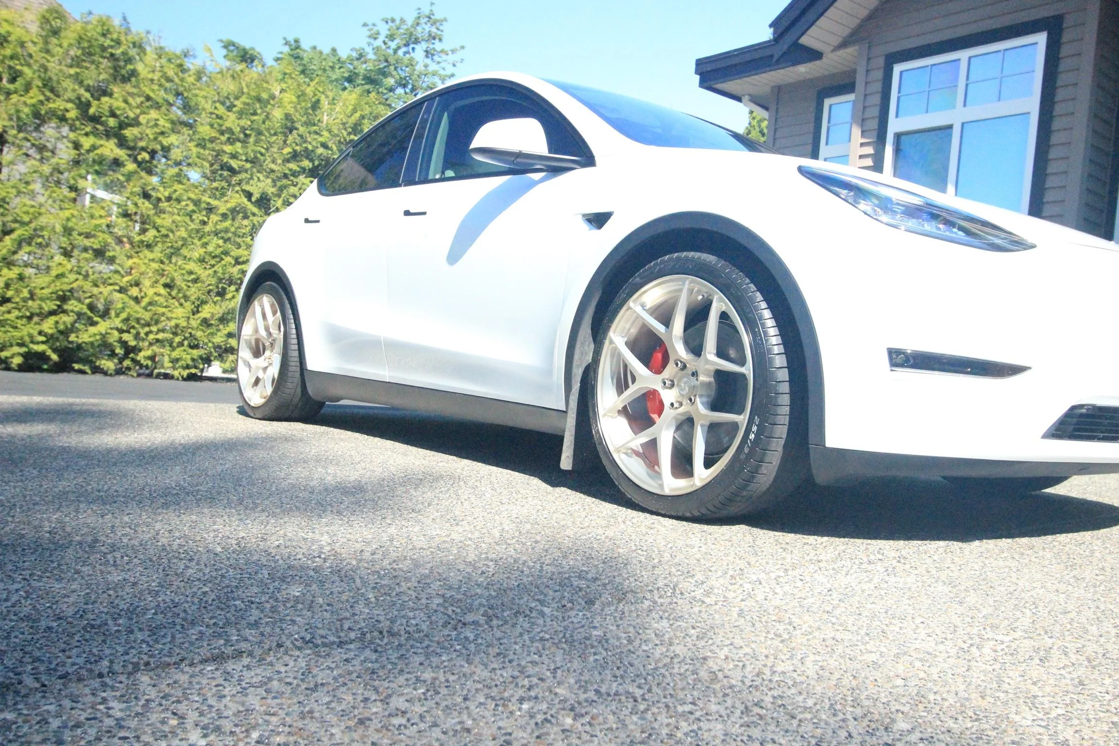

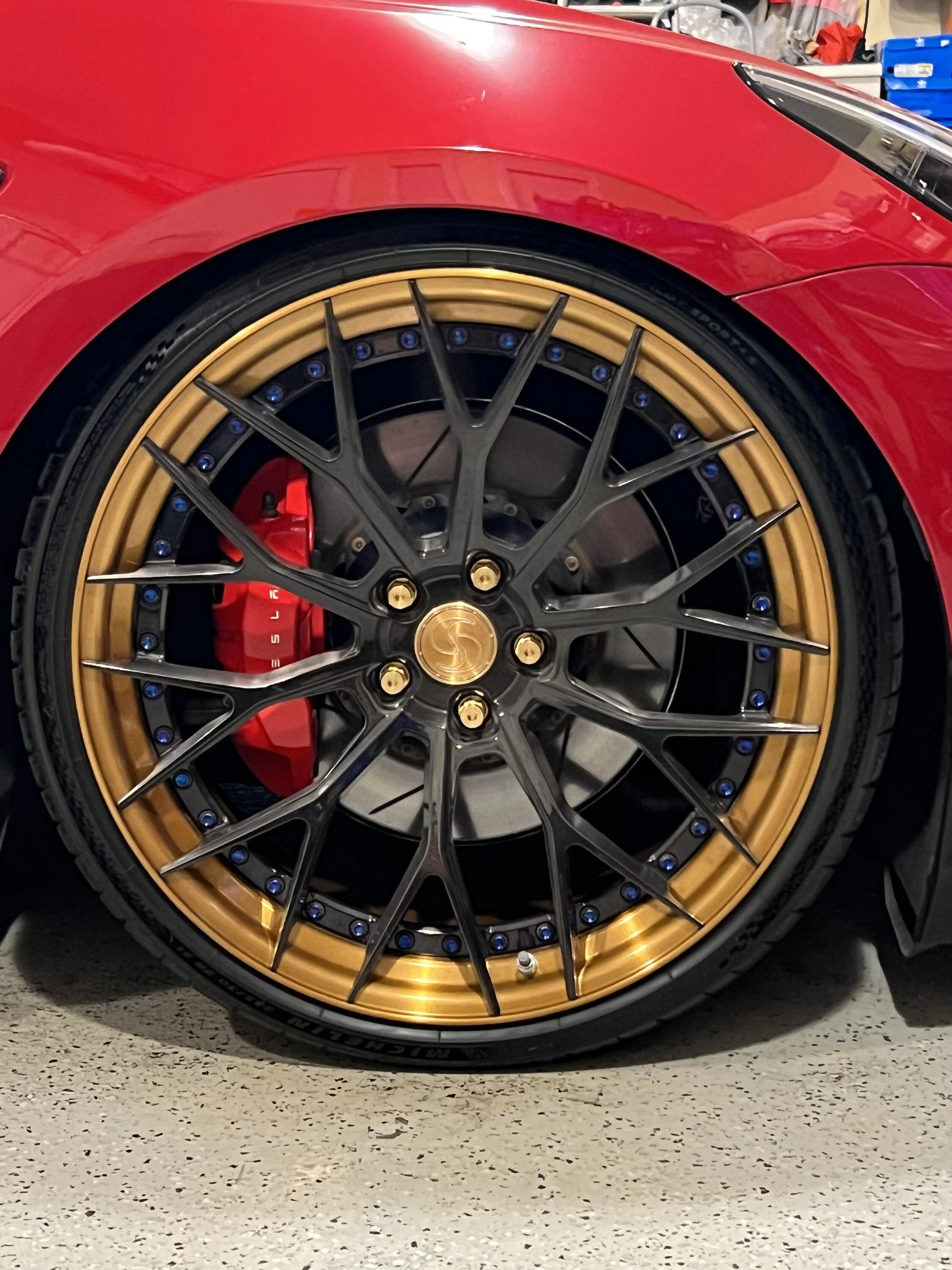

Some pics of the R1T Jamie has already fitted and a photoshop of the wheels I’m getting. Also included a few pics of my Teslas with Signature wheels.

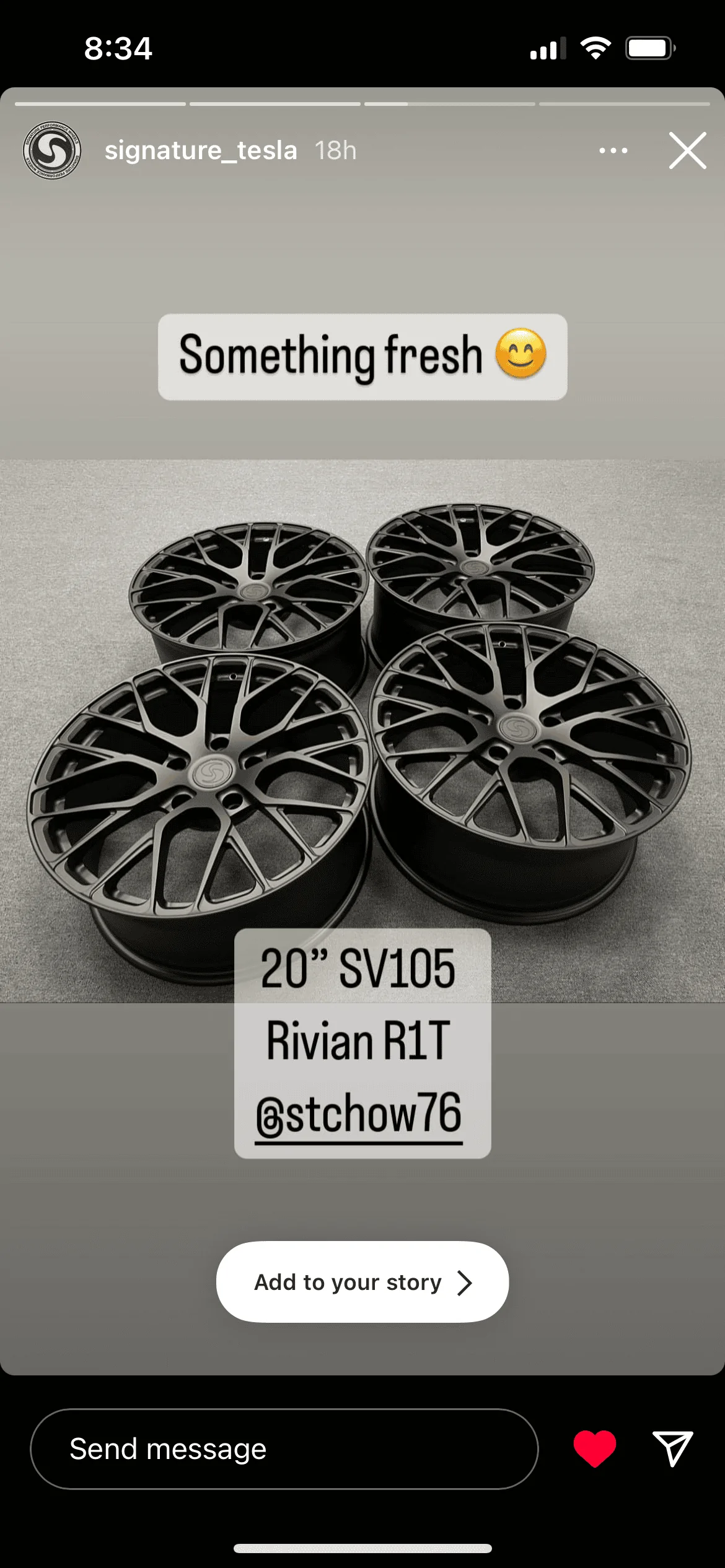

Jamie from Signature messaged me that my wheels are finished and ready to ship out.
Ended up going with SV105 in graphite powder and going with the stock Pirelli Rivian spec Scorpion AT tires. I know they aren’t E-rated 121/126 load rated tires but want to keep the rotational mass down with the lighter AT. Next is to clone some tpms sensors. Hope to have these on the truck in a week or two.
