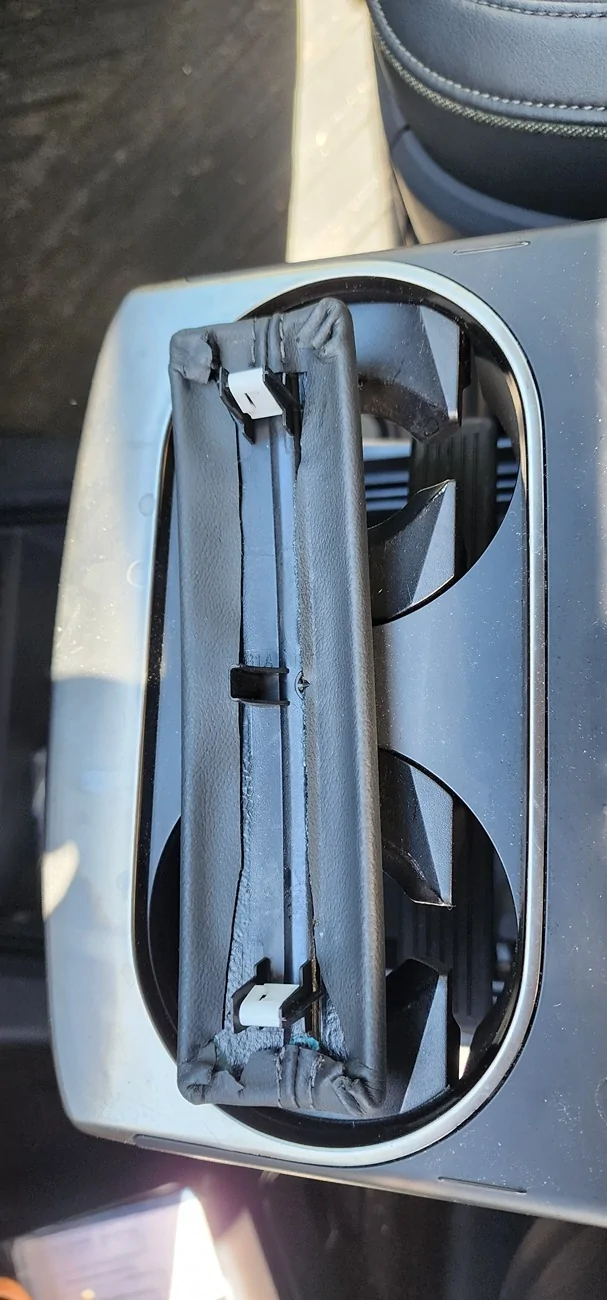

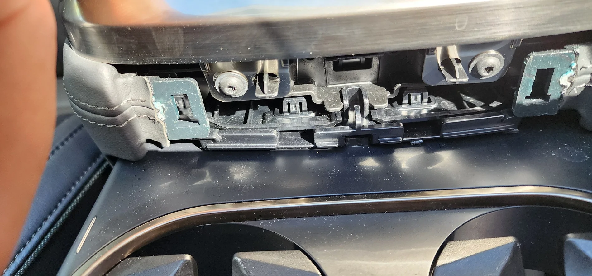

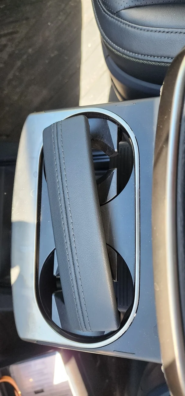

Service has reached out and will sell me the part new, but of course they will not tell me how to get the old one out. :rolleyes:
Nixapatfan
Aug 23, 2024
603
1,225
Massachusetts
OK I was bored and curious, took less time to figure it out than writing this post. The two trim panels above and below the cup holder just pop out and three screws 2 on top 1 bottom and slide the whole assembly out.
Rivian R1T R1S Cup holder piece broke 1000054093
Rivian R1T R1S Cup holder piece broke 1000054094
Rivian R1T R1S Cup holder piece broke 1000054095
