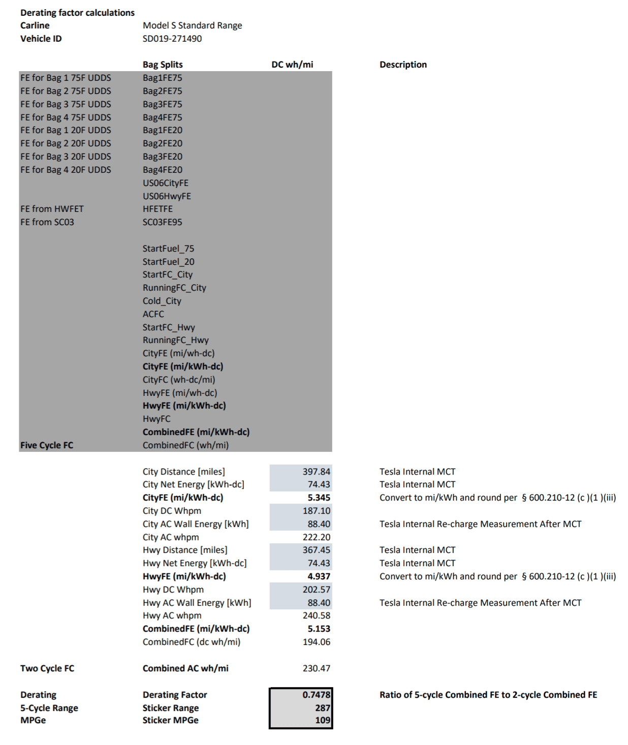

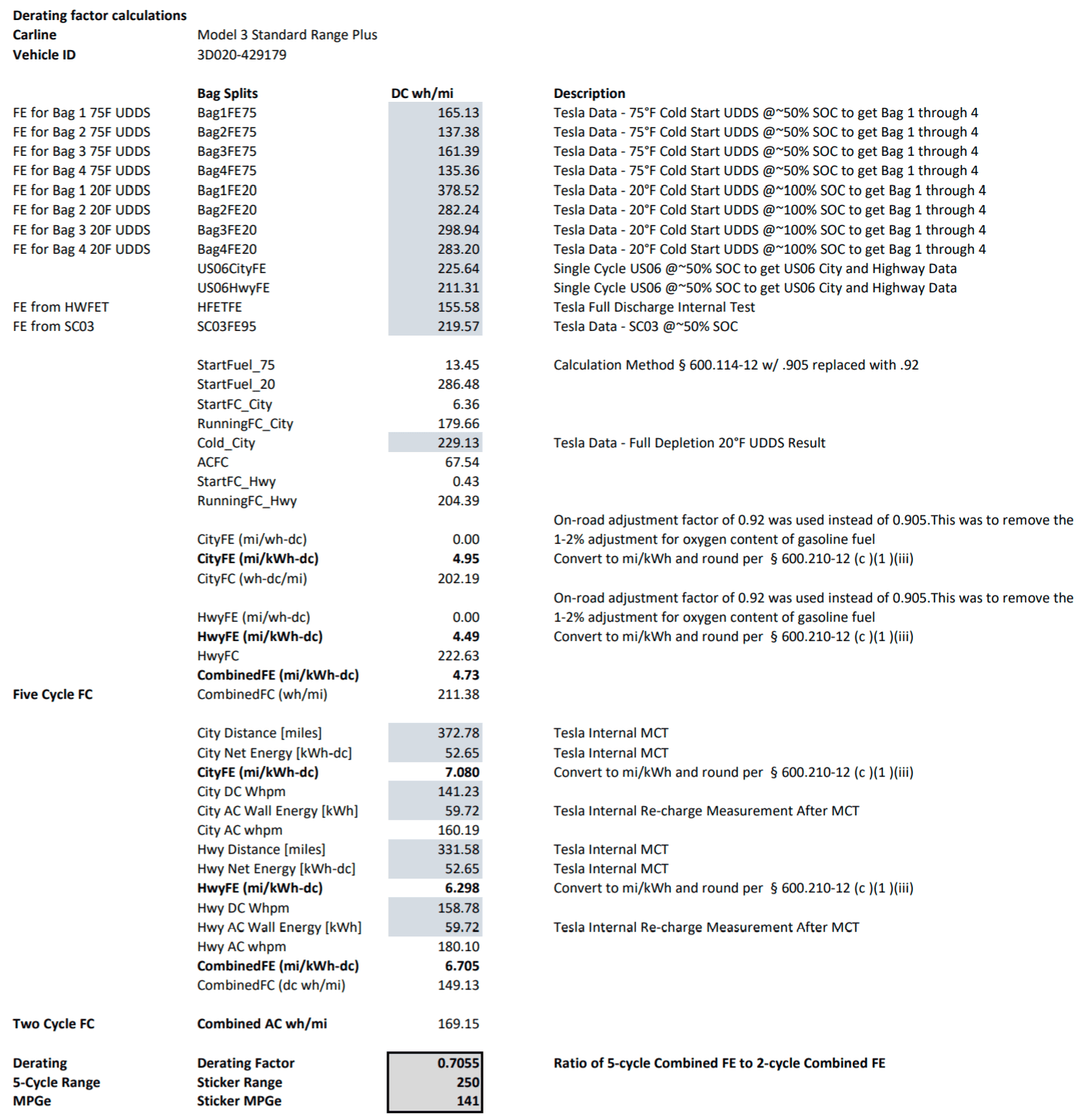

As to the EPA label, you'll notice in the first few pages of the doc, they hadn't set the derived data and applied for the label in this document. The label values have a derating amount. Manufacturers can either use a standard multiplier of .7 (30% derating) or if they use the 5 cycle test and submit backup data for a different value they can do that. Claculated value in this doc for the M3 SR+ is .7055:
Rivian R1T R1S Cold Weather Testing | Progress Report | Rivian - Official Video 1614386435724
https://iaspub.epa.gov/otaqpub/display_file.jsp?docid=48708&flag=1
Model S standard range uses .7478:
Rivian R1T R1S Cold Weather Testing | Progress Report | Rivian - Official Video 1614386569887
https://iaspub.epa.gov/otaqpub/display_file.jsp?docid=48714&flag=1
The lower than standard derating plays a part in why more drivers have a hard time matching the EPA rating in their Tesla than some other brands that take the "standard deduction".
They are able to report a higher range with the same test results, and then also open up more of the top range of the battery (and tell you not to use it often). Combined these allow them to maximize the EPA label value. Not cheating or gaming the system, just taking full advantage of the regulations they way they are written.

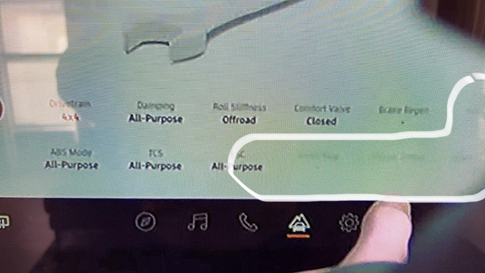

Drive train, damping, roll stiffness, comfort valve, break regen(like you already said), ABS, FCS, and ESC. I’m wearing glasses so I can make it out a little better
Rivian R1T R1S Cold Weather Testing | Progress Report | Rivian - Official Video 452C93CE-AB98-497A-AFF0-4CA39CA23D06
I’m talking about these blurred ones. I can read those others.
