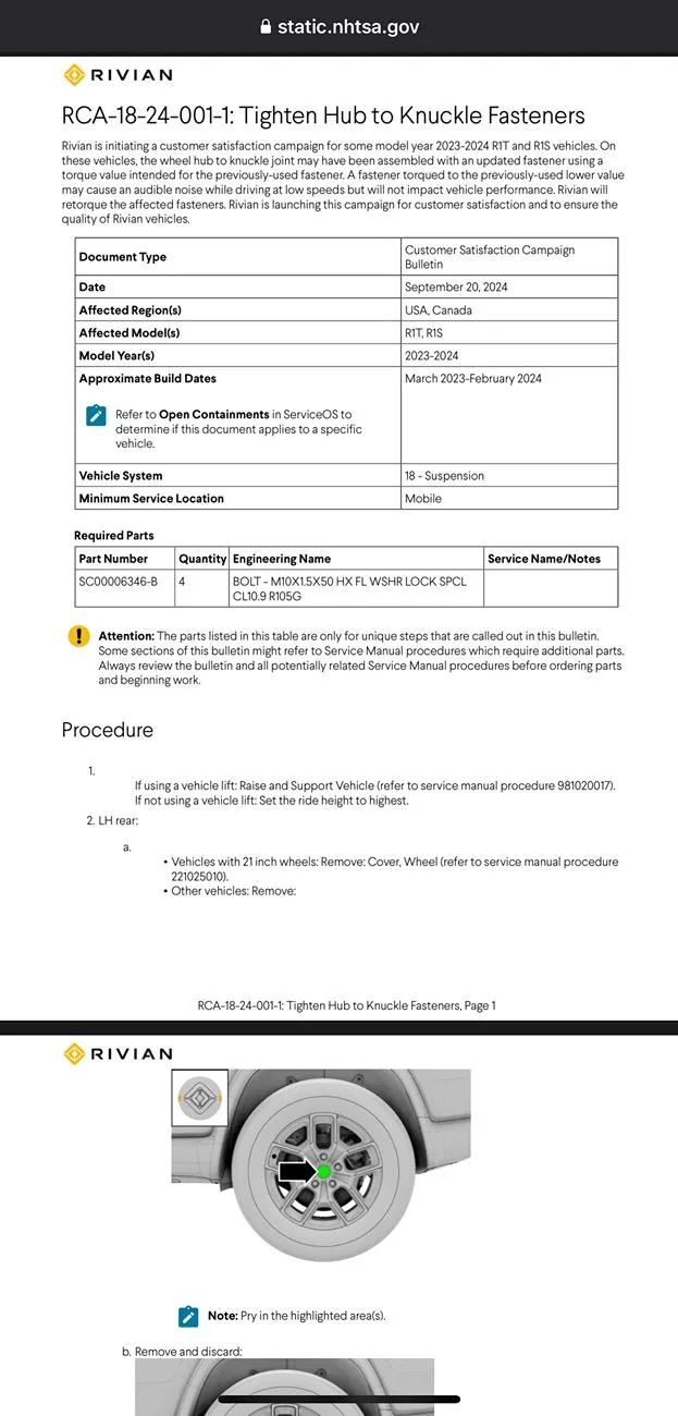

Have we discussed this new RCA?
RCA-18-24-001-1: Tighten Hub to Knuckle Fasteners
Rivian is initiating a customer satisfaction campaign for some model year 2023-2024 R1T and R1S vehicles.
On these vehicles, the wheel hub to knuckle joint may have been assembled with an updated fastener using a torque value intended for the previously-used fastener.
A fastener torqued to the previously-used lower value may cause an audible noise while driving at low speeds but will not impact vehicle performance.
Rivian will retorque the affected fasteners. Rivian is launching this campaign for customer satisfaction and to ensure the quality of Rivian vehicles.
wait - just re-read this. It’s actually on all four wheels, so this just might actually be it. I drove a gen2 last week and it also has the same noise.
