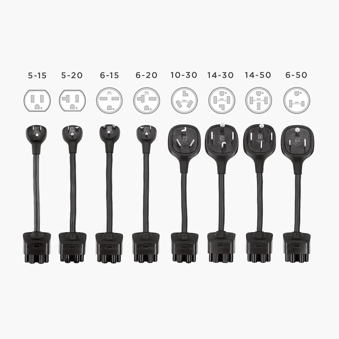

Tesla arranges their adapters such that the ground is at the bottom of any 15-20A plug, but at the top of any supporting 30A or higher:
And that's what I've seen with most 220V outlets...The ground is at the top, and your photo is a perfect example to make my point. With the ground in the "correct" position for these then hanging the charging brick from the plug won't try to pull it from the outlet. If the ground is in the wrong position then it will.

That makes total sense, but not in a house! With it "upside down" you run the risk of someone using it permanently and eventually the cord pulling on it may pull it out of the socket...
Why risk it? If the situation above were flipped, the cord would be acting as a bit of a lever with gravity providing the force away from the wall - the exact opposite of what the manufacturer intended with this plug design, rightt?
Ground up, first part to come unplugged. Ground down definitely safer.
Except the 6-15 and 6-20. Kinda strange there is no standard for plug orientation.
