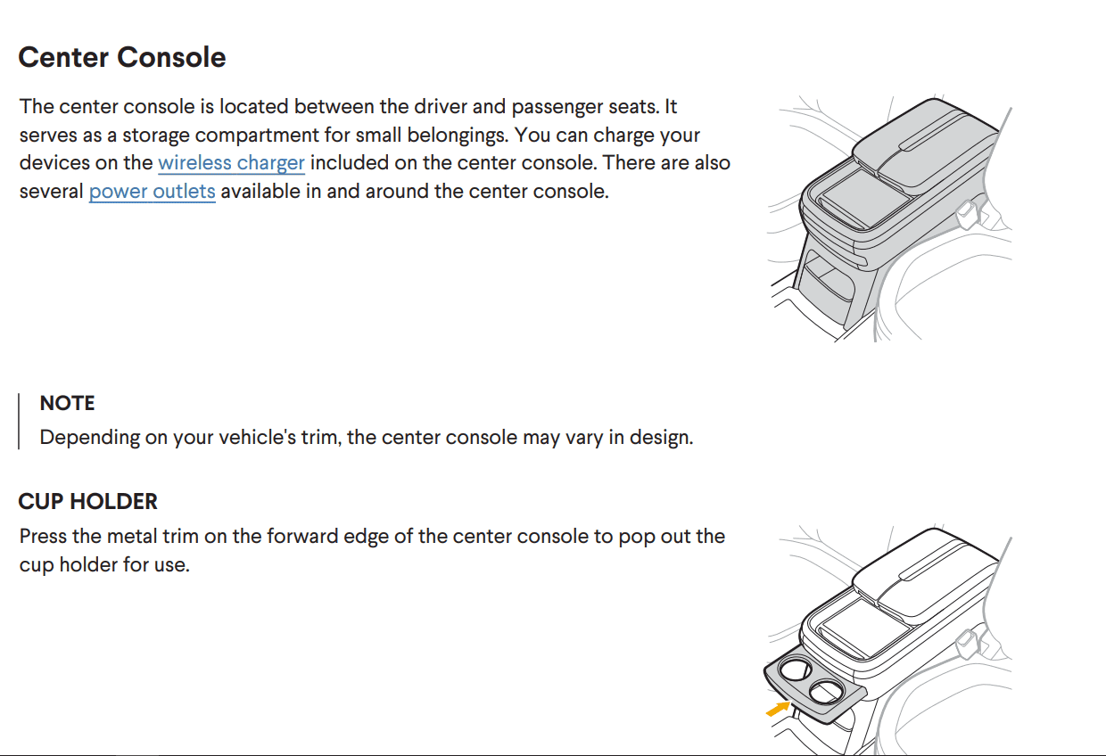

Definitely interested in a magnetic locking drawer in-place of the camp speaker. Has anyone noticed the pic of the center console in the R1T owners manual? Look...
Rivian R1T R1S Center Console/Camp Speaker Rivian center console_drawer

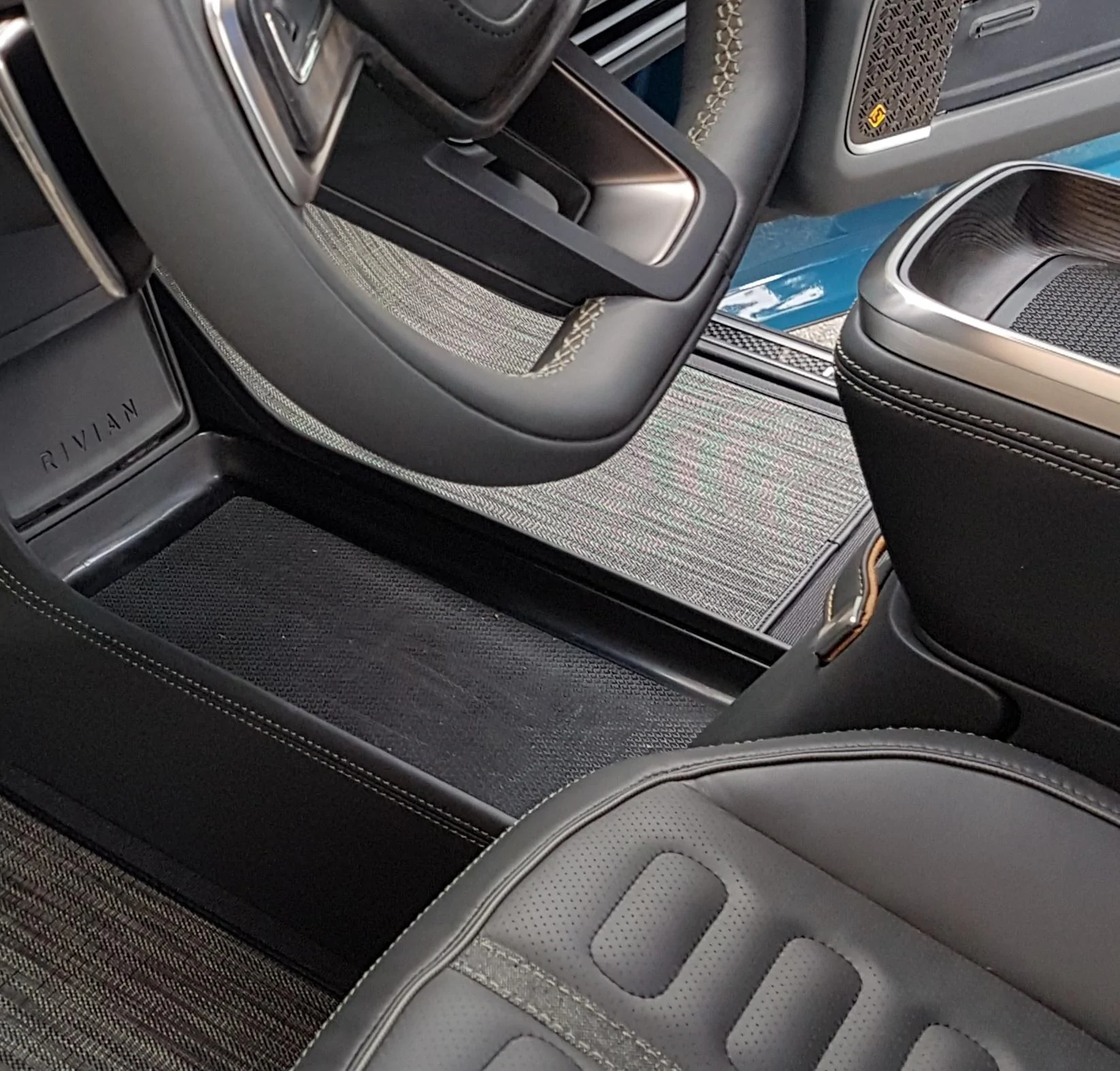

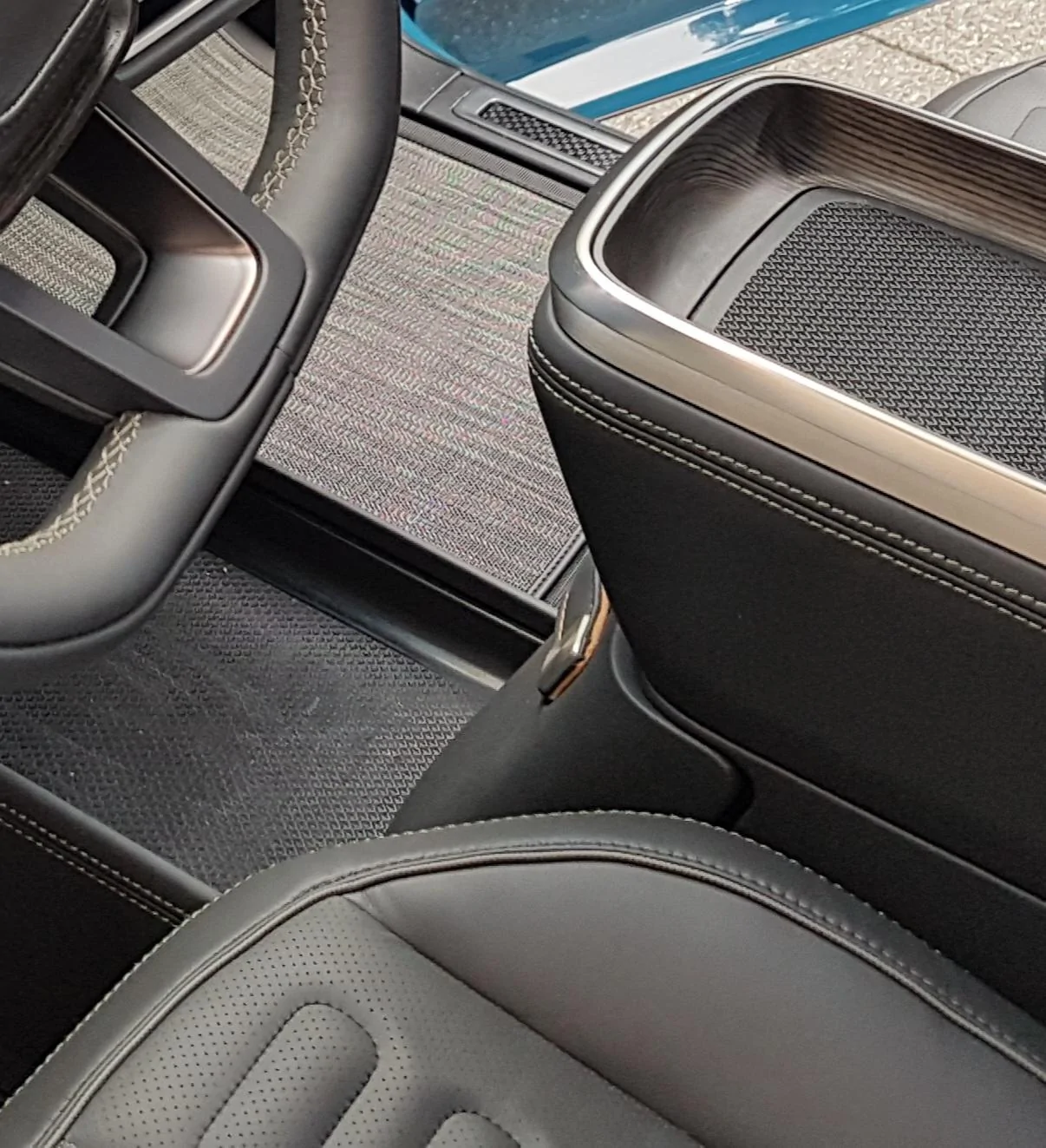

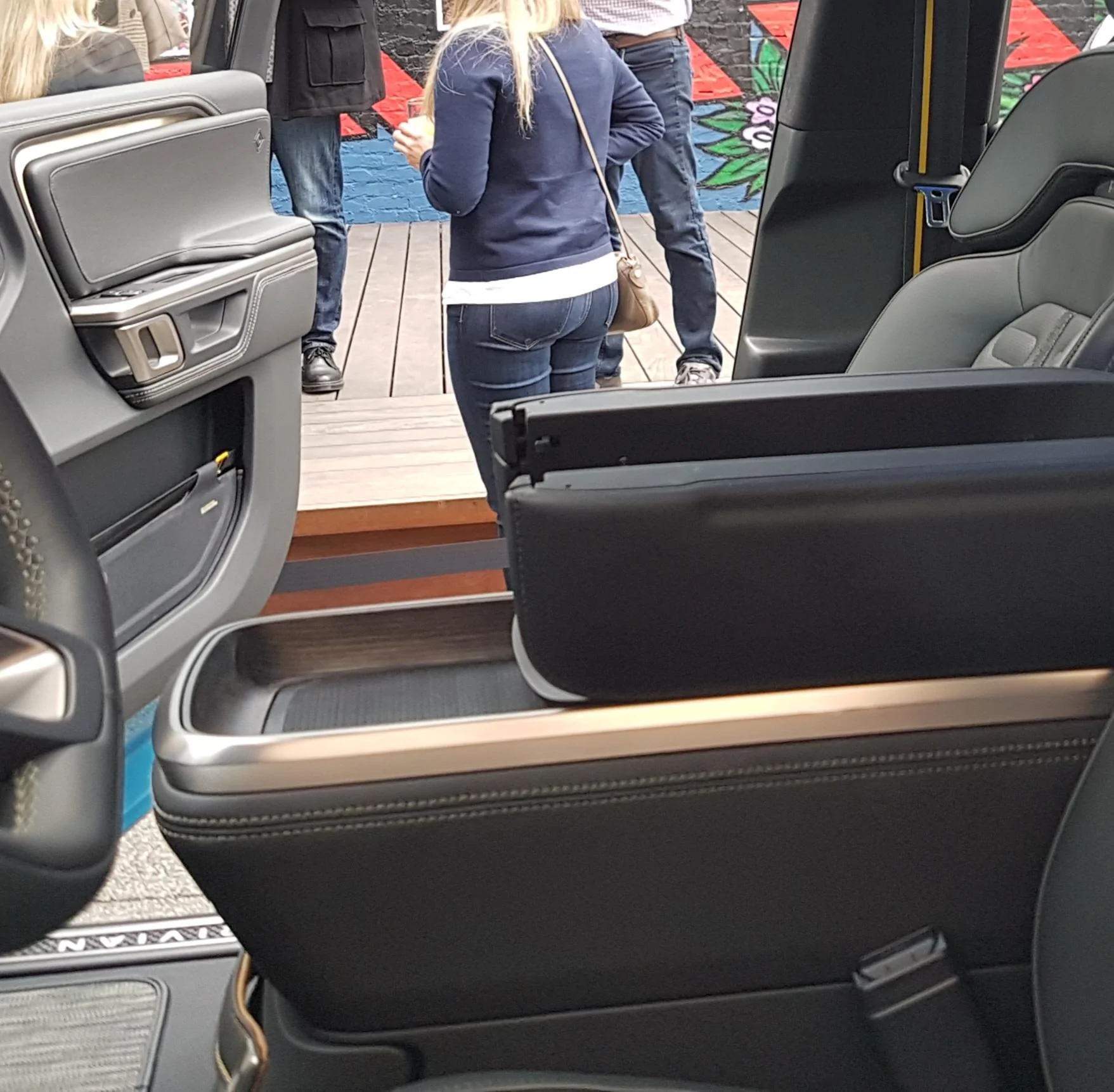

The OG demo models had a pull out drawer with a grab handle similar to the ones above the doors. I have a few photos of it doing a peak a boo in the background, but nothing of it pulled out.
@RWerksman I agree that you'd ideally want the Rivian OEM latch receptacle to secure it from flying out during a braking event and the added functionality of being lockable storage. But that becomes expensive.

FWIW it's the same as all the other ones on the vehicle. I know someone was working on a scan of it to design caps/plugs to reduce aero, you could reach out to them and get the scan to make a matching print (I'll find the thread later and post it here)
Here are the cropped photos I took in Seattle '19. I'm motivated to find the YouTube clip that showed them opening it, but that's going to take a bit more time to find. Also, I'm sure my wife would LOVE to watch more Rivian videos with me ?
Rivian R1T R1S Center Console/Camp Speaker 20190927_172538
Rivian R1T R1S Center Console/Camp Speaker 20190927_172540
Rivian R1T R1S Center Console/Camp Speaker 20190927_172552
