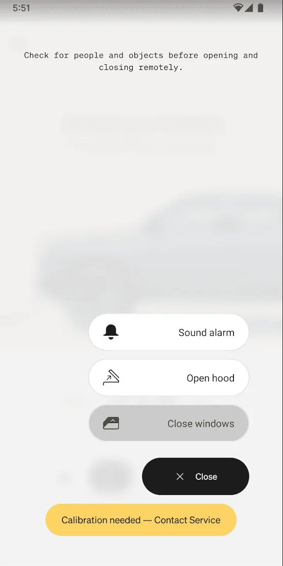

Anyone else getting this Calibration Needed error? I tried restarting the phone but it didn't help. I haven't driven the R1T since updating.
I am getting the same issue, I followed the instructions someone provided from Service to recalibrate my windows (hold open for 5 seconds, then hold closed for 5 seconds, repeat on all windows) and they recalibrate successfully, the app changed to show Vent Windows (instead of Close windows) but I still get the Calibration needed error. I submitted a service ticket yesterday and will update if/when I hear anything!
I was getting an error yesterday where I wasn't able to vent the windows unless the doors were unlocked.....does that make sense?
Doesn't make sense to me, but even with the doors unlocked I am getting the Calibration needed error when hitting the Vent windows control so it sounds like there might be a few different errors going on!
