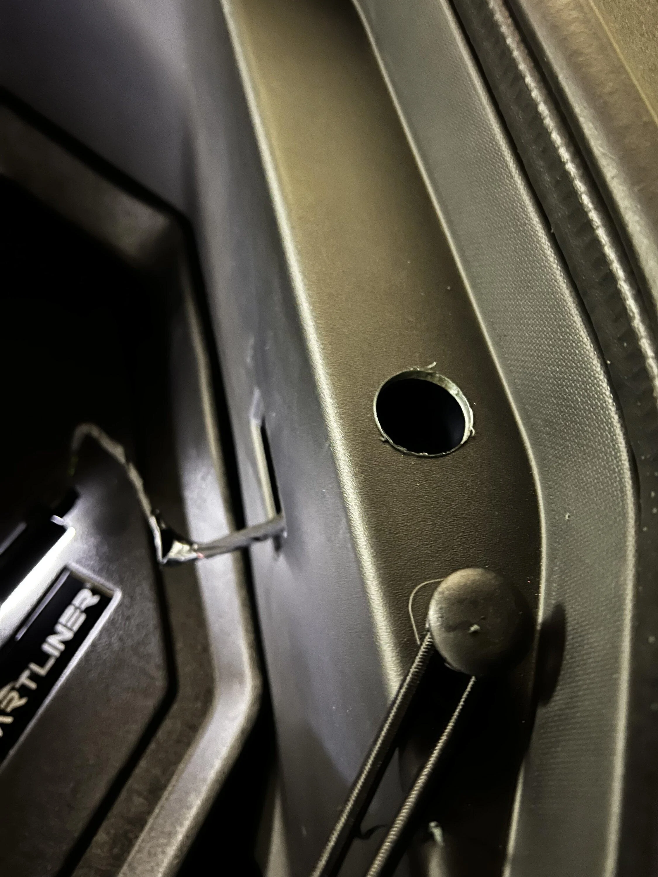

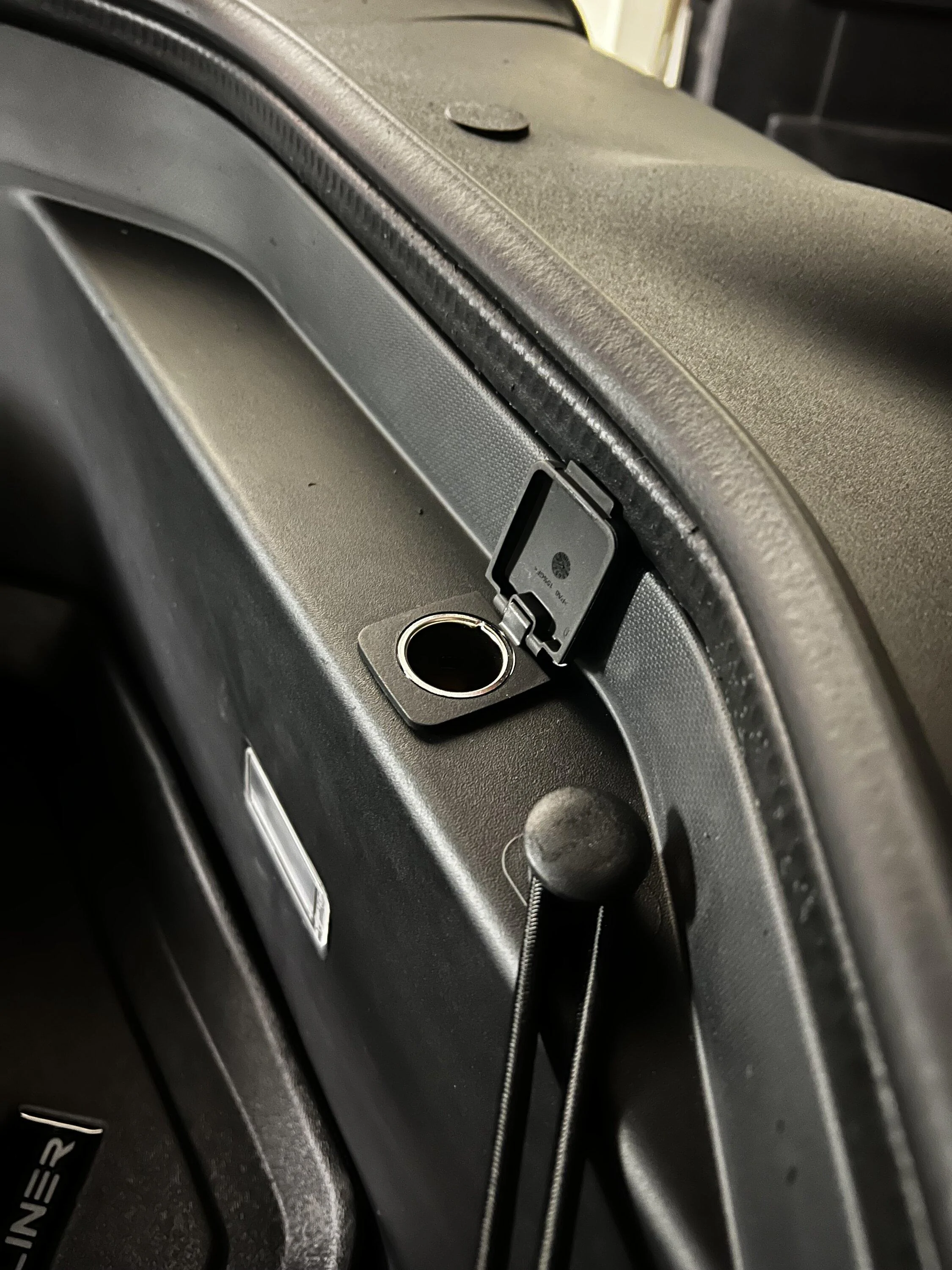

Rivian stopped putting the 12v outlet in the fronk, super stupid but I have heard rumors the wiring is there just have to put a hole and receptacle in. I tried to run a cooler in the fronk for a while, got too hot and I killed the cooler. Maybe that is why it went away, super bummer though.
I added a 12V socket in the frunk using the existing wiring.

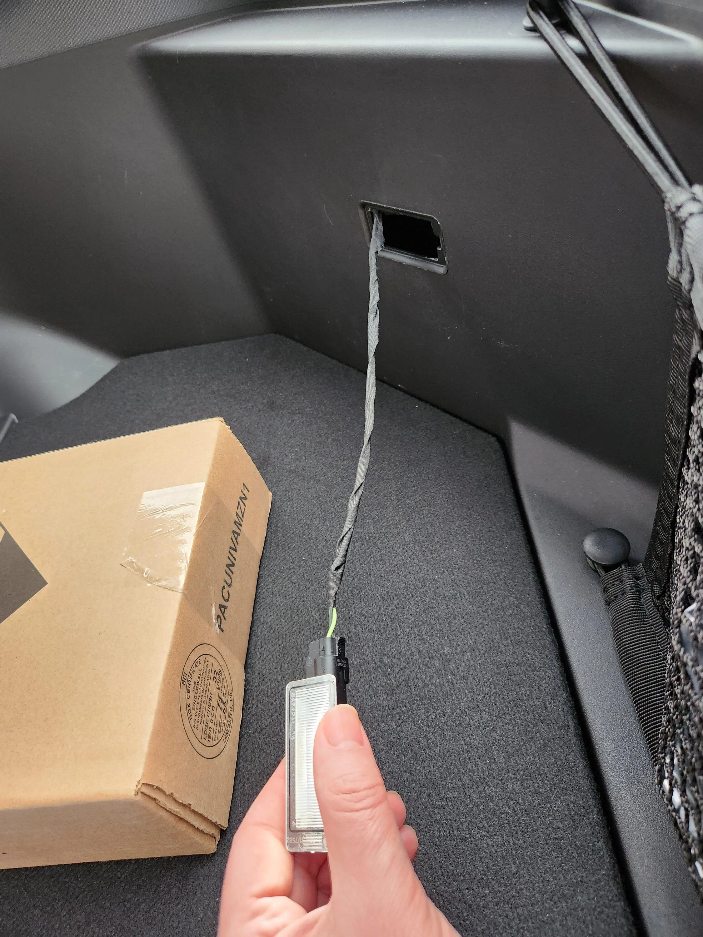

My truck (vin 137xx) no longer had the wires present behind the lamp for the deleted 12v socket. Don't know if they changed the harness or if mine was trimmed much farther back than others...
