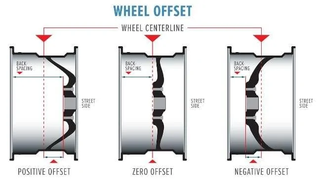

The offset really isn’t a function of the caliper it’s where the barrel is going to be centered in the wheel well. Too much offset and you may rub the inside on the suspension or steering at full articulation. Too little (or negative) offset and your steering center will not be in the right part of the contact patch or the outside edge of the tire may touch the fender. Spoke design will dictate if it clears the caliper (but that doesn’t exactly show up in the wheel specs). Someone will have to have to experiment a little to see what fits.
Ken
KenJ is spot on. It’s called the king pin angle and it is critical to handling performance not on dry and snowy conditions. You have to match the offset nearly exactly to get the force vectors going through the right spot of the contact patch, especially with Rivian’s unique suspension system (I know the image below is a two arm linkage where Rivian has a tweak on it both front and rear). And, yes, of course the spokes have to be shaped properly to not interfere with the caliper housing.

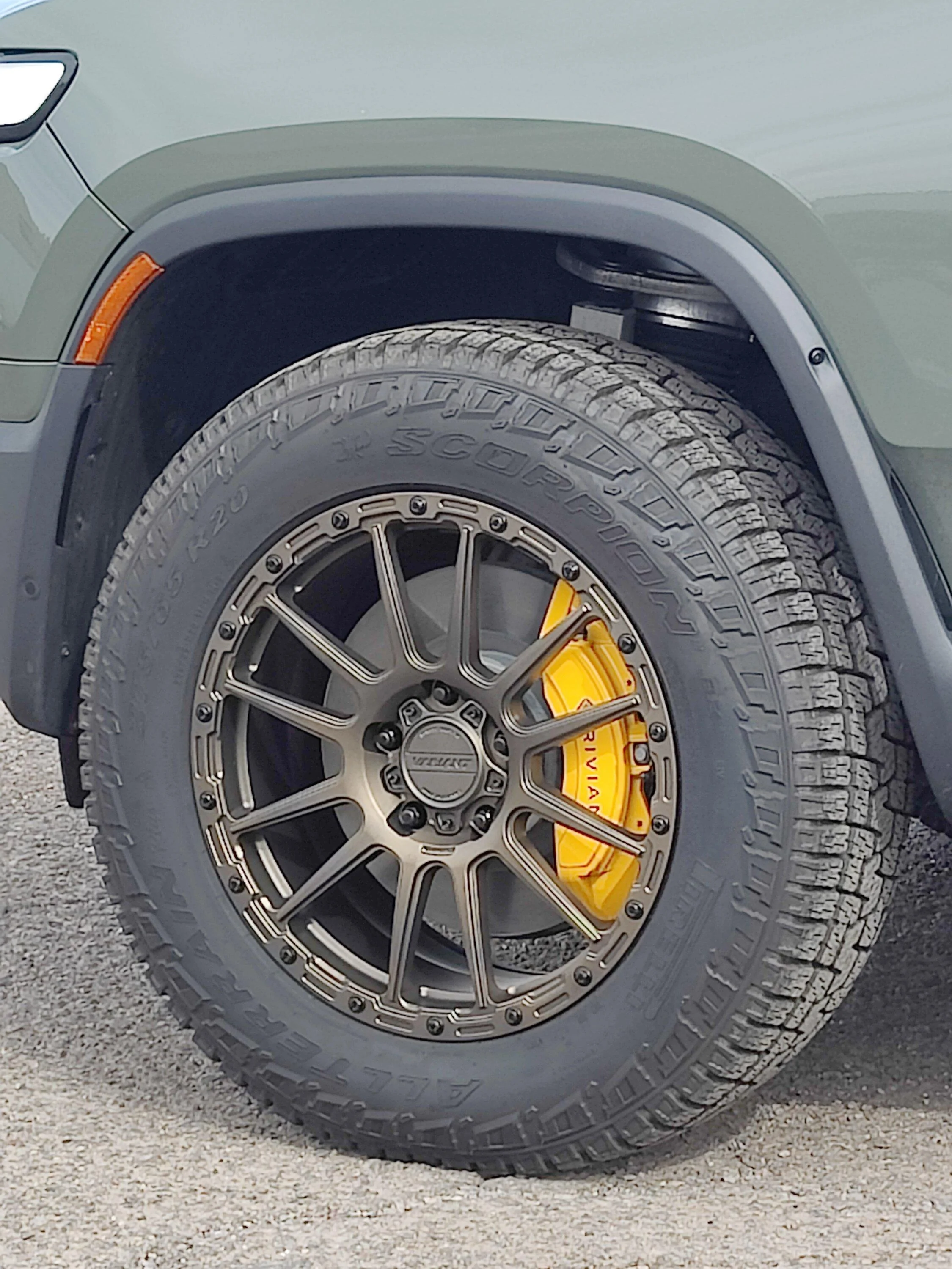

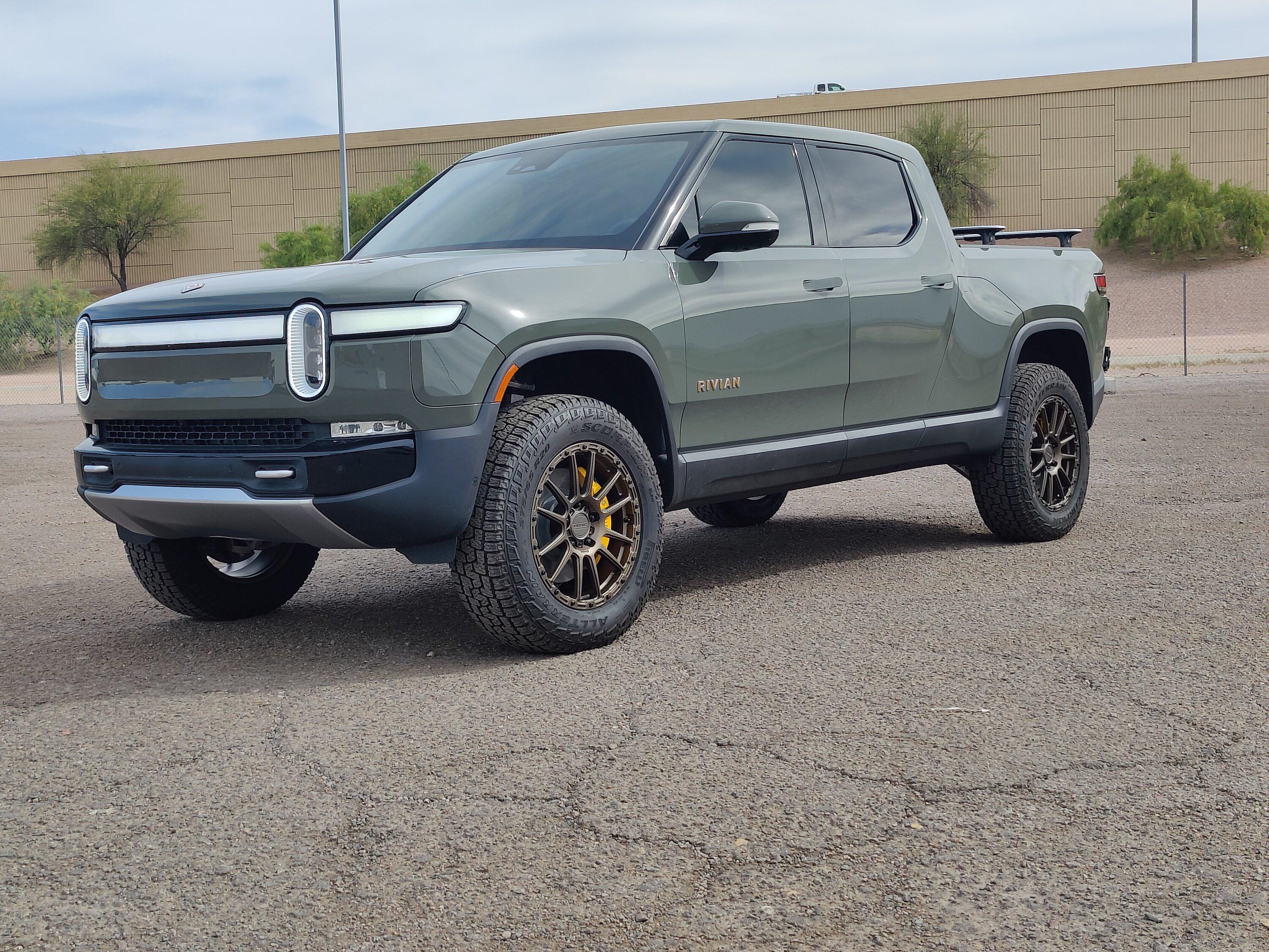

I did the fitment and worked with the design for these wheels and they are on my personal R1T today. Better fitment than OEM, weight is 12lbs total less and for 5,000 miles they've been amazing. Rivian does sell factory 20's for $1550 each....it's just difficult to find them.
Rivian R1T R1S Aftermarket Tires / Wheels? IMG20220603162142
Rivian R1T R1S Aftermarket Tires / Wheels? IMG20220603161813
