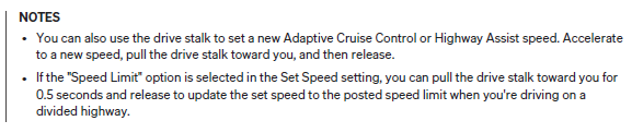

I asked ChatGPT to dig through R2 manual to find out if there is at least a shortcut. It suggested "Pull stalk toward you ~0.5 sec" but then hedged the answer saying there is a small documentation gap as to whether Rivian guarantees that exact gesture while UHF itself is currently active.
Do you know if it works or not?

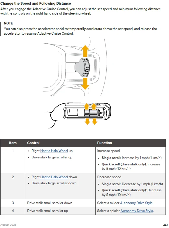

There's a dedicated scroll wheel on the right stalk just for adjusting speed. I don't find it too cumbersome now that I remember where it is. First few drives I would end up adjusting the HVAC fan speed...

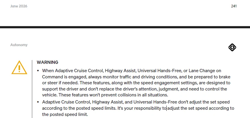

The most recent R2 Owner's Guide (August 2026) can be found here:
https://rivian.com/support/article/r2-owners-guide
Page 263:
Thanks, the AI found that also, but it concluded: " the shortcut is documented only on divided highways. On ordinary city roads where R2 Universal Hands-Free now works, Rivian does not document this speed-limit shortcut."
So I guess it's a testing time for me today to find out what works and what doesn't.
