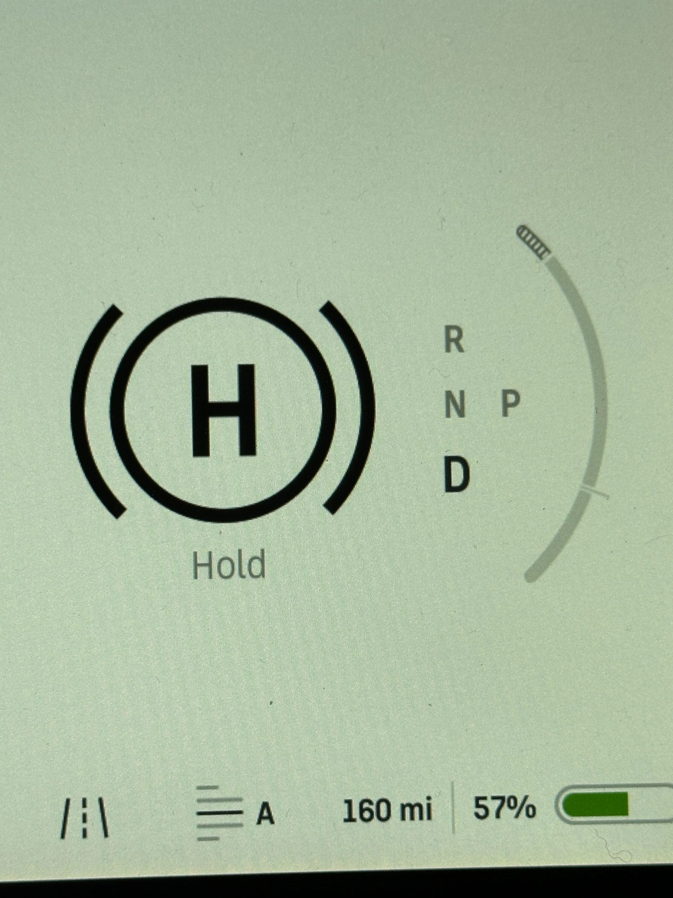

glad you figured it out. FYI on the gauge cluster, the power graph next to the Speedo will be slightly greyed out at the tip of the graph until the battery is warm enough to give you full performance. Next time you hop in when it’s cold take a look and see if you notice it.
here is what it looks like. The dashed part of the power meter indicates that full power isn’t available due to battery temp.

Deleted member 9190
Guest
Thanks for that. It is def greyed out with a cold battery. I also noticed that it greyed out when in conserve mode which makes sense ( even with battery at optimal temp).
and as far as only being relevant at the drag strip…accelerating into the freeway with a short approach is also a time when adequate acceleration is necessary.
