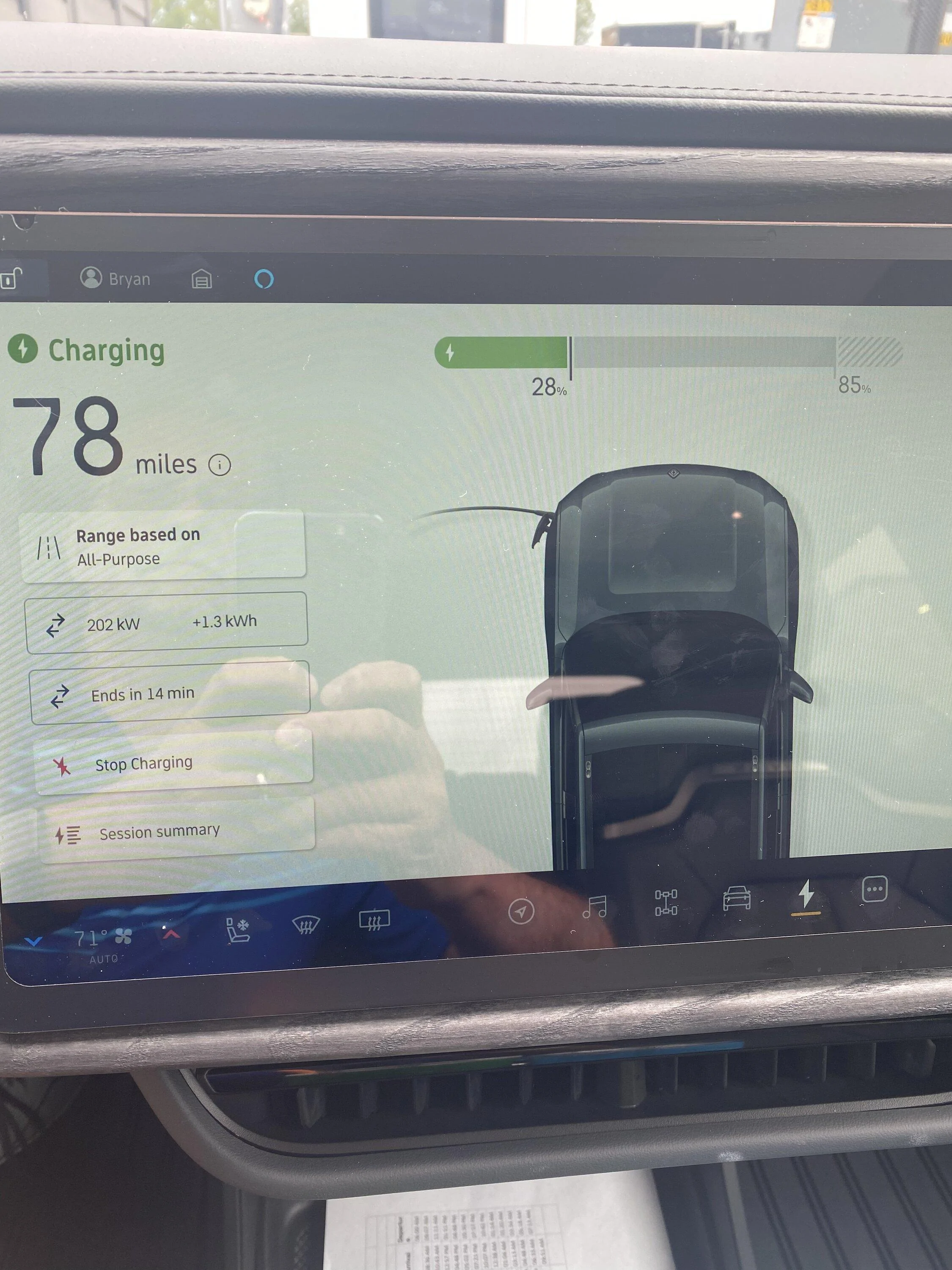

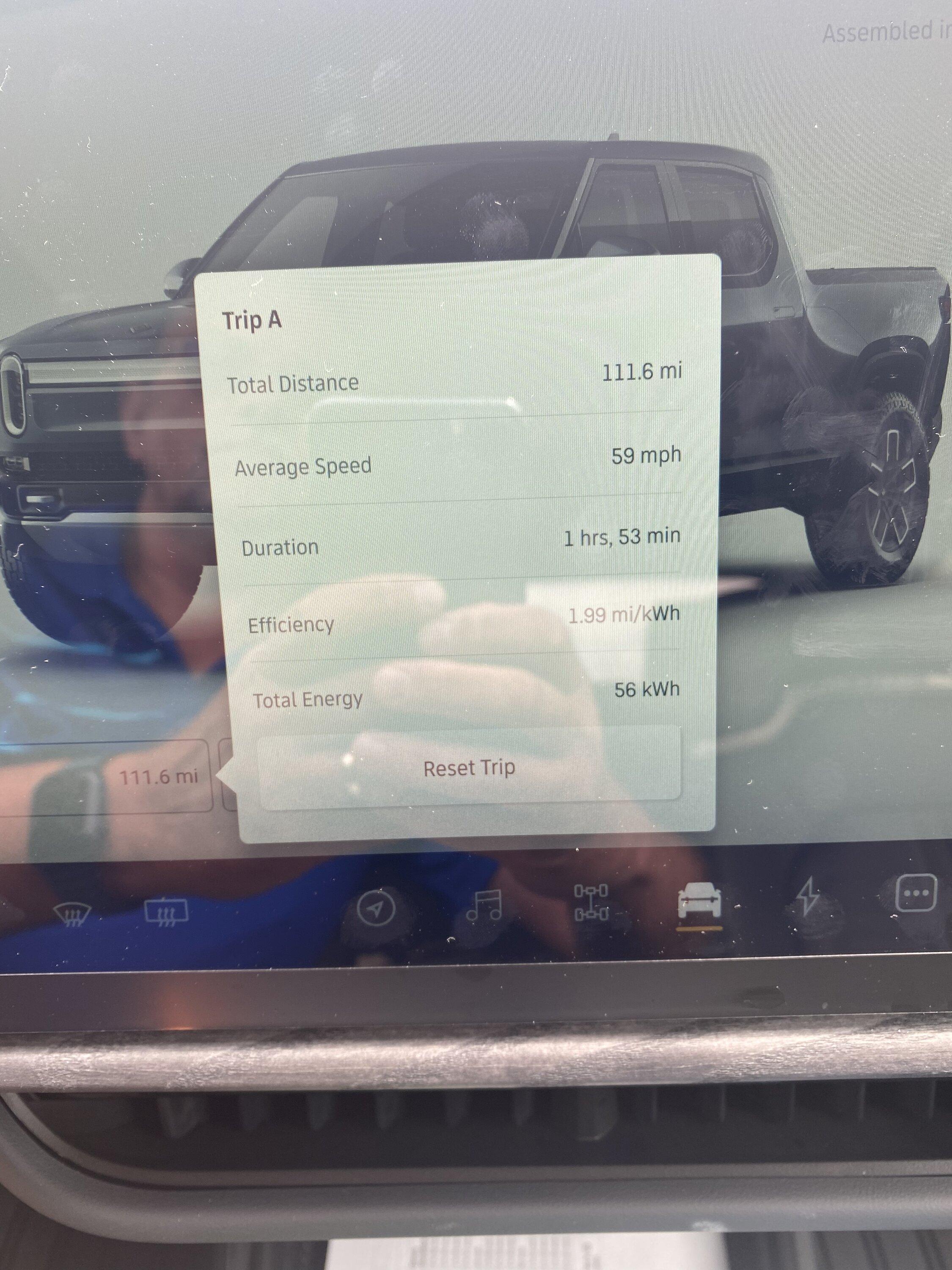

Started the road trip from central MI to Almont, CO. First charging stop is at the Electrify America charger in Portage, MI. Drove 150 miles at an efficiency of 2.03 mi/kWh.
All EA dispensers appear to be up and working at this station. Started out charging at 200 kw and maintained a good rate throughout.

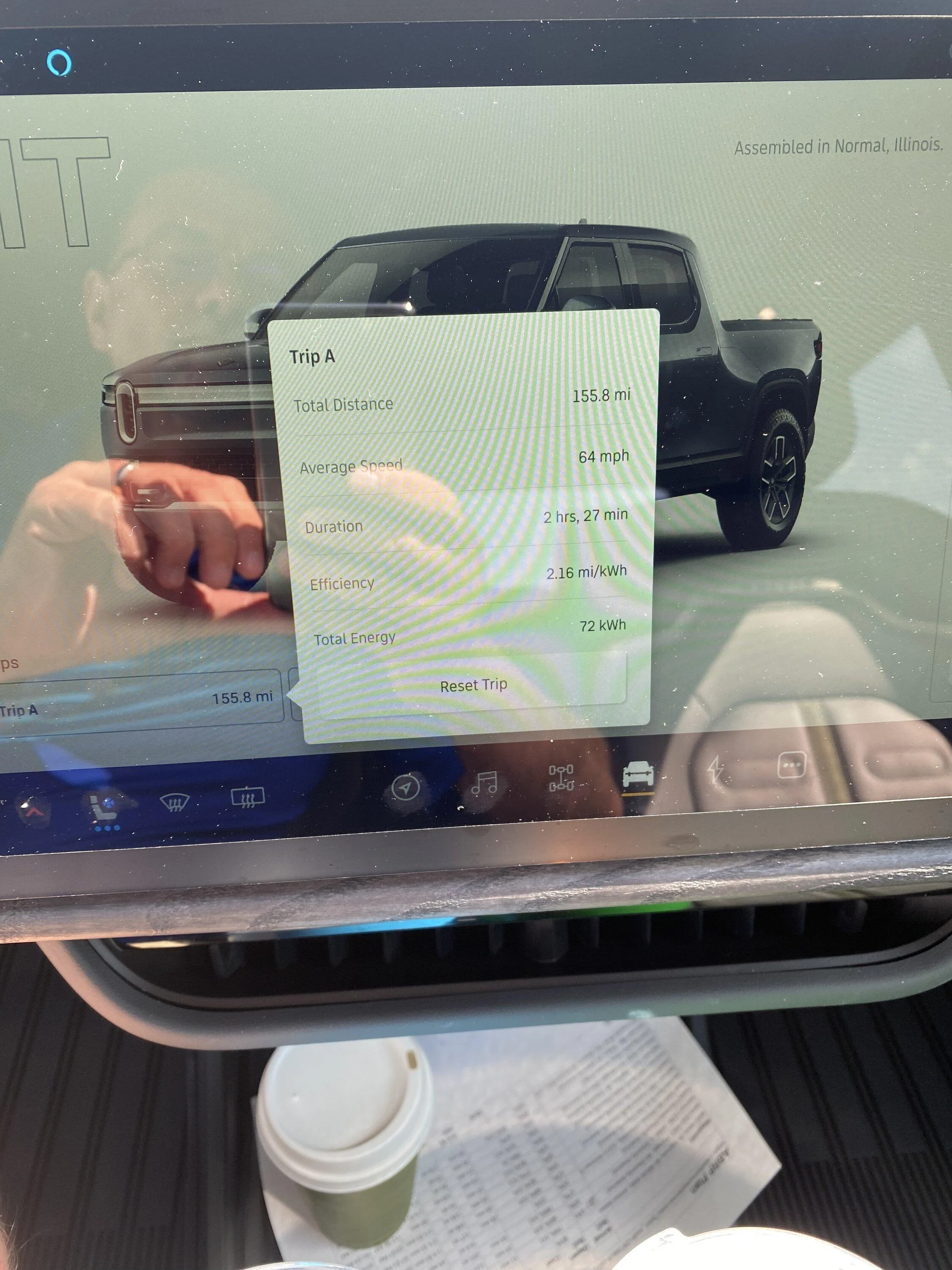

Second stop was at Electrify America, Joliet, IL. Surprisingly, all pedestals were working but one dispenser was flagged as not functional. When I arrived, only one open pedestal so I made a full house.
Had to hook up to a 150kw dispenser but pulled 150kw for quite a while before tapering.
Averaging 2.16 mi/kWh driving through the Chicagoland area.

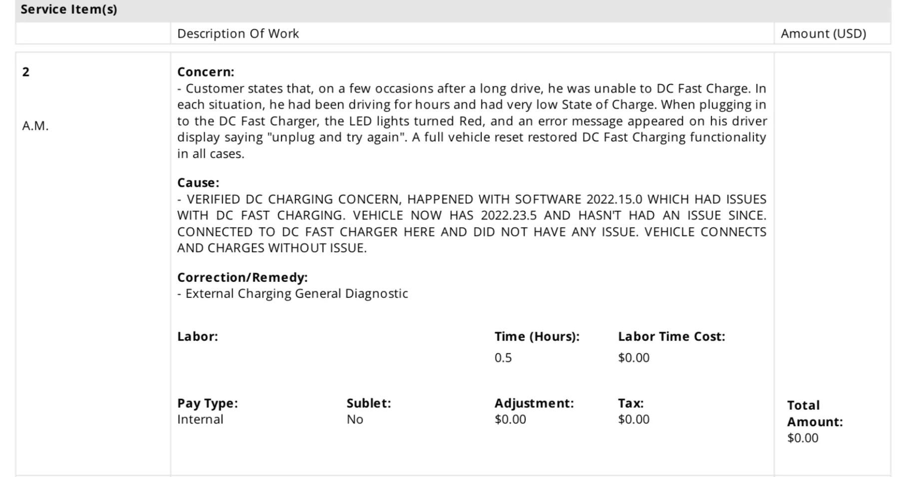

As soon as i see a "unplug and try again" error I hard reset (the 2 times the truck hasn't been able to connect to a charger I got that error). In fact, I'd hard reset before trying tech support for either the charger and/or Rivian.
So it has evolved some through the updates. Early on the “Unplug and Try again” error was always the truck and always fixed with a hard reset.
Recently I have been getting a mix, where that error is due to a bad station instead of an issue with the truck sometimes. So I will usually switch stations at least once (if possible) before going to a reset.
Also for what it’s worth this was on my latest work order, so they at least acknowledge that some bug was fixed in one of the software updates.
Interesting. I’m on software version 2022.27.2. But, we had been driving all day and were at a very low state of charge. Today will be another day of driving all day so will see if it happens again.
