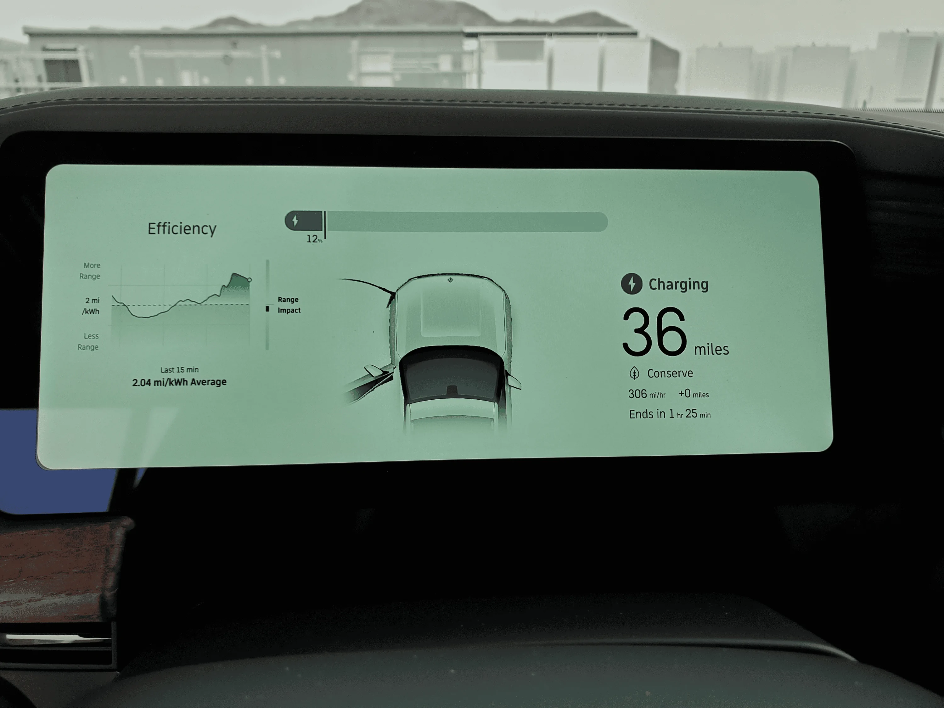

Screen when arriving in Baker the first time. (started off at 91% charge).

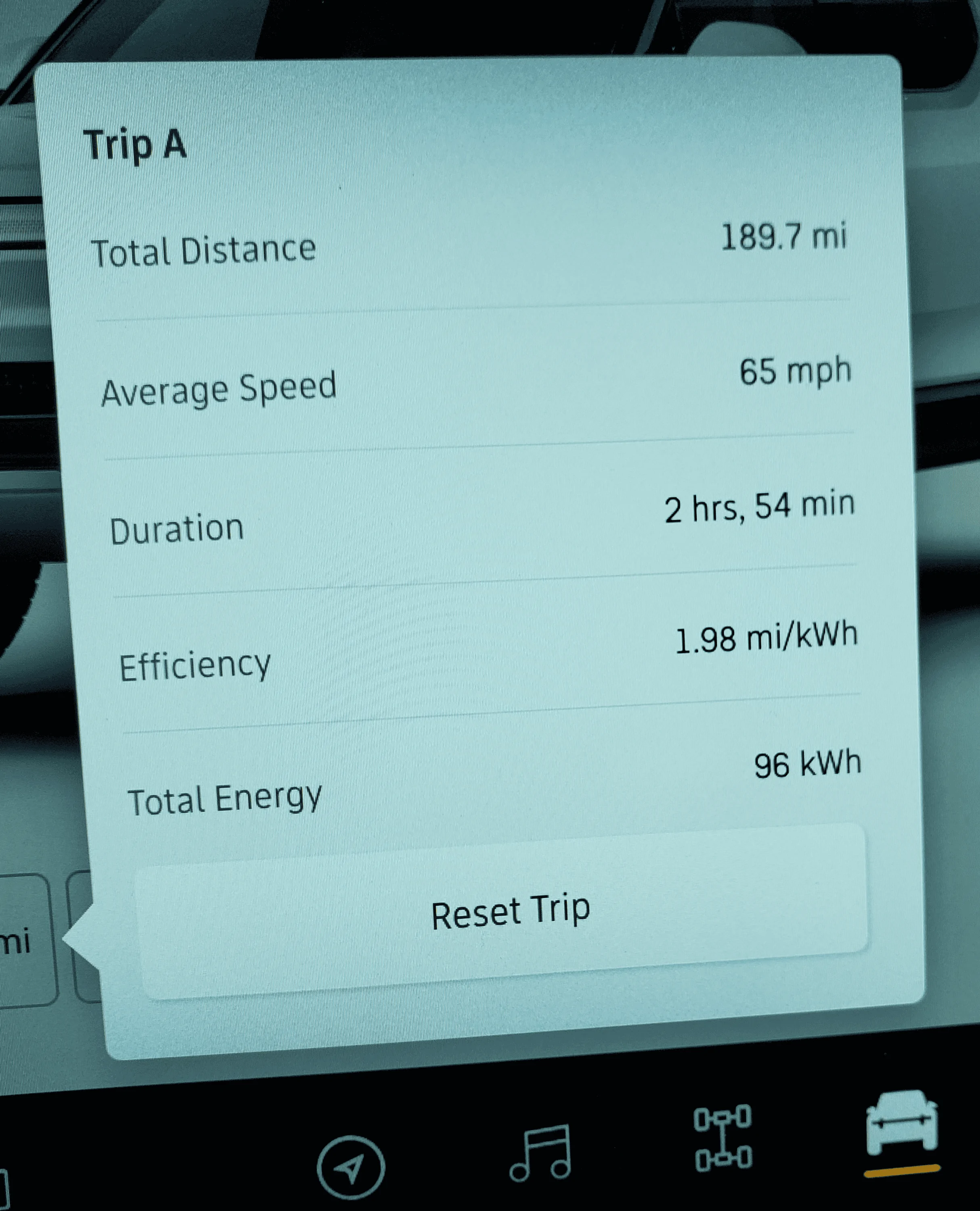

I kept resetting the trip meter at each charging stop to see what the miles per wh figure was for each leg. But, Baker being 192 miles from my house. Plus the 200 miles I drove from Baker to Vegas back to Baker again, then back home, total mileage (not sure why it's relevant?), was 192 twice (384 miles) plus 200+/- a couple of miles. So total trip about 584 miles.

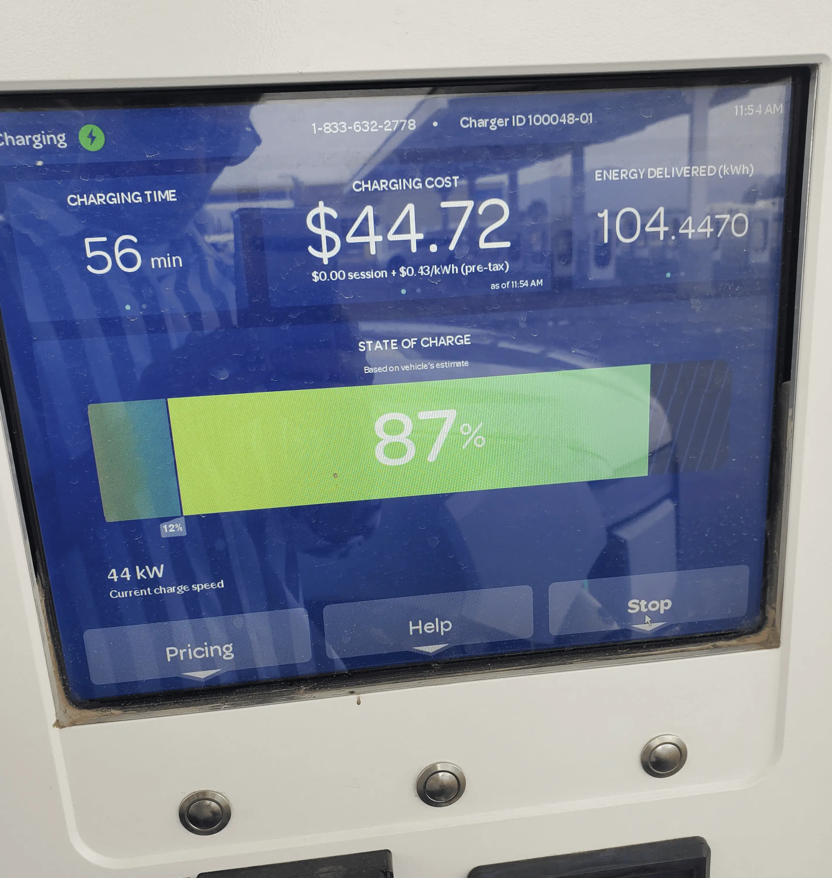

Photo just before unplugging after first stop in Baker showing it still taking in 44kw, while at 87% state of charge.

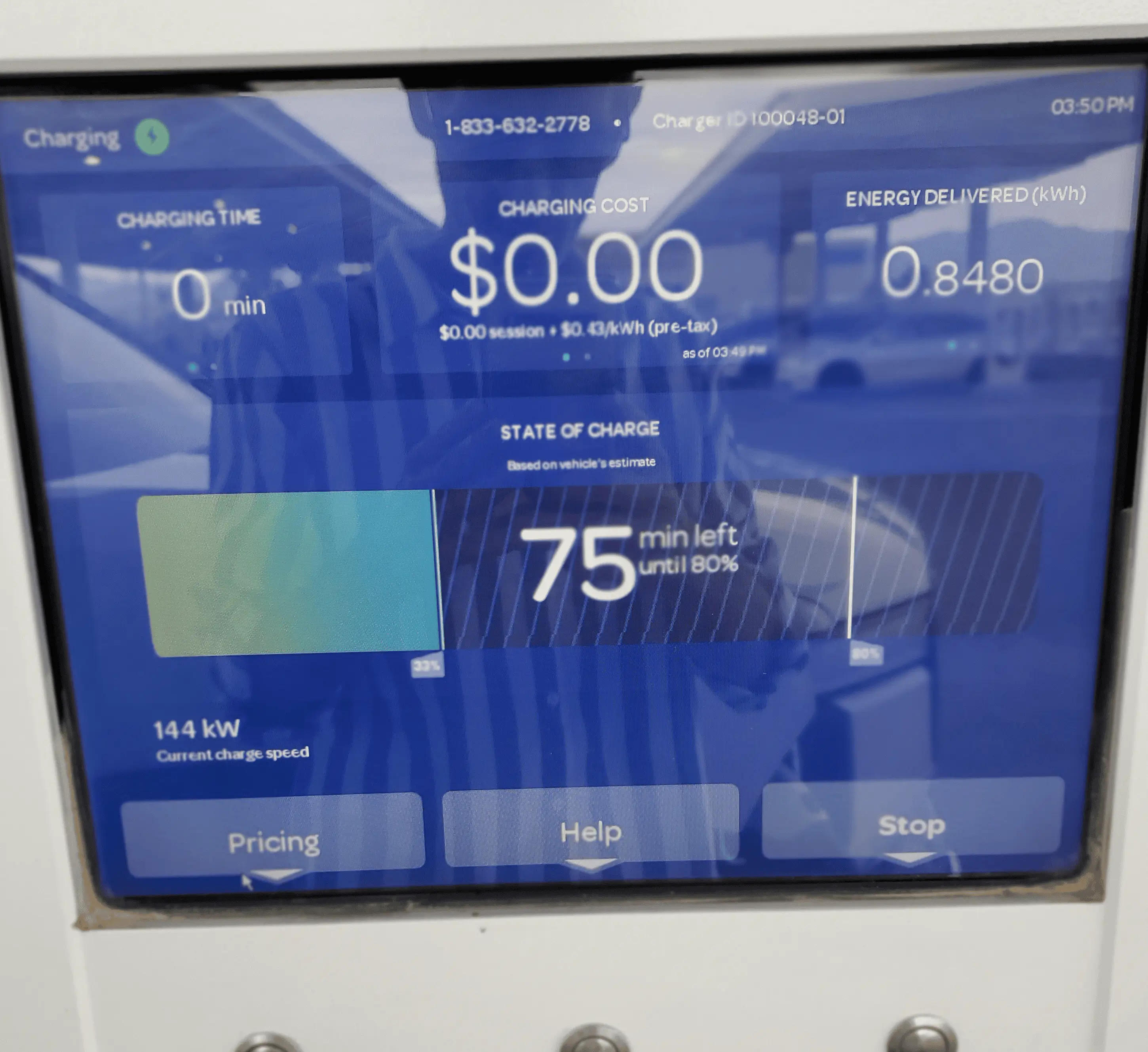

This was the second stop in Baker on the way back and was at 144kw. But I took this photo as soon as I plugged in. It ramped up a little more from there.
