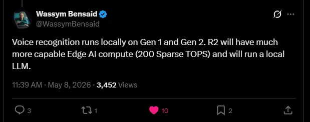

This was posted by Wassym regarding voice recognition local processing.
“Local LLM” does not mean much beyond marketing unless the implementation details are clear.
“200 sparse TOPS” raises more questions than it answers. At what precision? BF16, INT8, INT4? What sparsity format? Does the runtime actually use it? Most normal LLMs are dense, and I am not talking about MoE versus dense model architecture. I mean whether the model weights and kernels can actually exploit hardware sparse acceleration.
Memory capacity and bandwidth are likely the real limiting factors. I could see a 3B to 4B model running well on an updated infotainment system, and maybe a 7B to 8B model if the memory system is fast enough.
But even that is secondary. The useful question is what they intend to do with it. The harness, modality, latency target, tool access, context strategy, and product integration matter more than the TOPS number.
INT8.

where did you find that? I’ve only seen some stuff for RAP1 - not the updated infotainment system.
Because there isn't any mention of the new infotainment. The 200 tops was per RAP1.
I think you’re conflating two separate Rivian claims.
Rivian’s R2 media material places the 200 sparse TOPS figure under the R2 infotainment compute module. RAP1 is described separately as part of the Gen 3 Autonomy Computer, which Rivian rates at 1600 sparse INT8 TOPS (using a pair of RAP1 modules).
200 sparse TOPS under typical 2:4 sparsity, is roughly 100 dense TOPS. That puts it closer to modern high-end smartphone SoC territory than an autonomy-class accelerator.
That is still good hardware for an infotainment system. I just think Rivian’s AI marketing would be clearer (and of course they know this too, and are clearly intentionally being ambiguous) if they stated the dense-equivalent performance, precision, memory, etc. Considering the last information SOC was mediatek (if I recall correctly) then this could simply be that they moved from that, the CV5 and another pair of supporting SOCs (WiFi and GPS?) to something like https://www.mediatek.com/products/smartphones/mediatek-dimensity-9500 and are just going full AI,AI,AI,AI on how they describe this.
