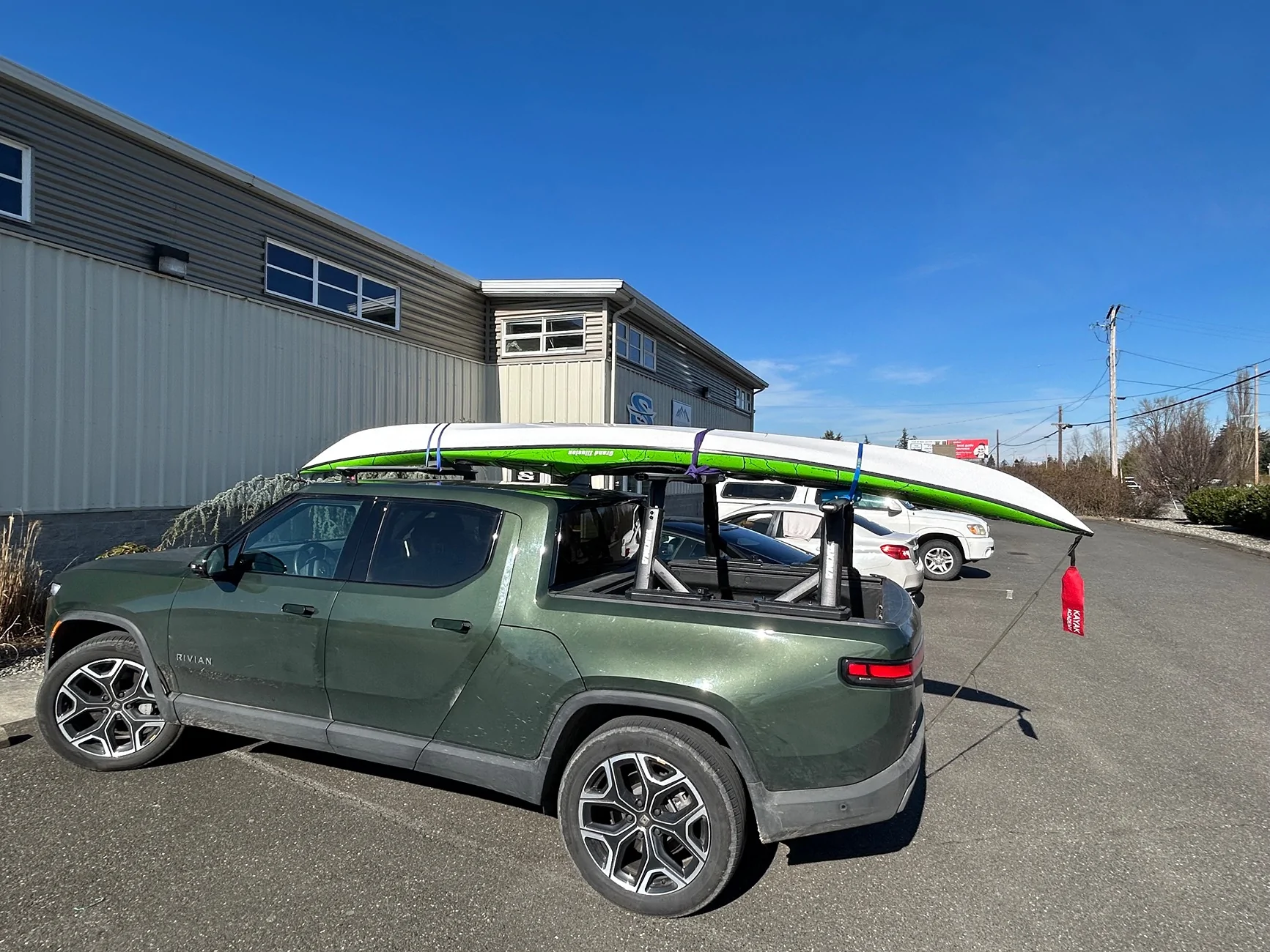

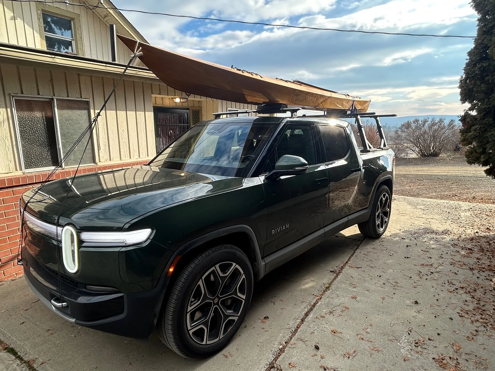

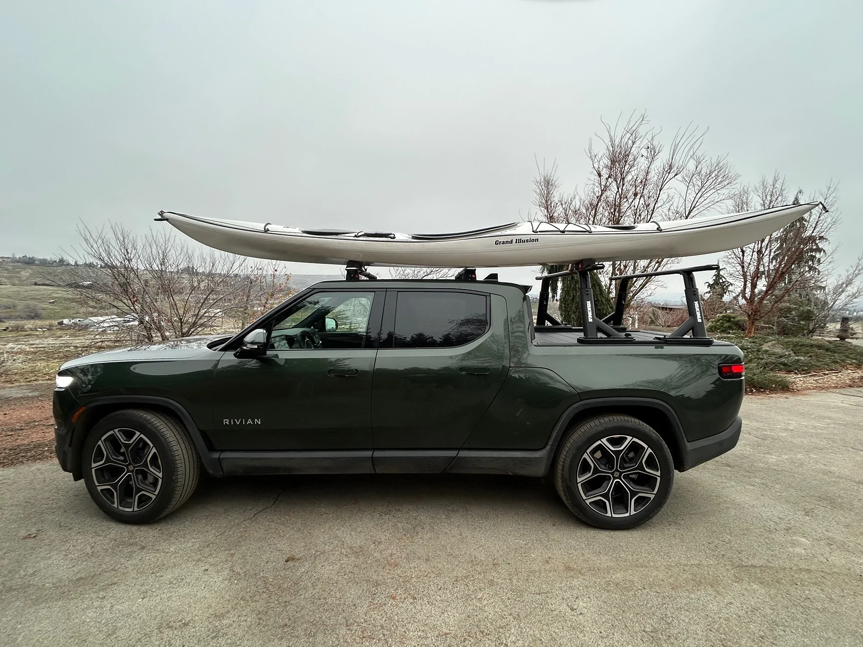

We have gone through a steady evolution of small modifications to create a truly solid base for hauling longer sea kayaks (and other large equipment) on our R1T. depending on the situation, we can likely carry three and potentially four 18-foot sea kayaks on this rack.
Rivian R1T R1S Fine Tuning a Sturdy Sea Kayak Rack for R1T IMG_1650
Rivian R1T R1S Fine Tuning a Sturdy Sea Kayak Rack for R1T IMG_1592
Rivian R1T R1S Fine Tuning a Sturdy Sea Kayak Rack for R1T 1769815943866-d4

Always nice to see sea kayaks on Rivians! What is your loading strategy? I use Yakima Showdowns on my R1S but that means I can only have 2 boats up there. The ability to load from the side and at waist height makes up for it but would love something else that was as easy to load but allowed for more boats.

I see a Sterling!

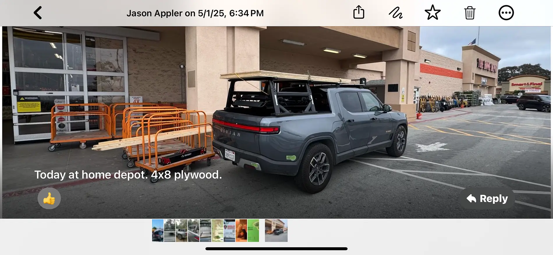

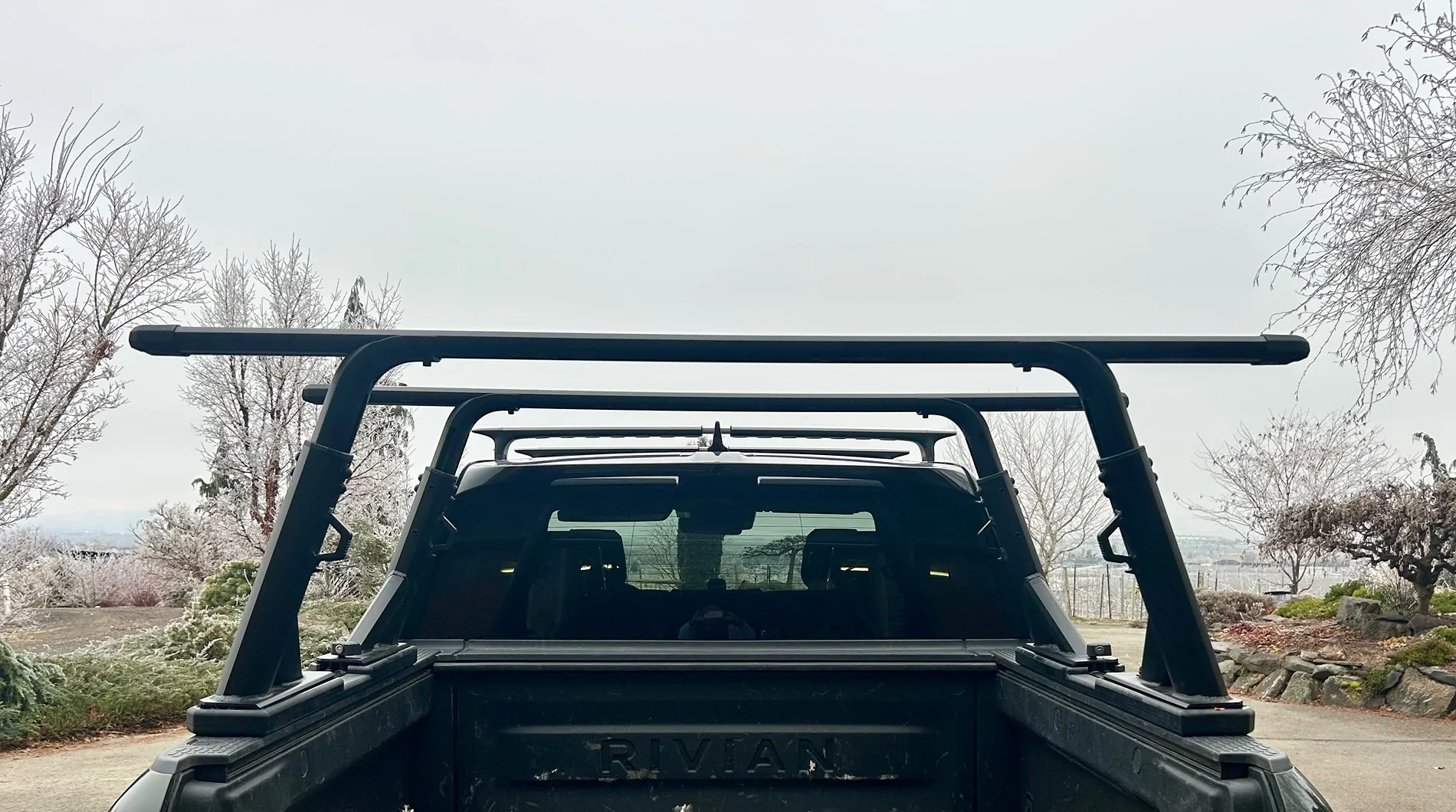

I need a set of tall towers for the rear of my R1T for carrying long lumber. Need the rear racks to be same height as racks on the cab. I can not find those racks on the yakima site. How did you modify to fit the rear rails?

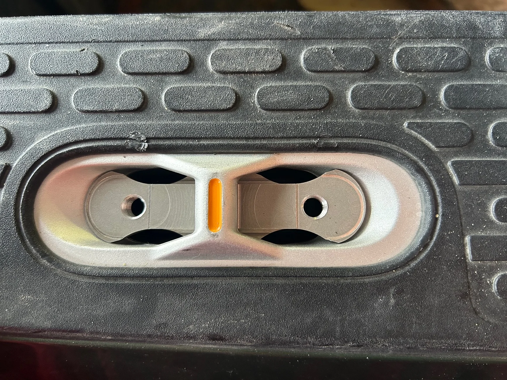

This is my friend’s set up, who actually designed and engineered the clips needed to utilize the Rivian attachment points around the truck bed.
Rivian R1T R1S Fine Tuning a Sturdy Sea Kayak Rack for R1T IMG_6185

You are telling me you are an affluent ‘elitist’ with that comment! Haha! One of my kayaking buddies is picking up his new Sterling Grand Illusion in a couple weeks in Bellingham. I have to be sure that my rack can handle that trip AND future adventures with two overly expensive Sterling boats on top before we head out on any trips. Hence the very beefy design!
Yakima HD Overhaul rack supports. Bars sold separately!!! $$$$
we used these engineered clips that my friend designed

First 200+ mile haul with a new Sterling Sea Kayak!
Rivian R1T R1S Fine Tuning a Sturdy Sea Kayak Rack for R1T IMG_2323
clips for sale? i'm in the market

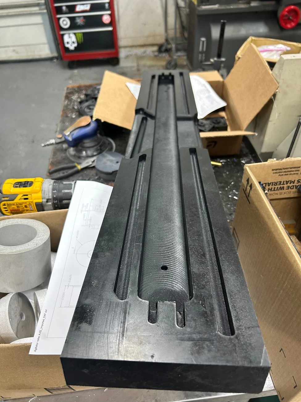

So far we’ve only produced two sets. The guy who designed it has it on his truck down in California. He loaned me the 3-D plans which I had manufactured by a small company in Yakima, WA. We really need to establish a decent number of orders to justify the cost of producing them in large numbers. If you don’t mind forwarding your information to me I can get you on our list of a dozen people or so who are interested. Tom
