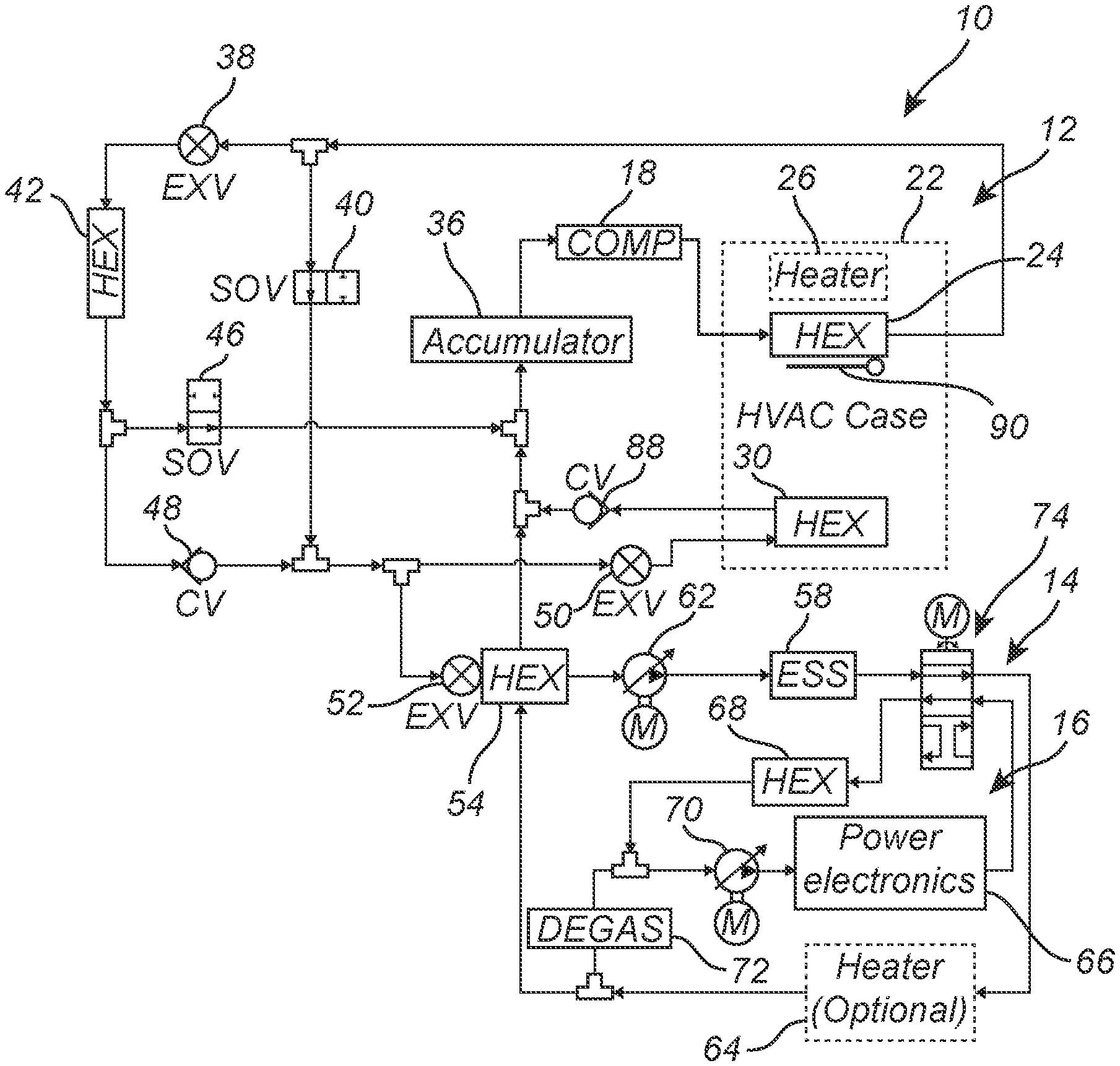

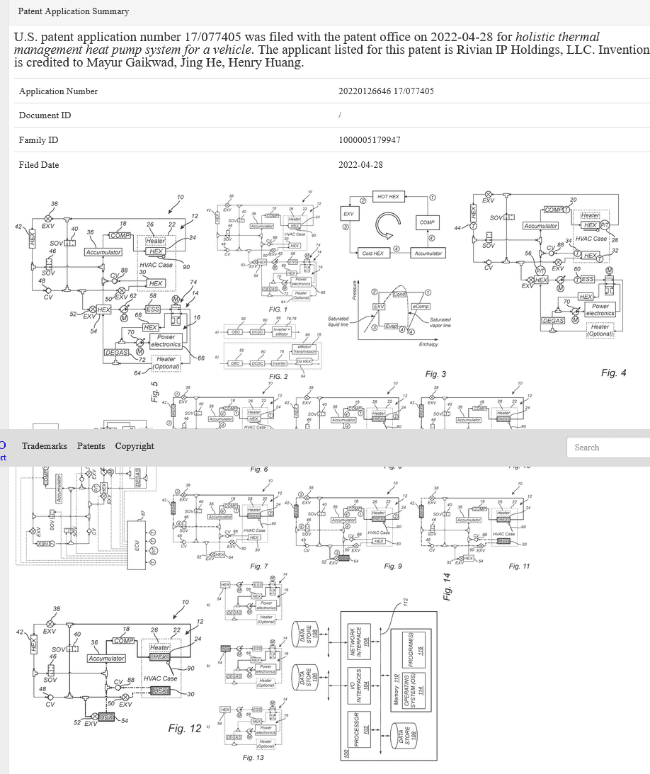

I wonder if it can be retrofitted onto existing vehicles. Wishful thinking, I'm sure.
Extemely unlkely. There's a lot going on here with 5 heat exchangers and 3 expansion valves. All of the components in a system like this have to be "matched" properly to work, and are designed as a complete system. For example, it would be a small miracle if the existing heat exchanger in the battery pack met the requirements.
Rivian's business model is building new vehicles, not retrofitting old vehicles. Think of it this way - does GM or Ford offer a factory retrofit/upgrade for a new engine design for a two year old vehicle?
And remember that a patent is not an actual product. Just because this patent was released doesn't mean it's going be part of the R1 platform s00n...

1. Extract heat from the outside air in cold weather to warm the battery and cabin, when the vehicle is cold.
2. Extract heat from the battery and motors, use it to heat the cabin in cold weather when the vehicle is warm.
3. Extract heat from the battery, motors and cabin (air conditioning), release it to the outside air when cooling is needed.
