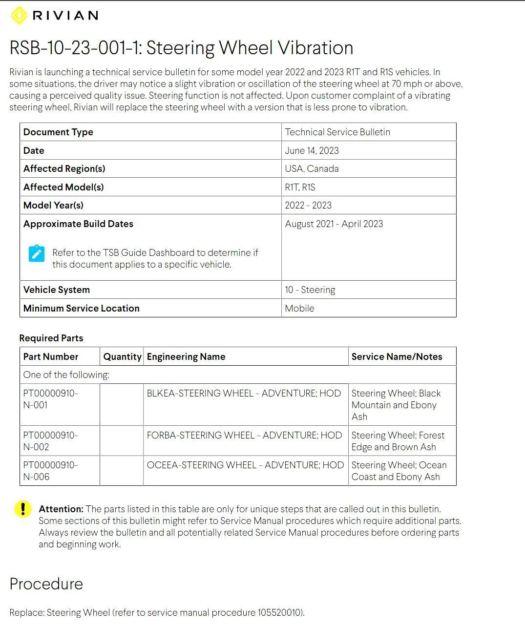

I don't think I have seen an official post on this specific campaign. I can confirm replacing the steering wheel back in 2023 and getting road force balanced couple times got rid of all my shaking between 60 mph - 80 mph on all terrain wheels.
Make sure the stitching and finishing on the new steering wheel meets your standards. I have seen some wheels where the stitching could've been better.
RSB-10-23-001-1: Steering Wheel Vibration Rivian is launching a technical service bulletin for some model year 2022 and 2023 R1T and R1S vehicles. In some situations, the driver may notice a slight vibration or oscillation of the steering wheel at 70 mph or above, causing a perceived quality issue. Steering function is not affected. Upon customer complaint of a vibrating steering wheel, Rivian will replace the steering wheel with a version that is less prone to vibration.
https://static.nhtsa.gov/odi/tsbs/2023/MC-10238719-0001.pdf

Rivian R1T R1S TSB -- RSB-10-23-001-1: Steering Wheel Vibration for model year 2022 - 2023. The driver may notice a slight vibration of the steering wheel 1751119293813-ft

Rivian has been replacing the steering wheel with a heavier one for quite some time now. That’s probably the fix, for those who still have the lightweight one

Took it in a couple times for this vibration. On the first go they road-force balanced the tires, and it helped, but it never went away and seemed to get worse again. On the second go they finally installed the heavier/weighted steering wheel. That cured most of the vibration, though it's somewhat back again since I rotated the tires. The 20" AT Pirellis though have something like 27k miles so I'll probably just deal with it until we get around to replacing them.
A funny byproduct of the heavier steering wheel is that the steering itself is now heavier -- or it's at least noticeable when cranking the wheel at low speeds (e.g. parking). Never considered that aspect.
