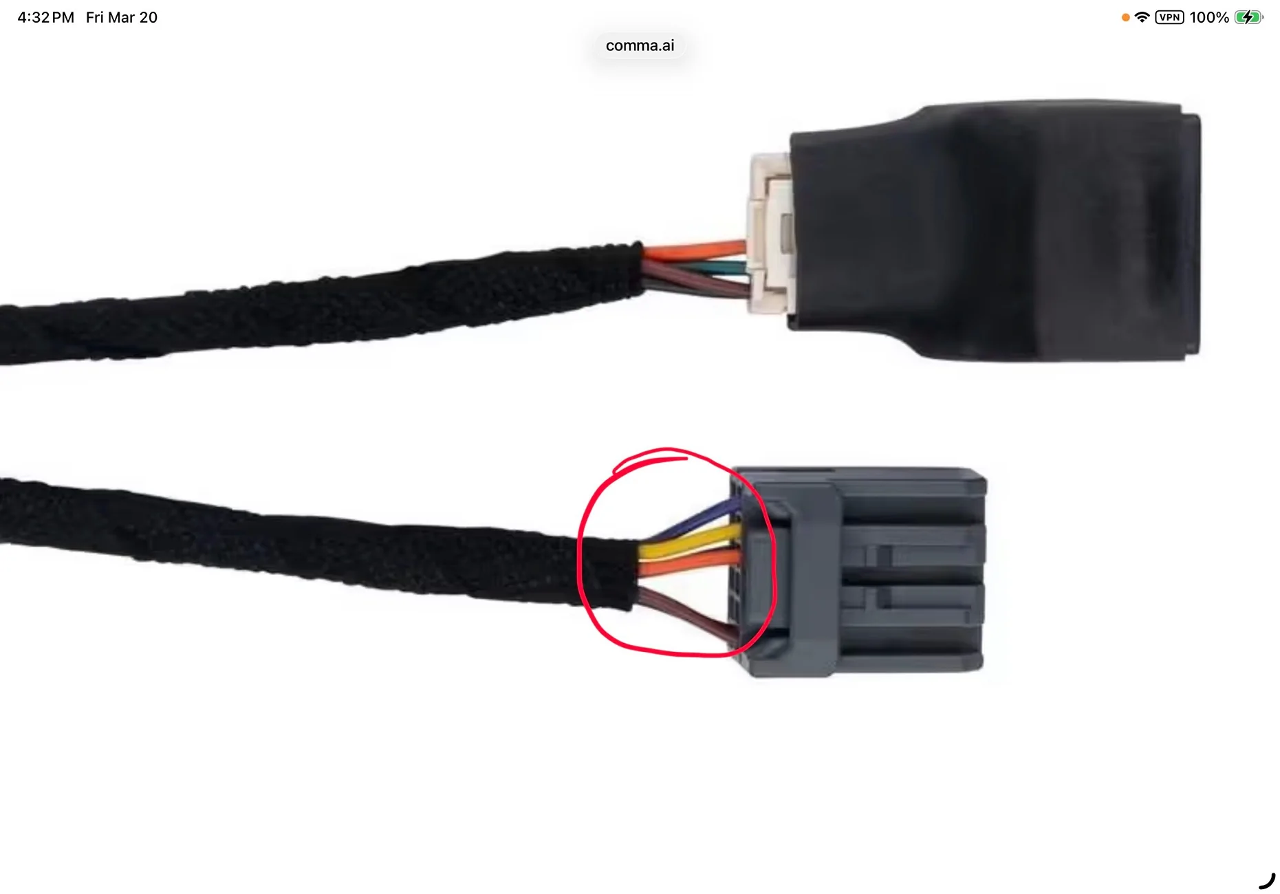

Thanks every one. documentation and videos are very helpful. after watching a few I am worried about my fingers not fitting into tight spaces :confused:, its a real problem. Wonder if anyone who already installed locally can help
While I don’t have huge hands, I do wear size L gloves, and I was able to get the job done. There are tricks that help with access. In my case, I was able to get the harness connector inserted into the AXM, without actually getting my hand all the way back in there. In a previous post, I documented my experience and the one thing I did that made the job waaaay easier, for me, at least. Not sure this will be the solution for everybody, as it may depend on the harness wiring that one has. In the attached photo, you can see that the black wires sheathing snugs up pretty close to the connector. This restricts the amount of bend one can get. Cut back that black sheathing a bit and it will work a whole lot better. See link below for my previous post. ✌
